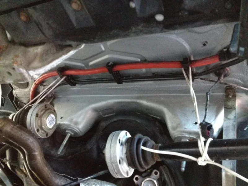

Diff and axle carrier out
Diff separated and new LSD unit
So you use all the original gears and just bolt it back in. You have to check backlash with a DTI nad gear mesh with engineers blue. Mine bolted back in and was perfect first time. There are no shims and as far as i can tell no way of adjusting it. But it needs to be checked. Mine was better and well withing BMW limits. The second time...... I was sent the wrong diff first of all and it just did not work. As you can see there is something wrong. The hight of the flange the gear sits on is too high by about 12mm

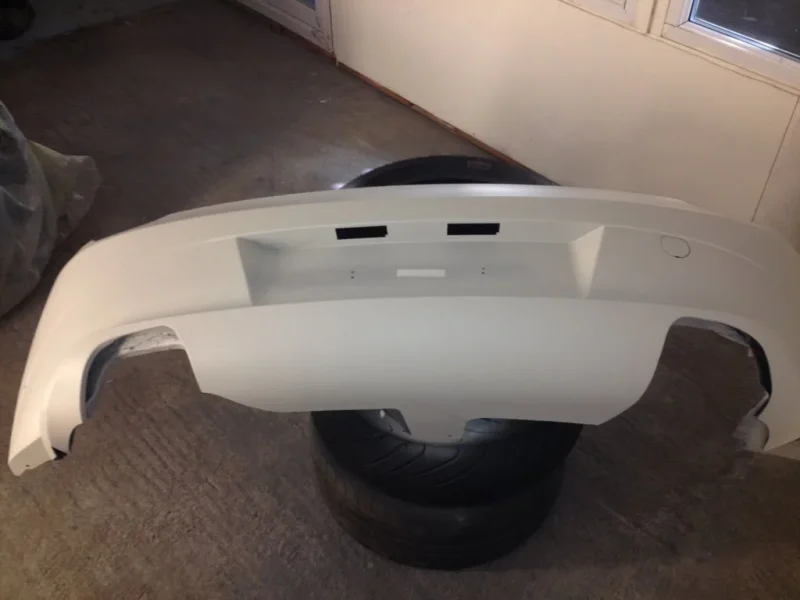

Also made a spoiler well remade it to fit better.
