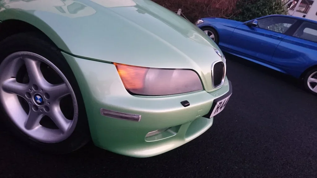

I've attached a pic from back when we got the car to show how the bumper and headlight alignment was off.... both now sorted.
