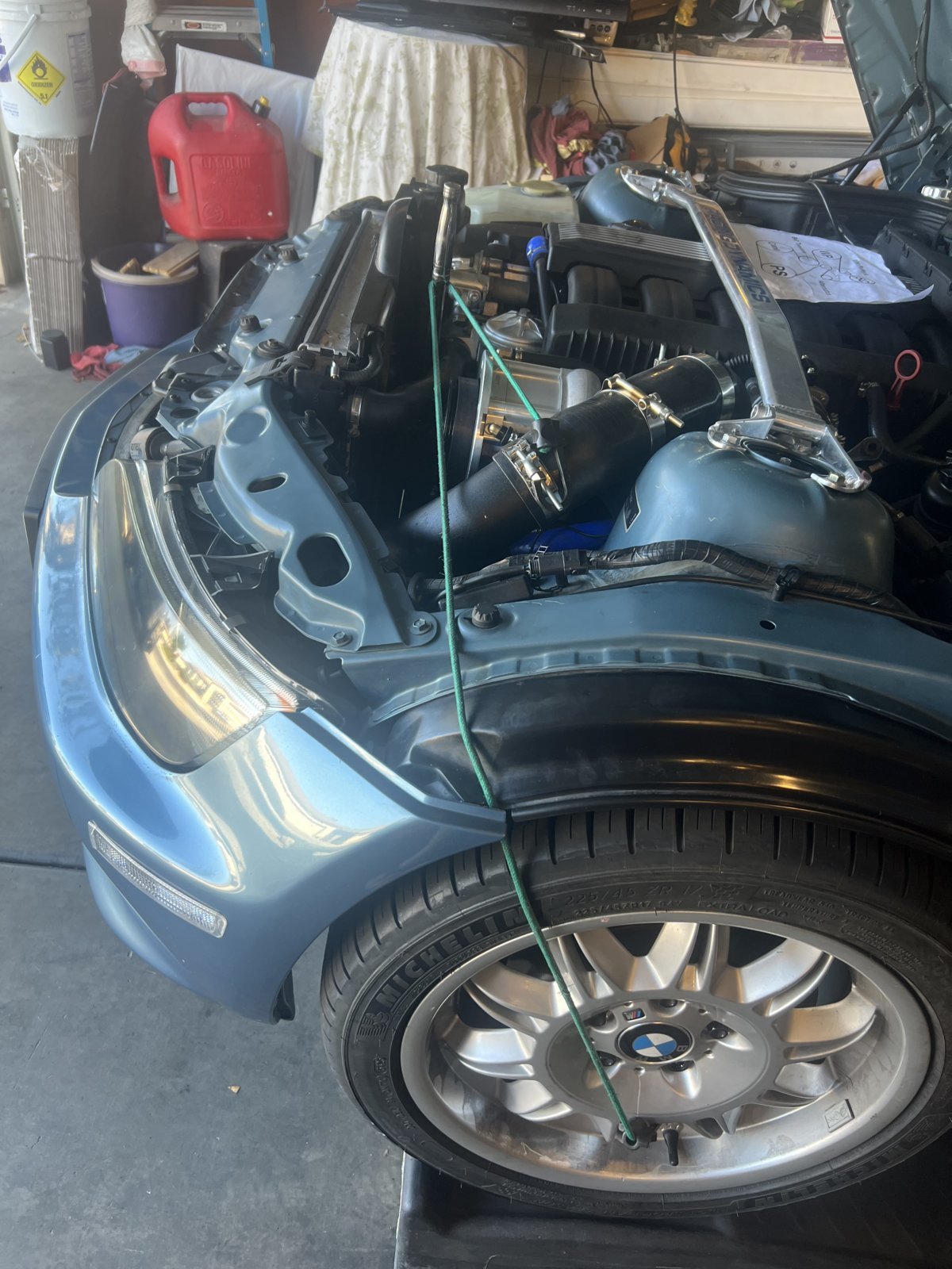

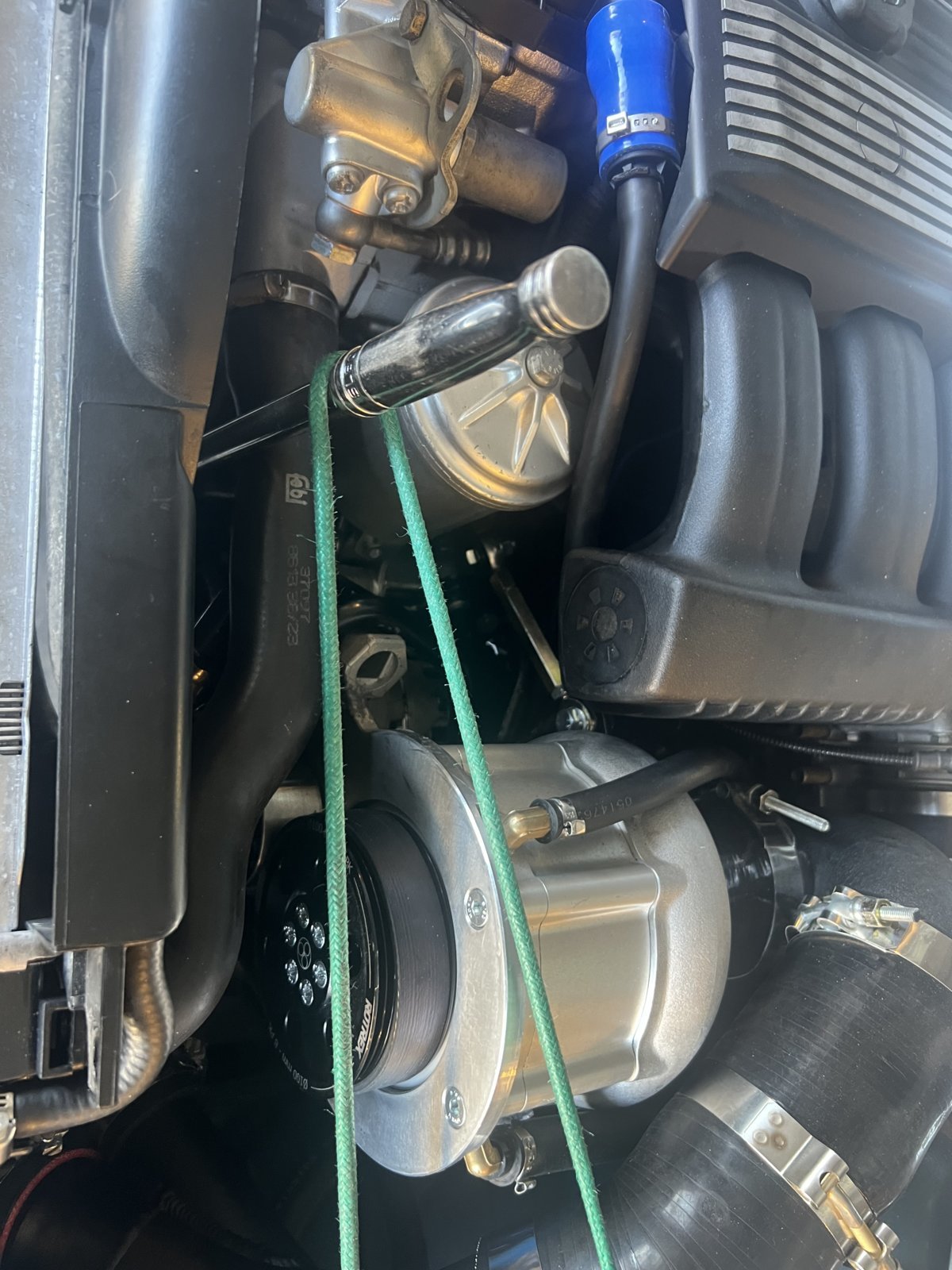

So, thanks to the difference in the S54 oil cooler housing & M52, the power steering pump mount is different & the alignment is off so the belts don't run properly.
I ordered an S54 power steering pump lol

Soooo the S54 hose is totally different & cannot fit. I called a hose repair place 32 miles away, they insisted they can swap the banjo the S54 pump needs to my hose, I drove there & (A) the woman at the counter acted like I was making up the call, the guy I spoke to came out and said oh sorry no.
WTF????
I went the the hole in the wall shop I found for the Sequoia & they did it in an hour, getting it in is an adventure, I'll start over tomorrow.
