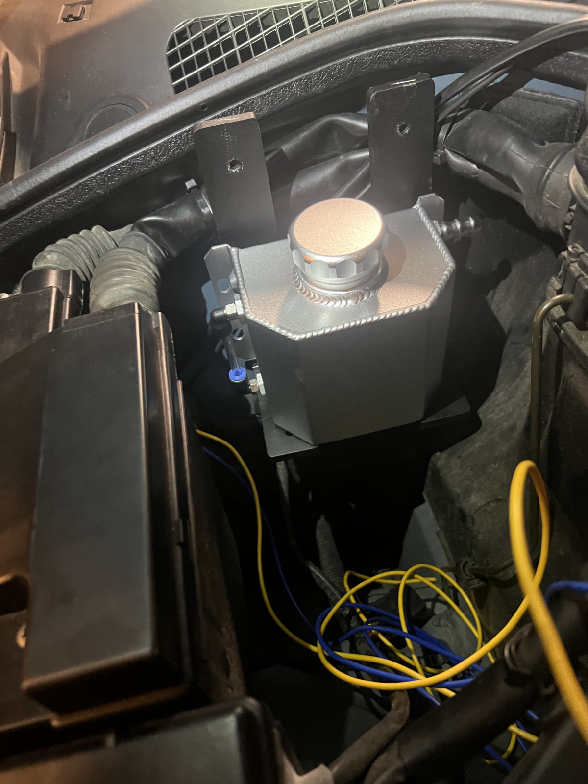

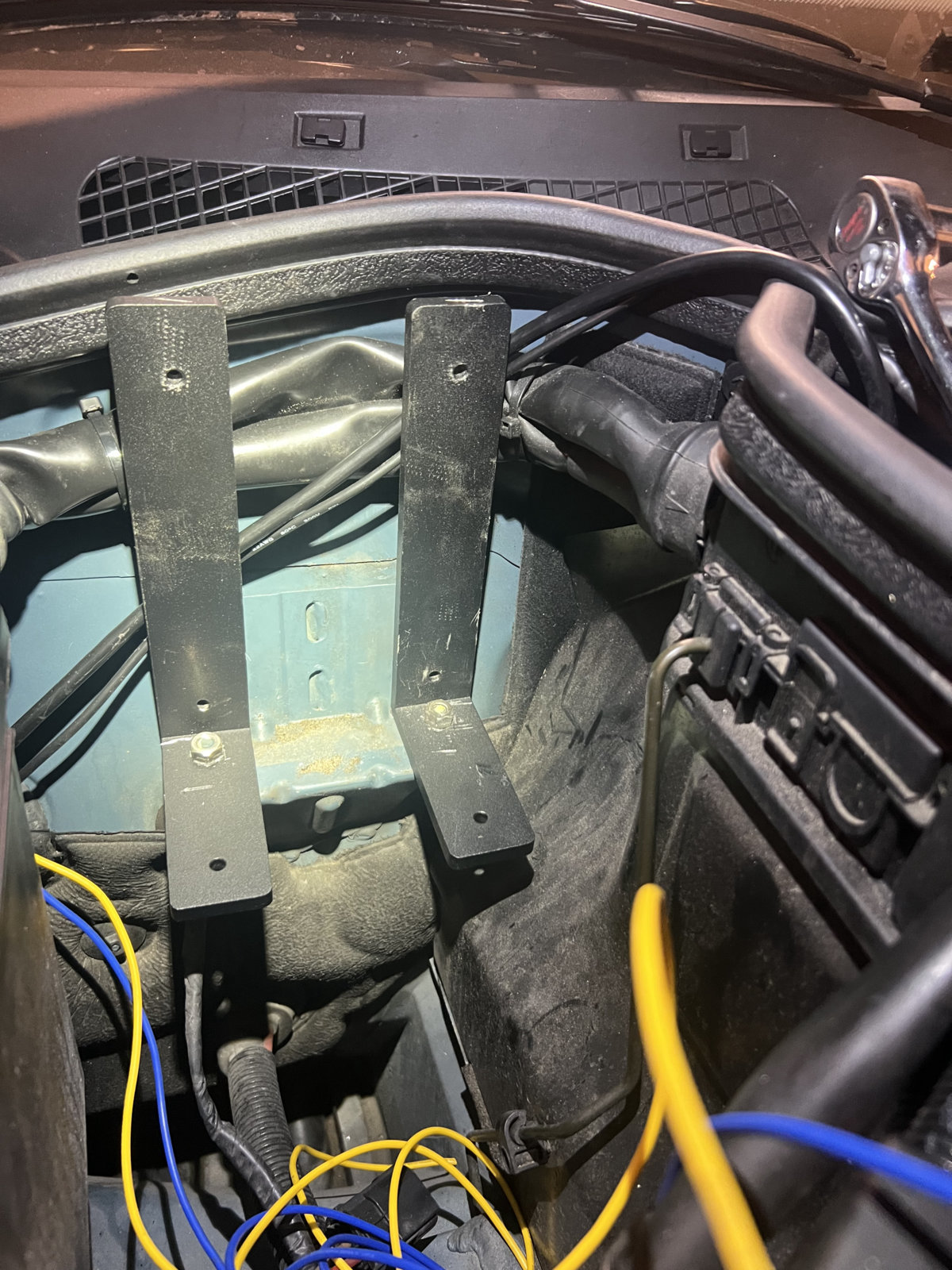

I made a mount for the traction fluid reservoir out of shelf mounts.
e30cabrio
American Zeds
Oct 10, 2023
54
2.8
Pulled the reservoir 2x. First was not happy with the wire tie mounts, then read reviews the fittings leaked. It's mounted with nuts & bolts & all the fittings now have silicone tape.

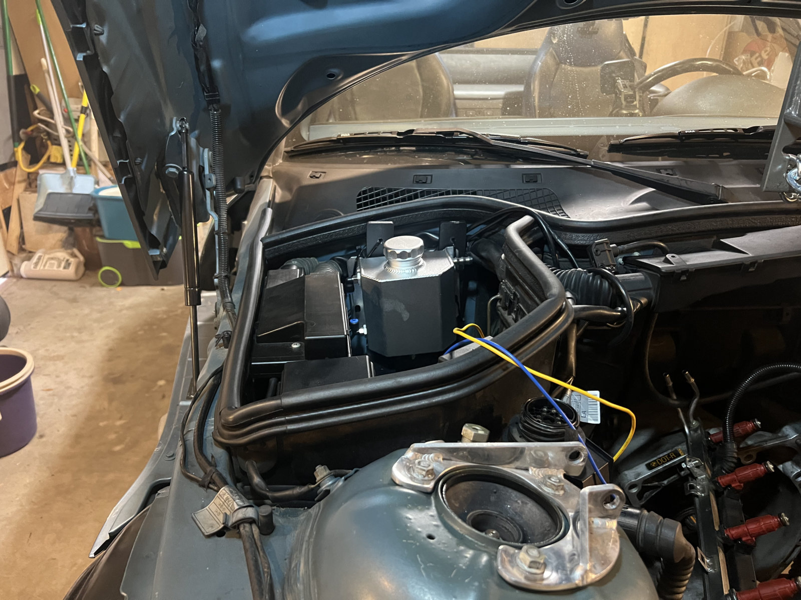

The SC mount replaces the alternator bolts, and the power steering pump needs spacers due to the S54 oil filter housing.
e30cabrio
American Zeds
Oct 10, 2023
54
2.8
I hope it goes in like this, getting the belt on was a massive pain in the butt!
Had to release the outside PS pump bolt & hold the tensioner as far as it would go with a gigantic breaker bar on my long ratchet (with my shoulder) while levering the belt on with a screwdriver.
