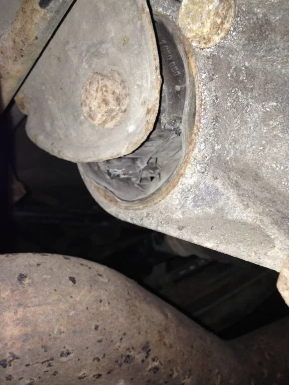

I had this and after changing the diff mount which can be done on the car it has removed it completely.
The clunk is there on the drive taking up the slack the thud is the diff moving under load it is more of a gently engagement now removing the thud

hi, sorry not been on here in a while, basically what i have done is change the diff mount baring, this has reduced the clunk to some extent but it is still there. I know that it is slack in the drive train. but i just can't find out where. what i plan on doing is: jack up the left or right rear of the car and engage 1st with the engine off and vigorously move the wheel by hand, with somebody under the car to locate where the sound is coming from.
people have thrown so many diagnosis's at it, it is just getting to be a bit of a nightmare. on the other hand, the car is fine and i drive it everyday. i do what to sort it out though and i will. its just finding the time to do it!

oh and i used the same powerflex pictured in the thread
