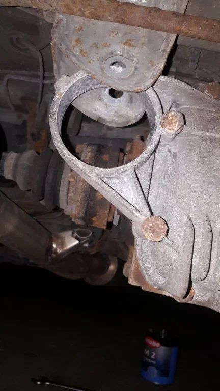

Antm72
May 4, 2015
246
South Yorkshire
2.8

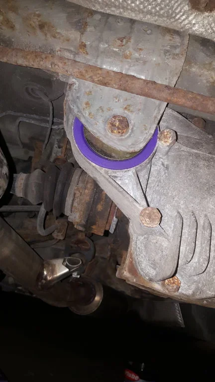

I had this and after changing the diff mount which can be done on the car it has removed it completely.
The clunk is there on the drive taking up the slack the thud is the diff moving under load it is more of a gently engagement now removing the thud
dva99999
Feb 14, 2016
85
Wirral
Unfortunately gone
Thank you......How easy was it to change the diff mount. Is it something that can be done at home or are specialist tools needed?
Antm72
May 4, 2015
246
South Yorkshire
2.8
You can do from home the powerflex one can be installed easily by hand. The bush center will likley fall out the most awkward bit is cutting a slot in the metal outer ring with a hacksaw to remove but its doable.
