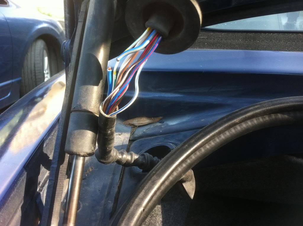

Intermittent lock performance is usually associated with a breakdown of some of the cables where the wiring loom in the boot leaves the car body and enters the boot lid - it is commonly referred to as the `loom of doom'. It can cause all sorts of strange events. There are a few photos on the forum but I can't find them at the present. It can also be a faulty door solenoid but I would start with boot wiring check.

Edit - photo of typical loom damage added. This is from an article on zroadster.net (author may be on here)

Glad you have made some progress - it could still be an internally damaged loom wire which is difficult to find - bit fiddly but it was suggested to me that you can stick pins through the wire cores on either end and check continuity for each with a multi meter.
