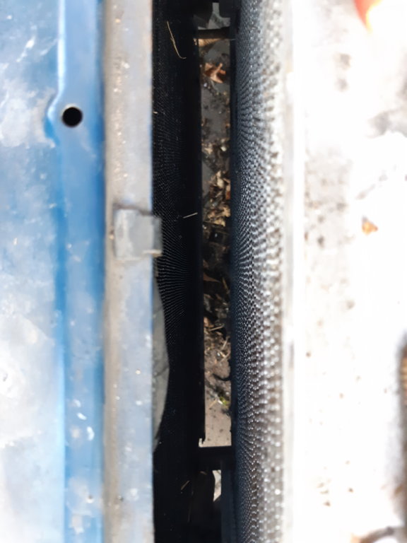

Fiddling around blindly underneath, I felt a few leaves between the two radiators so decided to pull them out. Then I felt more and more. Decided to pull the rad off the brackets and lean it back to see what was going on. 20 years of everything it turns out

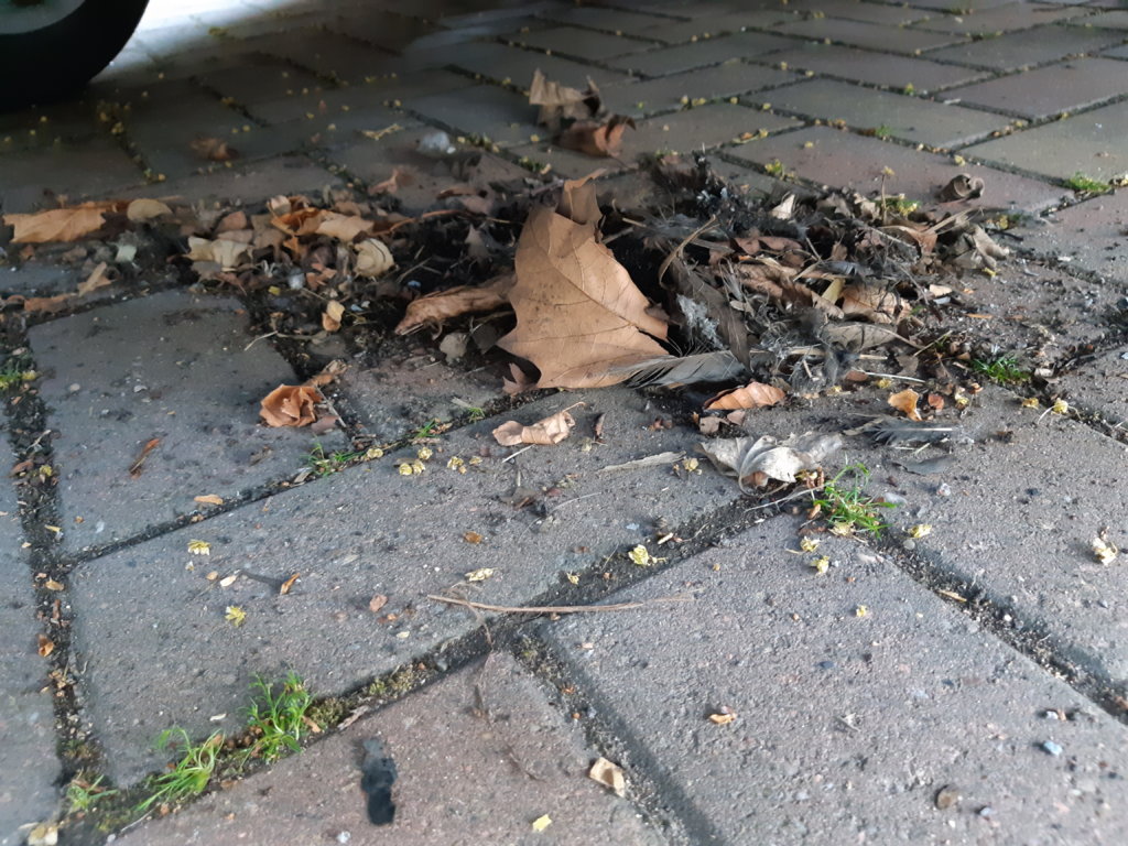

Now I'm used to cleaning heat exchangers and the such like at work, but how can so much get in a gap barely big enough to stick a finger?! Took the plastic edge strip off the top of the radiator to brush off wedged feathers and it came out alright. Here's the pile left
So it may be a good idea to take 10 minutes to pull the radiator out a bit and clean between. It'll be worth it!
