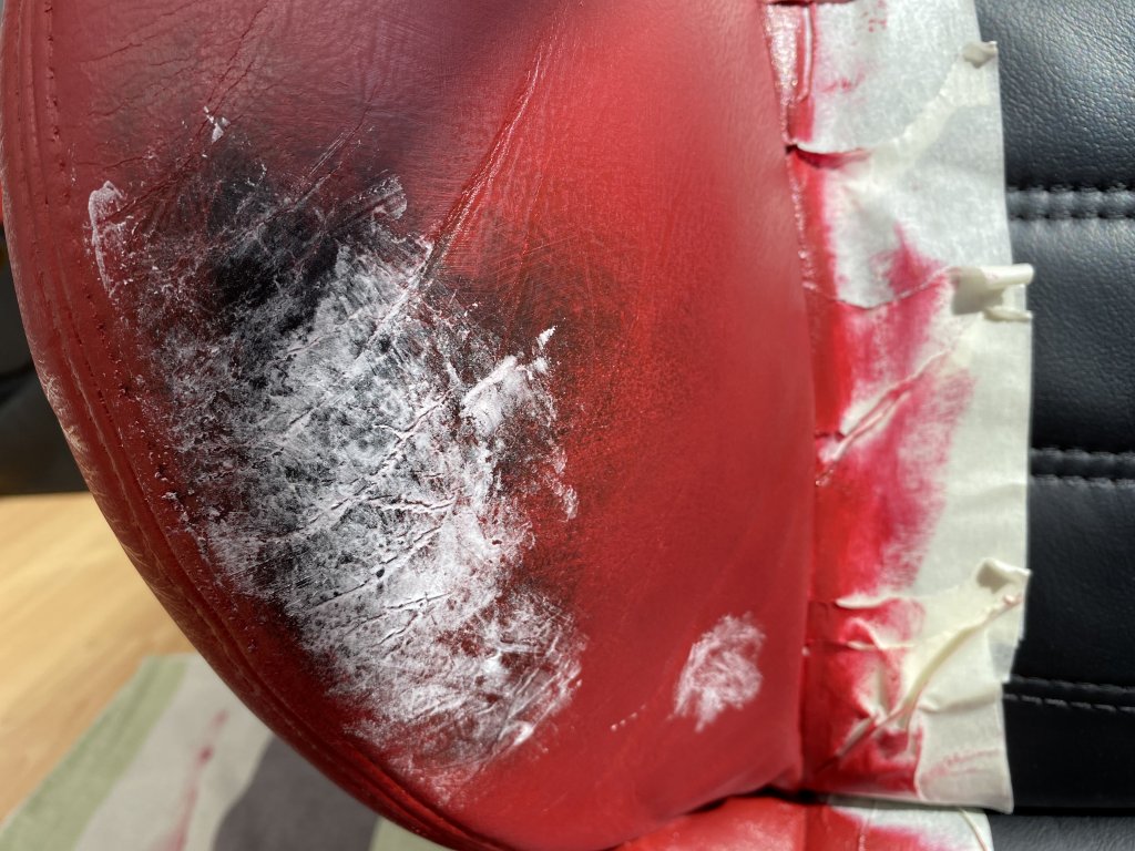

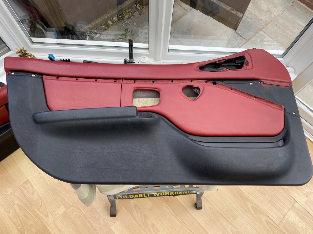

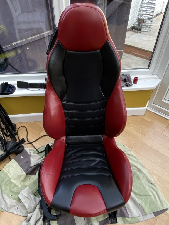

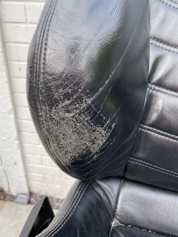

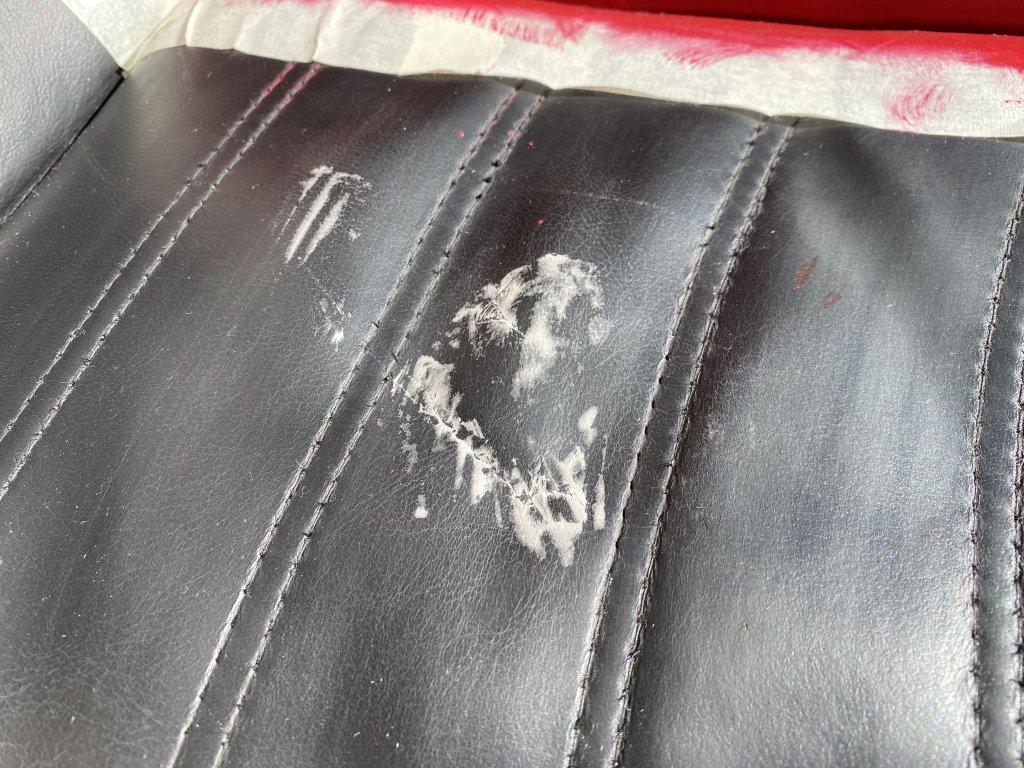

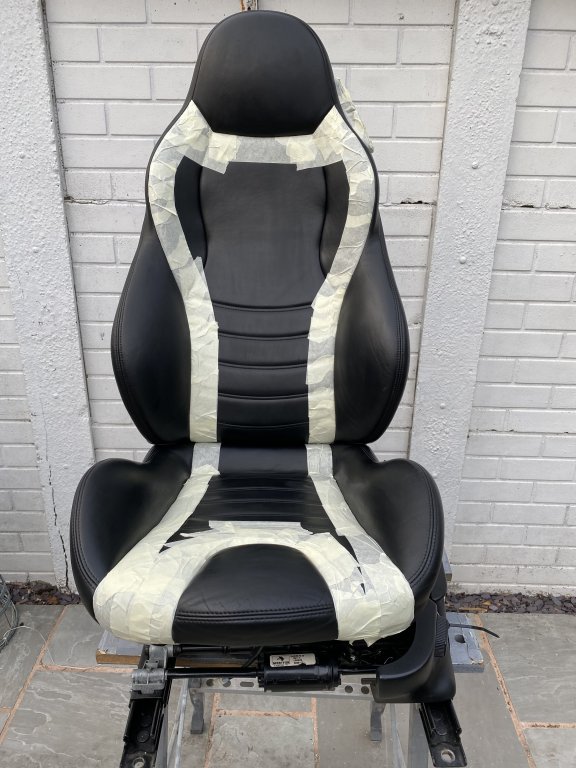

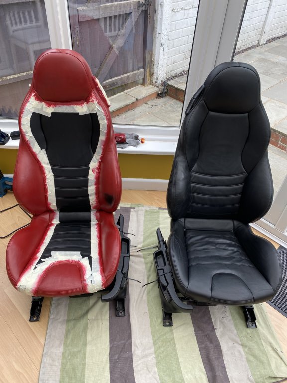

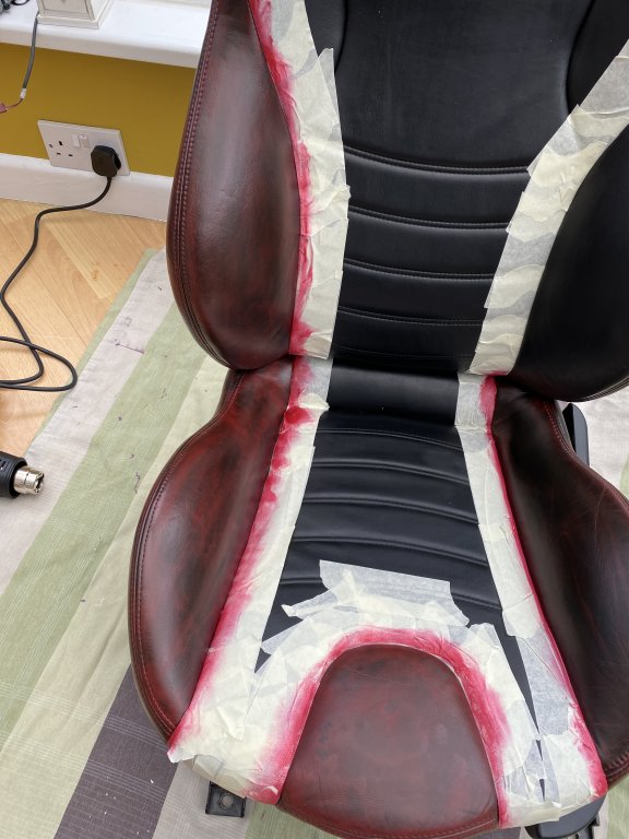

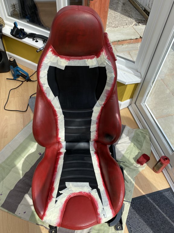

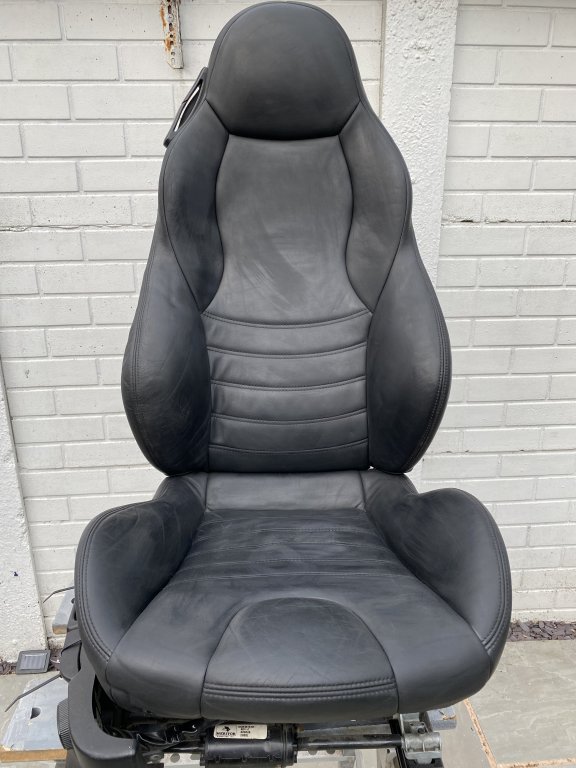

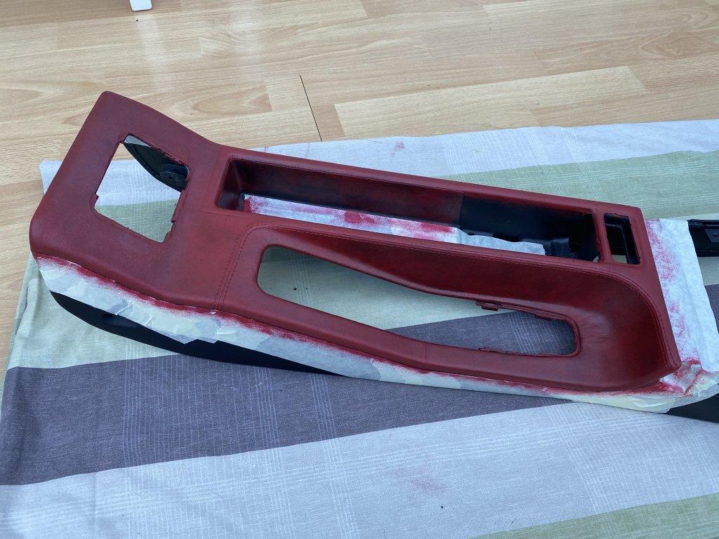

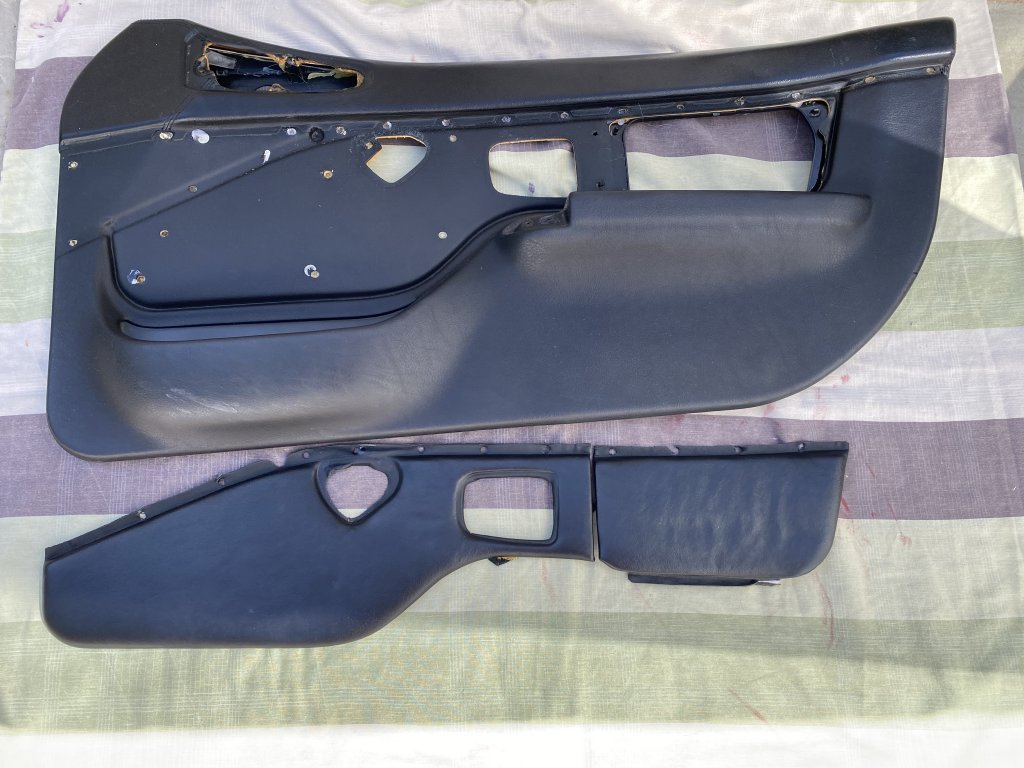

Like a lot of us at the moment I've had a bit of spare time so I decided to do something I've fancied doing for a long time. The real reason I bought some Imola red dye was because I fancied recolouring the ///M interior exactly as it would be in an ///M with Imola red and black seats, doorcard inserts and centre console. It has taken a while to do, probably around 3 weeks doing a few hours a day. I used the furniture clinic kit and refreshed the black centre sections of the seats and sides of the centre console whilst I was doing the rest. I did a couple of repairs to the drivers bolster and bottom section of the seat mainly filling in some scuffs. Some pics of the progress

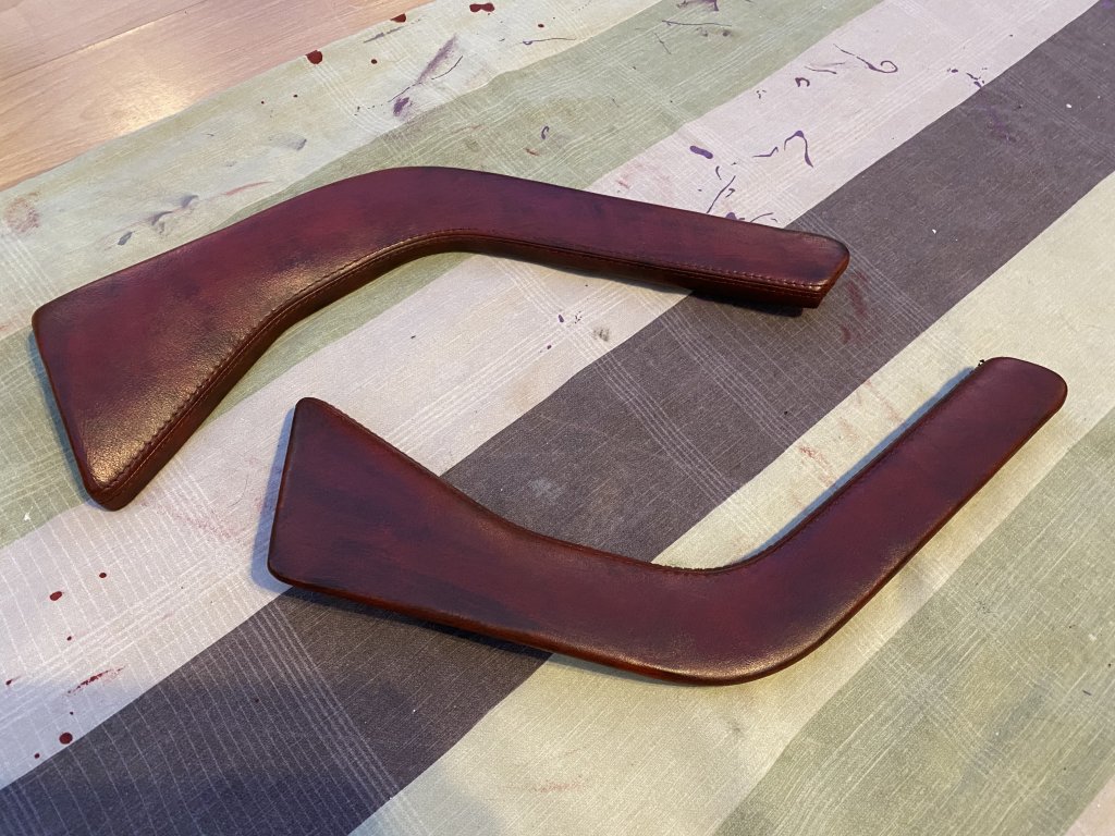

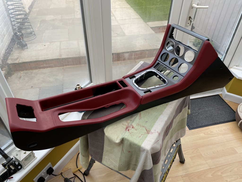

The carbon wrap colour I chose gives a great contrast against the black and red on the centre console and doorcards I think
You may notice above that I also did the pull handles in red as well. Not how they would have been originally but I've seen a couple of others done like this and I think they look great :)

Superb job, looks great :thumbsup:
Look forward to seeing it all back in place Dave.

what Andy says superb job. Did you spray it on? As the finish looks really good.
Well, I tried. Had very mixed results with the propellant cans, the black went on brilliant and the finish coat was ok when I could get it to work. When I sprayed the black it was a hot day, did it outside and it sprayed great. Did the same with the red but a colder day and the airbrush kept freezing up despite being in warm water. I gave up with it and applied it by sponge. This gave a great finish although it looked quite artificial so a rubbed it back with some wet and dry pads then applied another coat of watered down dye. Only thing I am not 100% happy with is the finish. It should be matt but I ended up applying this by sponge and it has gone a bit satin in places and you can see parts where it's been wiped on. I could flat it back a bit, but then again it's 20 year old leather so adds to the patina. If I was to do it again I would use the airbrush and a compressor. You do get a better finish by spraying, but then I seemed to get through the dye a lot quicker. They do still look great and I am very happy with the outcome.

You never cease to amaze me Dave, think that’s a great result and you should be proud. :thumbsup: I’ve been thinking of getting the kit and doing mine but know it’s not as easy as people think. Maybe later this year or early next.
Roy.;)
Awesome job Dave. Bet you're happy with that mate.:thumbsup:
Roy.;)
Thanks Roy. Go for it, it's not that hard really just very time consuming. Only thing I would do different next time is use a proper compressor to spray the dye on or at least the finish. I went for the matt finish but it never came out like that due to the way I applied it. They do look a lot more shiny in the pics though than they actually are.
