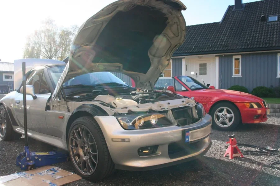

Didn't plan to work with a car today, however my mate pm'ed me and asked: "Shouldn't we do the oil change today?".
Since it was a nice and warm autumn day today, I agreed.
Cars lined up to get some TLC.
We started out on my old car, quick oil drain, filter change and refill.
My hellrot got the same treatment, but we also did a quick run with engine cleaning stuff. However the oil we drained didn't look to bad, so previous owner must have changed the oil quit recently. But better safe, than sorry. Now I know that it has fresh oil :)
Some more result of me playing with the camera.
Not a Zed, but a nice 1936 Austin Seven in good condition. Runs nicely and is uber fun to drive:)
