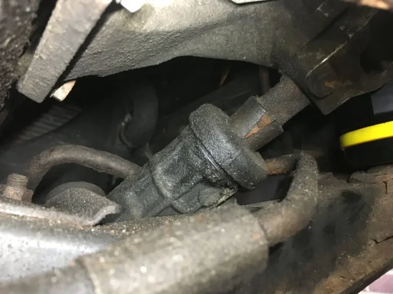

Today was a bad day with a sprinkle of good . . .lets start with the good, new front referb I shed snadblasted and red powder coated calipers arrived . . .yay excited to get my front hubs cleaned and painted, oh wait just destroyed both pulse sensors and of the black disk to bud Allen screws, rounded, yip, let that sink in.
Tip #1 - don’t touch the sensors as i bet there’re most pricey than getting another second hand hub (await confirmation)
Now what? No idea how to remove the screw! So threw in the towel and cracked a couple beers, part of the frustrations of the process, I’m sure ill look back and laugh, but I’m about to cry. Was hoping to have both king pins brushed and potentially double coatedo_O:arghh::banghead: some days i find things go wellI(1), some days things don’t(2), some days things don’t and cost you money(3), and last and least favourite is the money and time king(4), today was number 4 i fear.
If all goes well i can do the rake lines Saturday, and maybe attempt the connection of rear Sunday=)) I’m optimistic:thumbsup:

As you can see a half ass polish, lets see the cost of the sensors first, and the offending screw! I never knew plastic could become so attached to metal, must have been the heat over the years!
