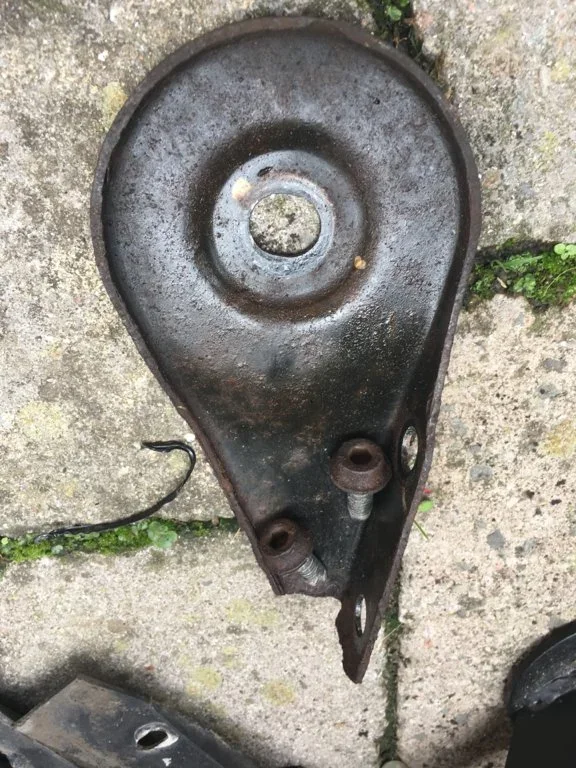

Mine was worse by the look of it , but with a bit of cleaning, anti rust and black topcoat came up ok. It will spend most of its life under the car anyway :)
Glad it not too far gone as I’ve had to use them in the past . . .add that to the list.

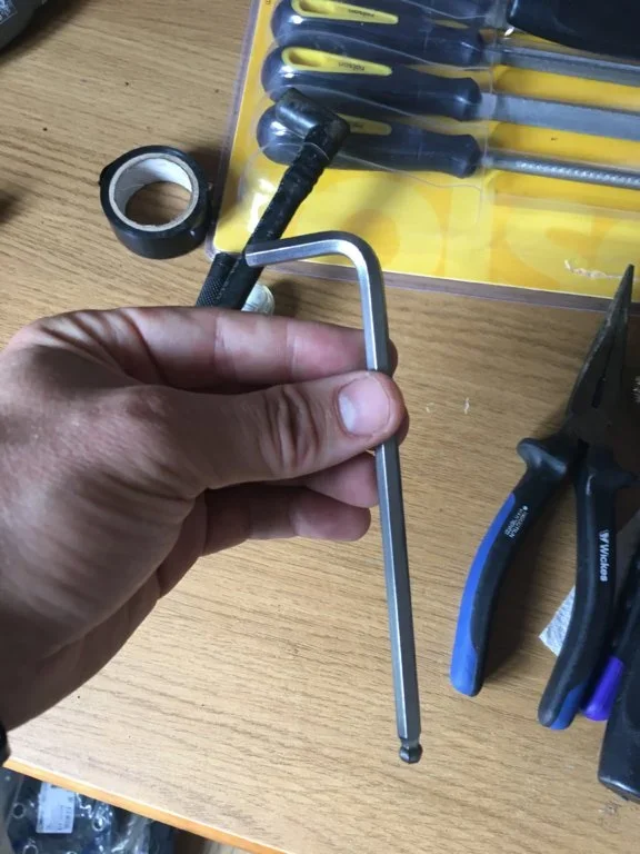

So here is a tip for anyone (like me, new) trying to get into a 6mm Allen bolt, use penetrating spray . . .and a 6mm Allen key with the round end (see pic) slowly work the end into the bolt and keep spraying spray, using this method i managed to get a ratchet 6mm into an otherwise no go bolt x4 (the ones in the pic), also use a small hammer and lightly tap it in and spray each time you get a little further . . .until there is a proper bite for the ratchet . . .!

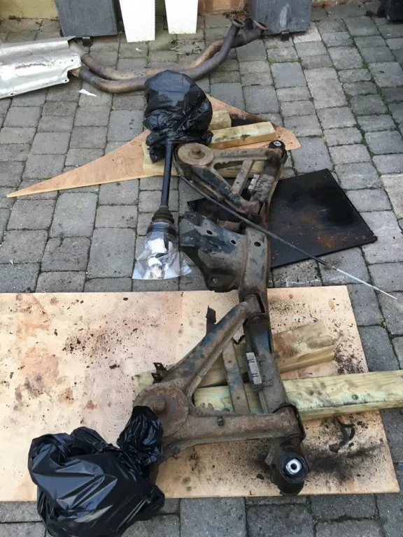

Today i managed to get 1 wheel prop out, disconnect the handbrake cable to on side and remove both shoes. I drained the diff oil and attempted cutting through the beam bushes with a hacksaw . . .a hacksaw ha ha, lots of sweat and not much change, mights try stick drilling or even a hole saw tomorrow. So close to having everything stripped but learnt that getting the wheel bearings out is a mission so as they feel good and i cant feel any movement I’m going to leave them in.
I’m considering removing the gearbox and inserting a new clutch but without another pair of hands nor a tranny jack, it many be beyond . . .ill keep waiting videos and see if the confidence grows

ZedHead
Aug 12, 2018
40
Prefacelift 2.8i
Finally de-rusted and cleaned the cross beam . . . Tomorrow the trailing arms

Blimey, you took the whole car apart in the time I swear at a couple of rusty bolts that won't come out. And yeah, also, lets down the whole friggin' back end while the car is held on 4 chicken drumsticks :)
Apart from the exhaust nuts fusing to the manifold outlet (2x bolts I’ll have to drill out later) it’s gone well. I was only able to knock out 1x of the wheel props so I had to derust with it on and from what I read about the wheel bearings that was a non starter so felt a little upset I could clean and potentially replace the back plates . . . But hey
Today was a massive day, derusted swing arm, diff, brake calipers, and wheel prop. Yesterday, swing arm, wheel prop and arb, back stiff now! But all parts are cleaned and ready for paint prep!
So much for Halfords 200 piece kit, doesn’t have a Allen socket/key big enough for the diff oil in/out plugs, I’m guessing it’s a 14mm? Anyone know for sure?
Last derusting is to the underside of the car, that is at least on my back, but I expect it’s going to be like working in a rust storm! Might need to don the goggles for that one. And the tank straps. Had a member round mine (Mazza) and he’s working on manufacturing some stainless tank straps!
