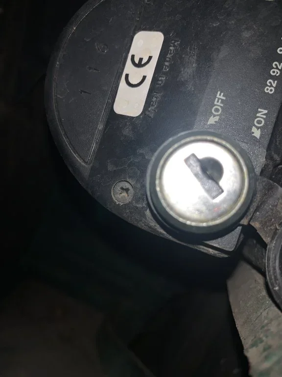

ruan
Apr 26, 2024
28
Berkshire
3
Can anyone confirm if this siren is in the on or off position, please. I am trying to get my alarm system to work, so just need confirmation. I tried Tony's suggestion to turn just the inner, but it isn't that simple, never is ☹
