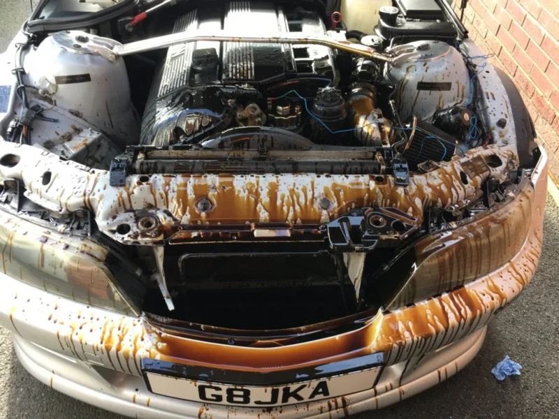

unless I have missed something we still don't know where all that oil came out.

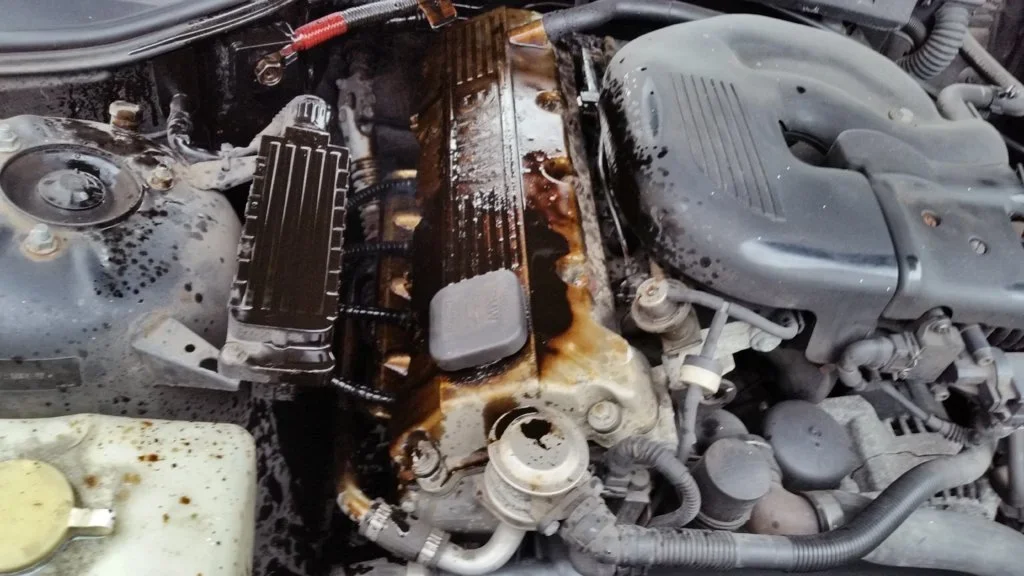

Can you see the point on the gasket where it has failed

It is not looking too bad at this stage but unless I have missed something we still don't know where all that oil came out. There was certainly a lot of it when we stopped.
Good news so far Gary, would it be best to have the head skimmed while you've got it off just to be sure. can you check to see if any of the piston rings have broken ?
Is it near to where the pressured oil feed passes from the block to head Garry?

And magnafluxed in case of hairline cracks??That’s potentially good news, so it was just head gasket failure? I was wondering due to the reported oil loss at the scene.
Would it be worth while to have the head blue printed to check 100% on a possible warp?
