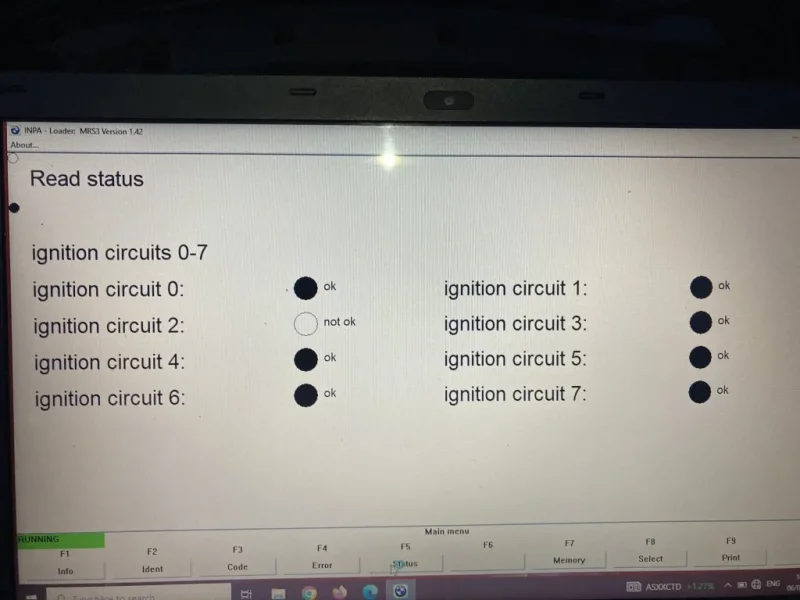

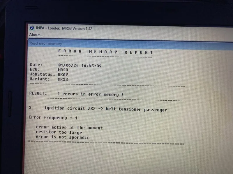

Ahhh...The dreaded airbag light has come on again! Just flickered on and stayed. I tried the D800 but to no avail. That read page 38 error 3 (which I believe is insufficient voltage) BUT upon using my INPA software I got the following pictures..
Can anyone please tell me how to find this problem and fix it.
Many thanks

Jan 30, 2024
The belt tensioner is connected to the seat belt. There is a wire & connector under the seat. Oftentimes the connector comes loose over time and will trigger an error in the airbag module. You can try to disconnect the connector and clean/reconnect. You can also solder the wires; when taking out the seat at a later time, you will have to cut and resolder the wire.... but it will ensure proper connection in the meantime.
