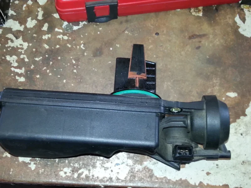

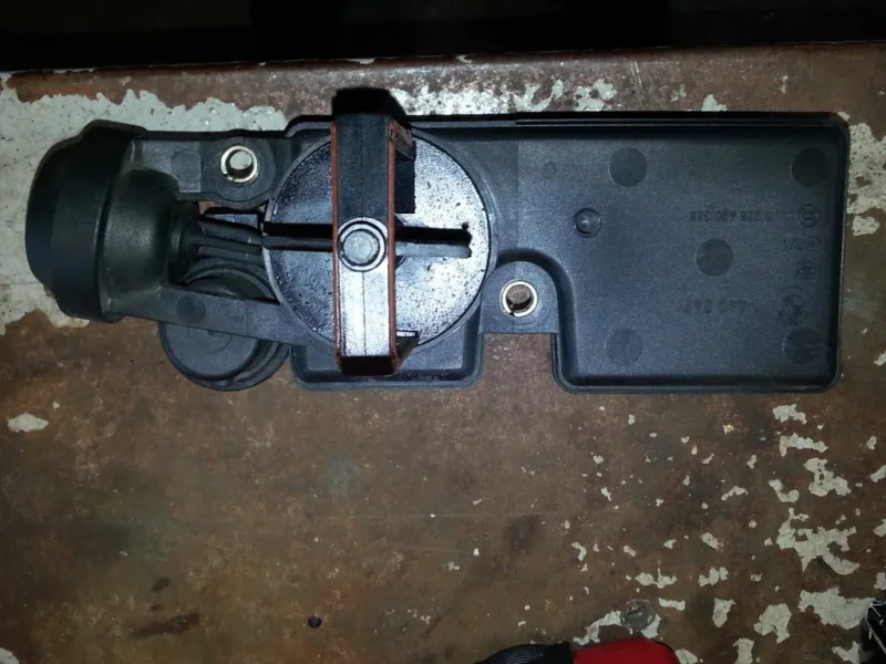

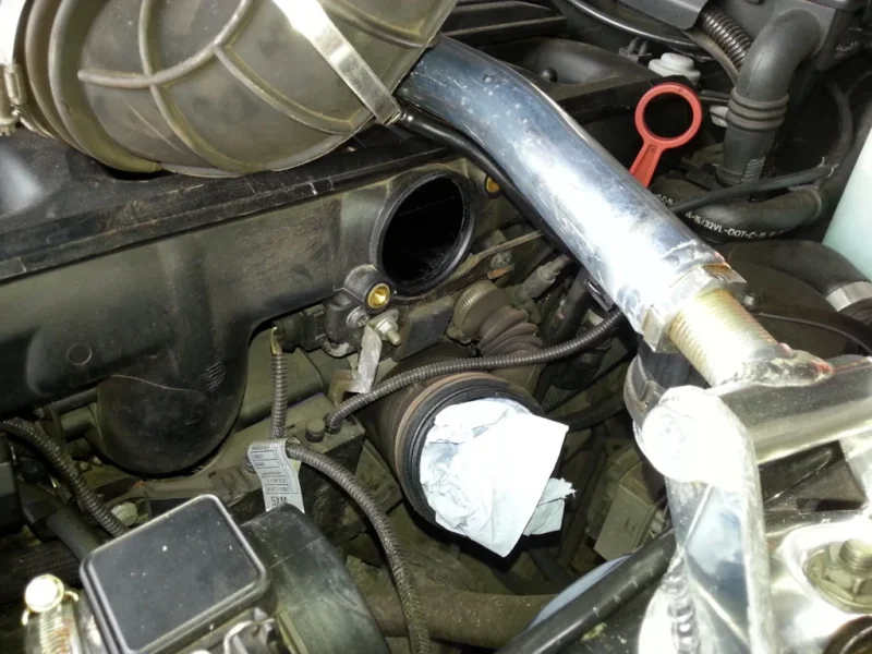

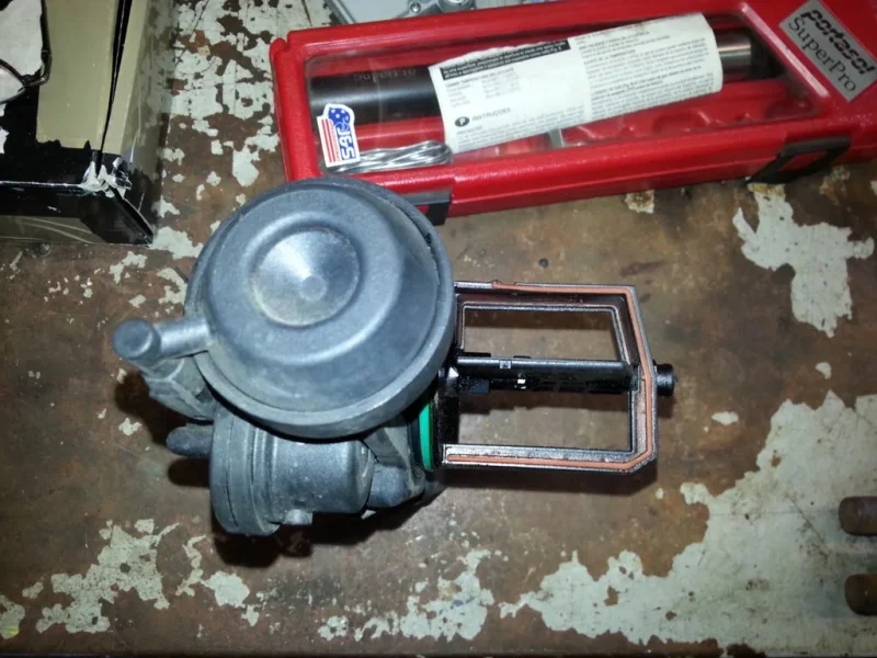

Got to be worth it for that alone I think Moz .I took mine off today after work and, I assume in the at rest position, it is "open" as in Woody's photos. The thing I don't understand is that if it is in fact open, with no electrical feed or vacuum depression in the manifold why does it appear to "close" when it operates ? Also I don't see where it gets it's vacuum from, if there was a pipe connection, you could suck on the connection and see if the vac capsule is a) working and b) holding vacuum the same as you can on an old school distributor.
My valve appears to be in good condition with no loose parts or rattles so until I find out how these operate and wether it is in fact operating as it should I won't be changing it.
Further research underway.

My type of unit which is different to the one in the picture has a small hole in it which I could suck on to see if the flap opened.
Mine worked fine an and as tony said there were no loose bits but it still made the rattling noise.just like the engine to sound as quiet as poss :)
