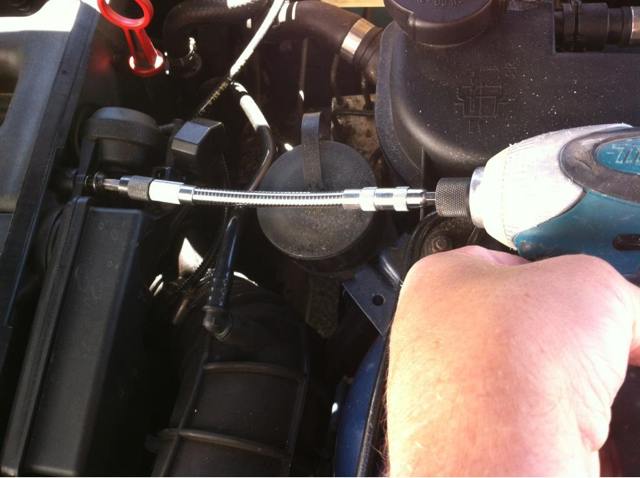

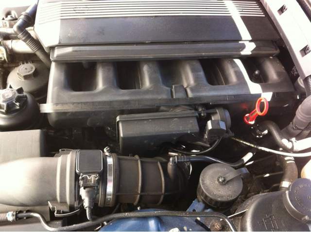

I thought I would take my DISA valve out this afternoon in preparation for the new upgrade replacement parts i bought this morning off eBay
Really easy, this is where it is to the left of the dipstick
Two torx bolts hold it in place and there is an electrical connection on the top which just unplugs
I used a bendy extension (first time I've used that for a while !!!) to get to the bolts
You will need to undo the large inlet hose to be able to get the valve out

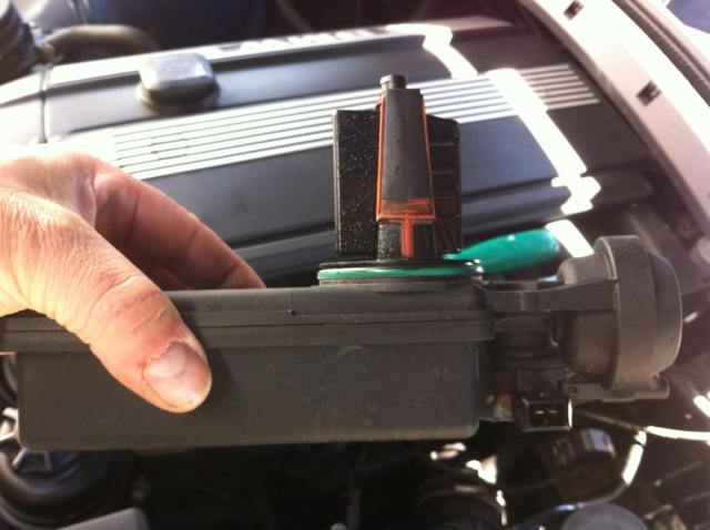

This is what it looks like when its out (that don't sound right either!).
Fortunately my valve is all good with no lose bits at all which is pretty much what my doctor said on my last visit !
Total time 20 minutes, got to be worth checking your own valves or even check a friends !!

Yep sure did M, there was a little service Splodge which wiped off easily
As I have already bought the replacement I will fit it when it arrives but I couldn't see much wrong with this one.
