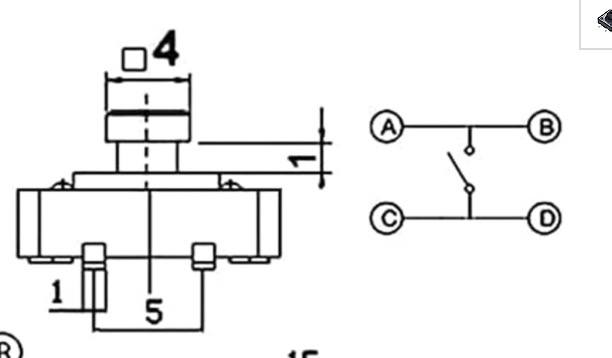

If anything is shorting then it's likely a switch. That's the only thing that moves.
Do you have a multimeter?
Even if the button feels like it's working the contacts may be stuck closed.
They're usually pretty simple. 4 pins A, B, C and D. Where A-B are usually permanently connected and C-D also permanently connected. Pressing the button bridges them together like this
Can't see in your photo which pins are A, B etc but if all 4 pins are shorted together then you can assume the switch is stuck closed. It might not be as per that diagram but, using a multimeter you should be able to check that the switch actually does something. Contacts open or closed.
Don't have a multimeter? Got an old zed? I'd recommend having a multimeter in your toolbox. They're not expensive.

Wow, i love this explanation. I have multimeter, literally used it yesterday to find out my alternator in E46 is kaputt :(
So the 4 pins for the switch are as marked below. I assume i check A with C/D and B with C/D to see if the signal is static. If it is - what are my options? I have a solder but its weak, cannot unsolder this thing....:

In the 4 pins you've circled - assuming that A/B are at the top and C/D below then just put the meter into, what I call, 'beep' mode and touch B and D and if the meter beeps the switch is duff.
