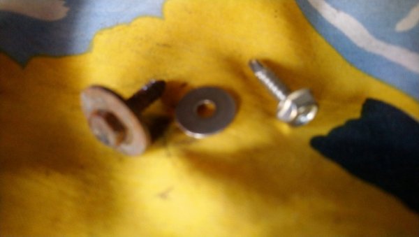

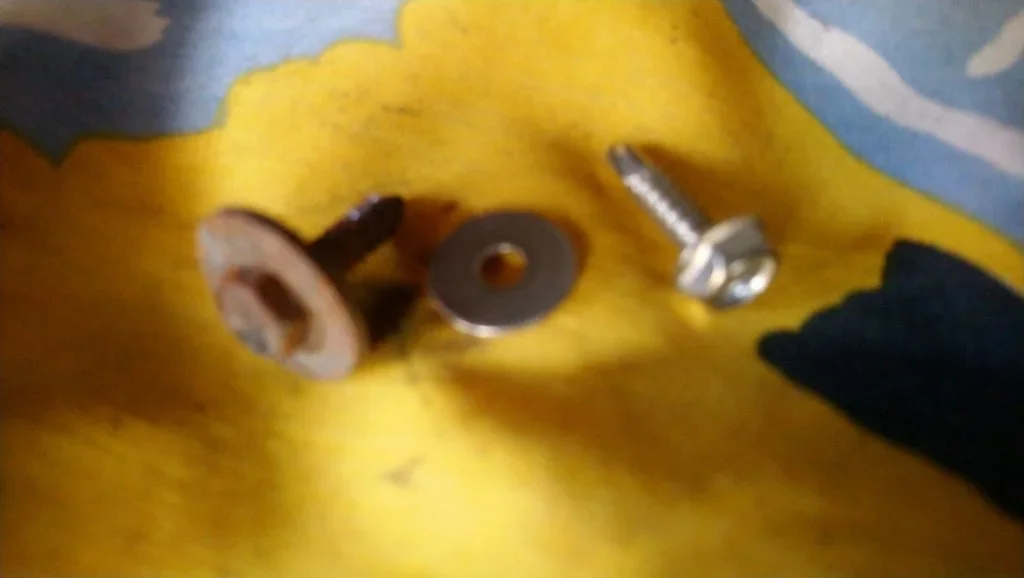

That hidden tin eating thing, and that's why everyone needs to check the inner sills bet they looked good before you took the outers offSpent 3 hours wrestling with the 8mm AF screws that seem to fix all the panels and sills on.
What a nightmare......
but in the end after using an angle grinder, multitool, and lots of swearing got everything off.....

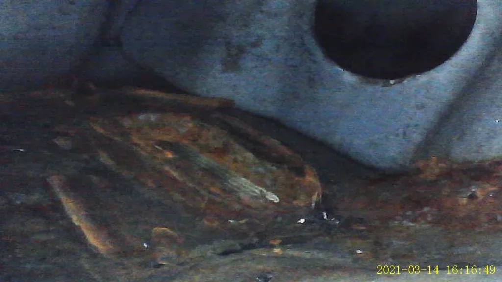

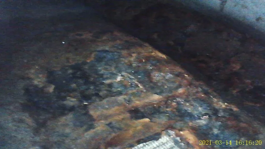

)Inner sills treatment today.....
RC900 spray. A 400ml can just enough to do both sill cavities. The nozzle with the long tube was an extra 3.99, expensive ...but worth it to get a decent coverage inside the sills.
I took some pictures with my endoscope before and will compare tomorrow with the after effect once its dried.
Then go over the external areas again with some FE-123.
