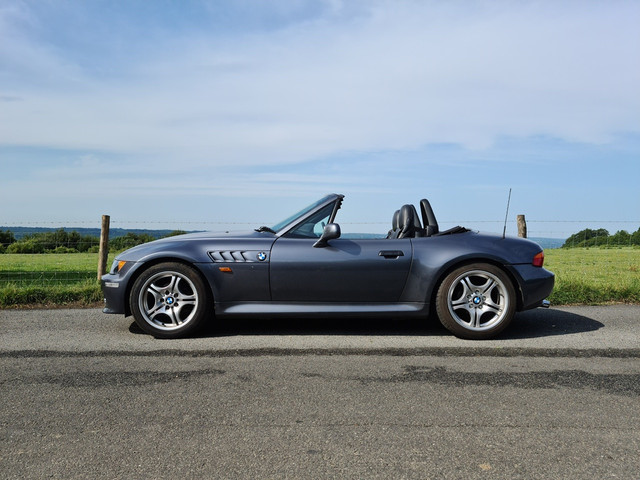

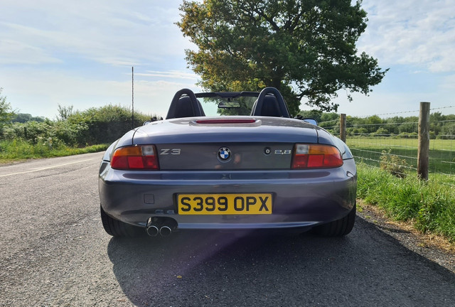

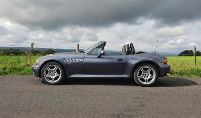

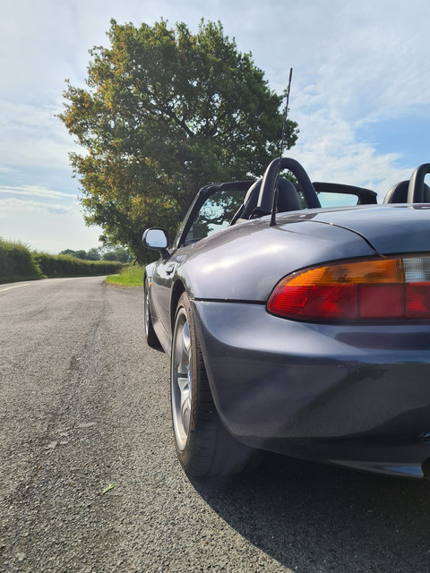

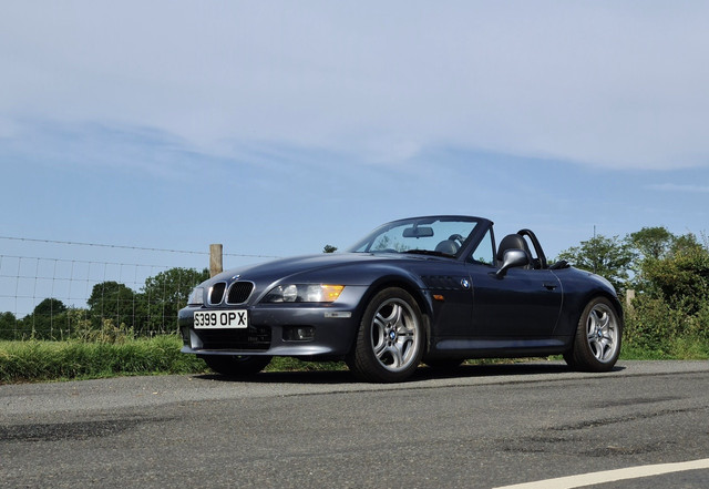

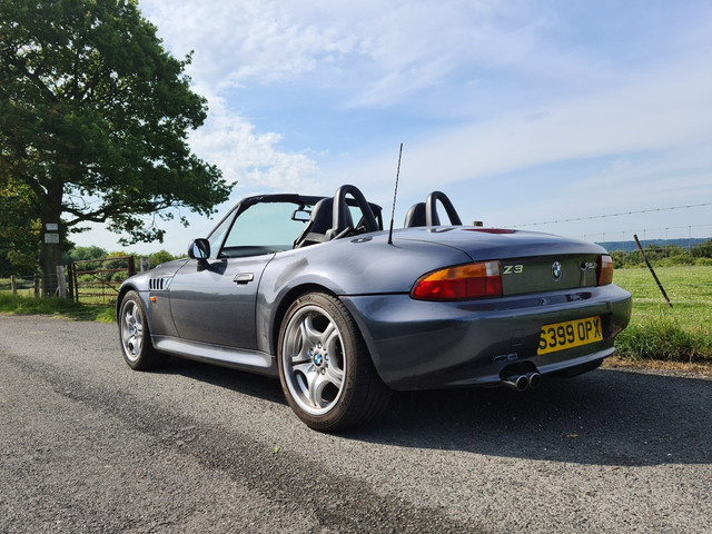

Just updating this thread in case anybody is looking to do similar. Eventually went with Bilstein B4 shocks, Eibach Pro -30mm springs, new 10mm spring pads and 10mm spacers for the rear - plus new ARB and control arm bushes.
For me it’s definitely the way to get a better look and better handling without sacrificing ride quality or clearance.
BEFORE
AFTER

B4's are just standard replacements. They're nothing special and are meant for standard springs, not shorter ones. The extended length of the chrome damper rod is important. If it's too long for the shorter springs then the springs won't require much - if any - compression to fit. That's bad news as the static spring tension will be non existent and the thing will be hitting the bump stops. M Technic bump stops are also shorter for this reason.
Short springs need short damper rods so that the springs require compressing fully to fit. Coil springs are rising rate so the more you compress them, the stiffer they become. They need a certain amount of pre tension when the car sat on its wheels.
