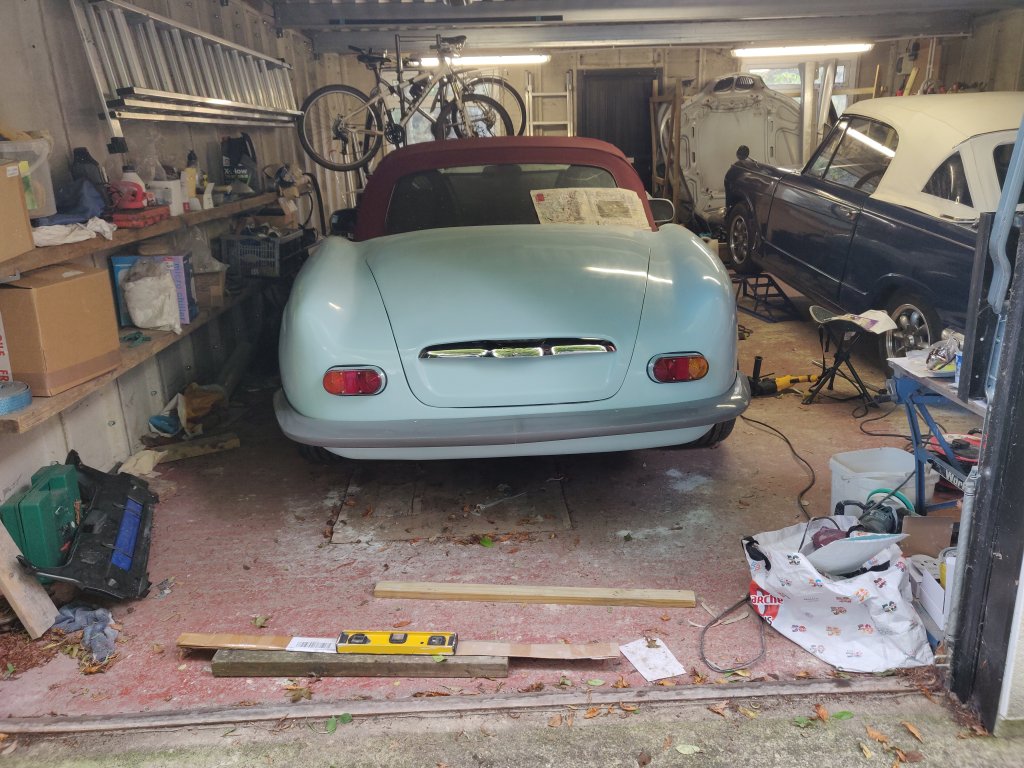

Wheel liners in, not too bad but quite different on the two sides, and the car back on its wheels so I can work out the height of the fog lamp (must be 250mm from the ground)

I didn’t worry about the height of the fog light, I can’t imagine anyone would ever check.
Car looks like it sitting higher now, is that the reduced weight?

The height of the fog light should be an MOT fail I think (certainly an iva fail, not that we have to worry about that. Yes she does seem higher not sure if it's just that she hasn't settled after being in the air for a bit or if it's the reduced weight

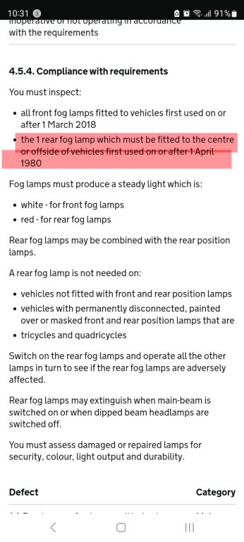

I had originally bought individual fog and reversing lights to bolt underneath the bumper. Have now backtracked and ordered 2 reversing lights that I'll fit under the rear lights and use the single fog lamp that i already have somewhere under the bumper.
Just remember that a single rear fog light, aside from the height, has to be mounted from the centre of the vehicle to the Offside. And, contrary to what some may think there are MOT Testers who recognize a home built car and do check for height of lights, distance in from the sides and such. Just so you know.

Thanks Tony, my friend mots my cars/vans so I'll double check with him when I'm ready to install it 😀

My mot tester has come back with this. Z3 is after 1980 so his view is centre to offside for location. He's not aware of the 250mm requirement as he's said that most modern cars have their fog lamp in a cluster which is higher than 250mm off the ground.
