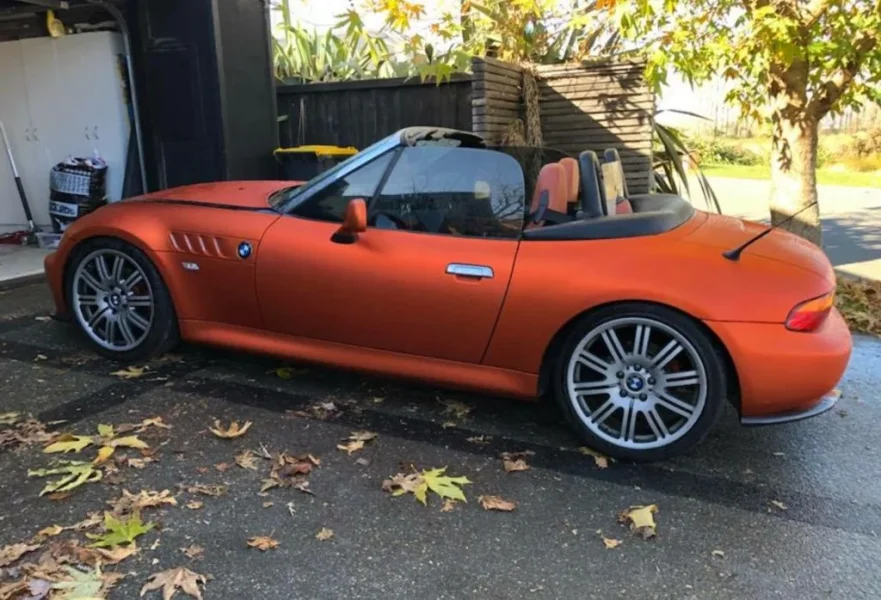

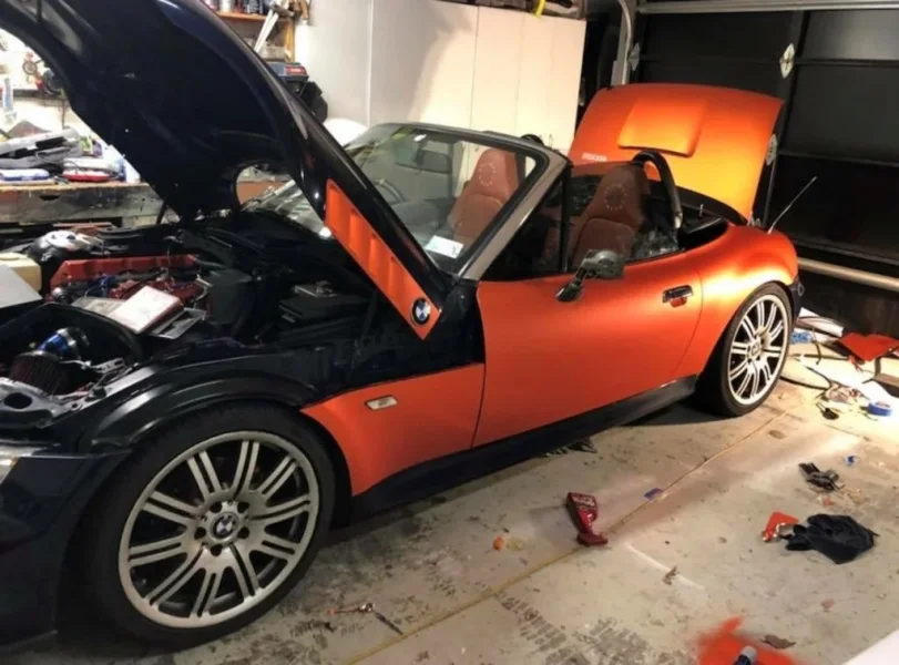

Love the colour this bloke in NZ wrapped his Z3 in
