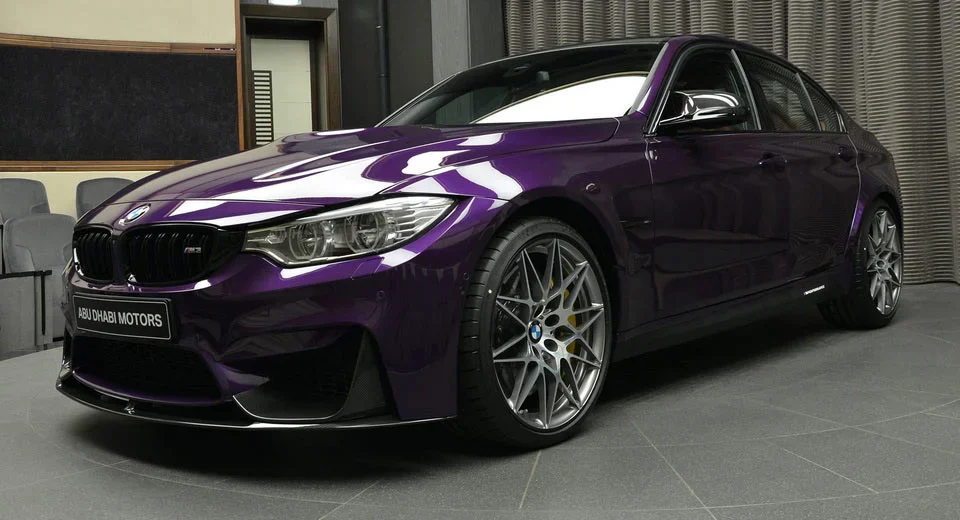

Hmmm, interesting choice Sean, but if you like it ;) and I'm sure it will look great :thumbsup:
g8jka
178
Telford, Shropshire
Z3 - 2000 2.8 Roadster
Didn't see all those pal :)
I'd be drawn to this one I reckon, stunning colour and it wouldn't make it look too modern as purple was an individual colour for a zed. I wouldn't want to be in your position with all these colours :confused:
