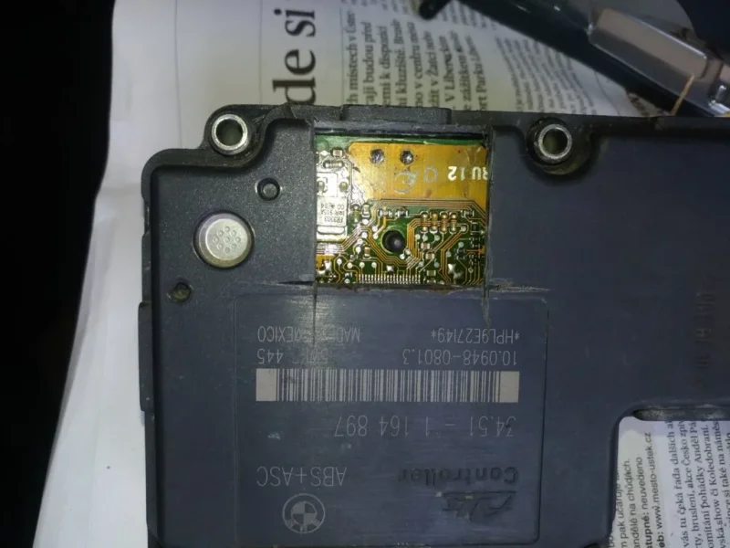

Thanks for this excellent post, I remove the controll unit from the pump in situ. Cut out a section of the cover and “Bingo” the both power to pump connections to the circuit board were defective as above. Soldered them resealed and refitted the Unit all fixed . Thank you for your post and clear photos.!!

For future generations. Only this part can be cut and a few of solder can be applied for these two contacts. Don't solder out of the circle!
I just wanted to say thank you as well. After much frustration with code 71 and replacing a sensor, I followed the advice here. Within an hour; I had the module out, that little section of plastic cut off, the connections soldered, module glued back together and back in place. No ABS or ASC light on! Brilliant, thank you. It's really easy even if you only know basic soldering. I now have a brake pipe issue but will post separately about that!
