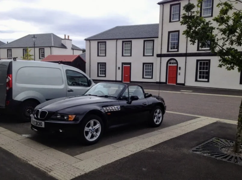

First stop was a place we'd read about and wanted to see for ourselves - the new development on the Earl of Moray's estate, at Tornagrain. Ben Pentreath is the architect of this new town between Inverness and Nairn, planned to provide 5000 new homes over the next 40-50 years, complete with high street, shops, parks and so on, in the old fashioned urban way, and all using traditional Scottish architecture and materials but in a modern context.
The whole town is being built from scratch, all the buildings are new.
The three storey buildings are flats, starting at £k137 for a 2 bedroom one.

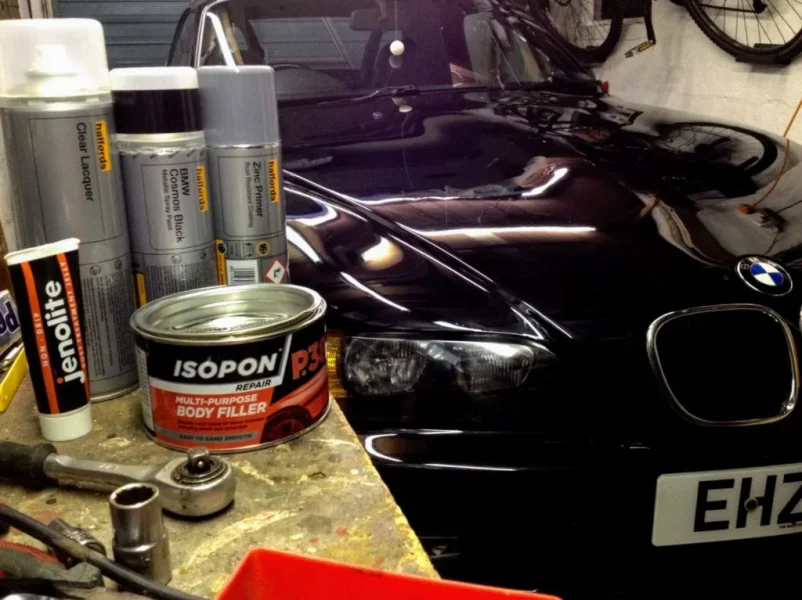

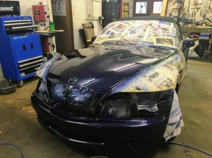

Today I went over to our Z3 shed, where Ray had sprayed his bonnet and front bumper, ending up with a coat of two pack lacquer.
Some more work will be required, but it's coming along, and will improve the look of the damaged paintwork.

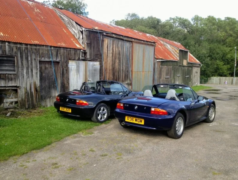

Ray's car will be in for it's MOT shortly, getting it back on the road after more than a year and enabling a bit of joint zedding.
The brake disks were cleaned of rust by bolting them on to the rear axle back to front, and spinning them with the engine, the car up on stands, and applying scraping tools. Next up will be draining and refilling the diff and gearbox.

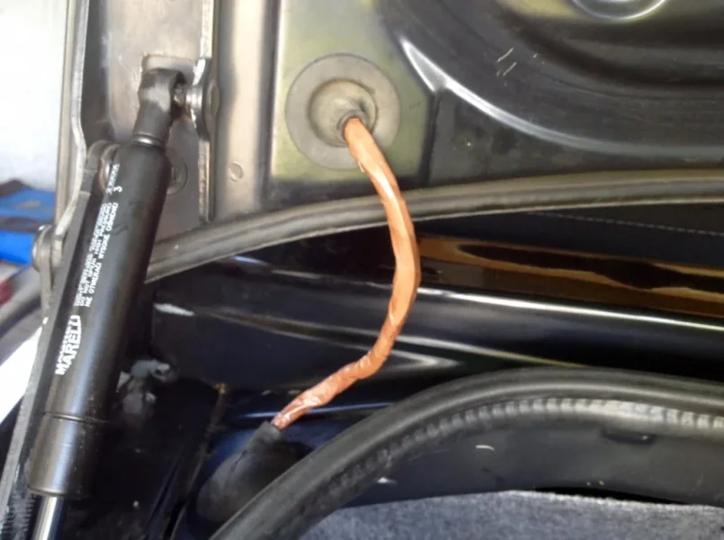

Recently, after getting confused over which way to turn the key in the boot lock, it no longer locks with the central locking any more. Then yesterday I was getting to know the boot interior, and poking the non-working lamp therein, and next time I opened it, the lamp worked. So, loom of doom, I surmised, and read up on the subject.
So, I shan't touch it until I've decided whether to cut back, solder, heat shrink and en-tube the existing wires at zero cost, or purcase the Vemo repair item on eBay:
https://rover.ebay.com/rover/0/0/0?mpre=https://www.ebay.co.uk/ulk/itm/132103355649
at a cost of £37.99. Probably the former.

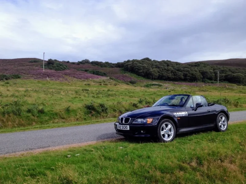

Anyway, today had to drive up to Brora in Sutherland - we needed a loaf of bread. And the sun was shining. We also wanted to check on the state of the heather too.
We came back through Strath Brora, and stopped for a cuppa.
There were a good number of deer to be seen in the glen, and we watched a golden eagle flying up and down Loch Brora in front of us.
Having stopped off near the Glenmorangie distillery at Tain for the shopping, we came home, having now clocked up 2,000 miles since getting the car two months ago. In the previous ten years it had only covered 16,000 miles in total, out of it's 143,000. But it seems to be relishing its new lease of life.

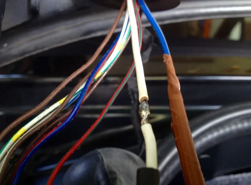

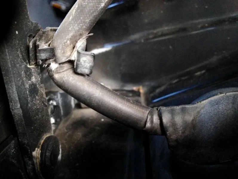

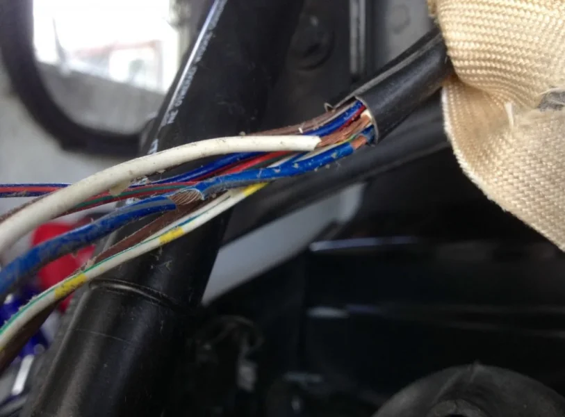

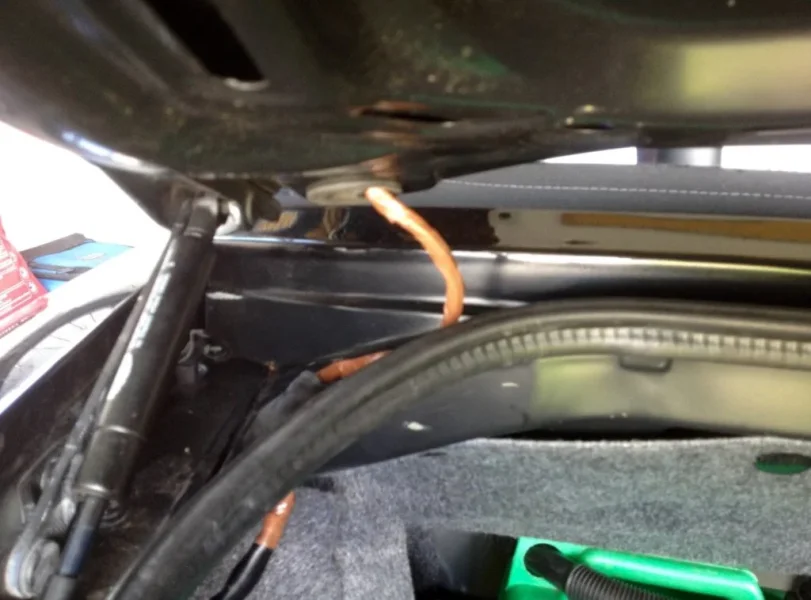

So, I had a go at the boot loom today. Having cut away the perishing rubberised canvas covering, all the wires inside around the plastic clip area seemed fine. But as I investigated a bit further along towards the boot lid grommet, two wires showed damage, with their insulation split exposing the wire within. Two of these breaks were right next to each other.
The white one had some strands broken, so I cut it and soldered the ends together having remembered to slip a bit of heat shrink on. The blue one had two bare bits, but none of the strands within were broken, so I just slit a piece of heat shrink and slipped it over for support and covered it with insulating tape (brown, as I have a big roll of it!) I haven't investigated what these two wires are attached to yet, but it all seems to work fine now, and I shan't be worried about a wiring fire, at least in this bit!
Not very elegant, but sturdy! Then, binding the length with tape, I played around with placement until it didn't foul anything when closing, and didn't get a kink in it either.

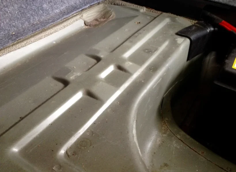

I'll cover it with some black tube in due course. So, a grateful thanks to all those who have posted their accounts on the subject, without which I wouldn't have had the confidence to attack it. While I was in the boot, I checked the spot welds in the floor, which look fine.

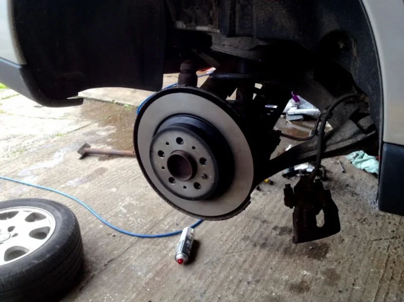

This week has also been MOT time, not for the Z3 but for the old Volvo V70 which failed on Monday. This is relevant because it has provided some good practice for working on the Z3, as the rear brake setup is very similar. So it needed new disks and pads, as well as parking brake shoes.
One of the handbrake cables needed freeing off as well. Having watched various YouTube videos of the jobs, all went well although the Volvo brake shoe retaining springs aren't as well designed as the BMW ones and were extremely fiddly to remove and caused much aggravation! So, it went back in for a retest this afternoon and all is well for another year; so I shan't have to transport bags of cement in the Z3 boot! :facepalm:
Even better, the parts were £115, compared with the garage quote of £310 for the work. That'll pay for Zedding on the Scottish run next month :) And I now feel more confident of doing the same jobs on the Z3 when it needs doing.
