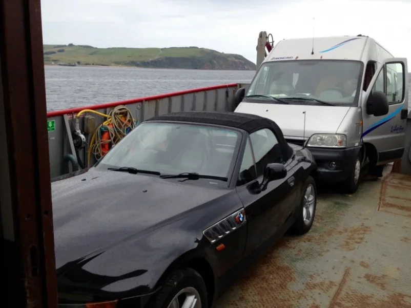

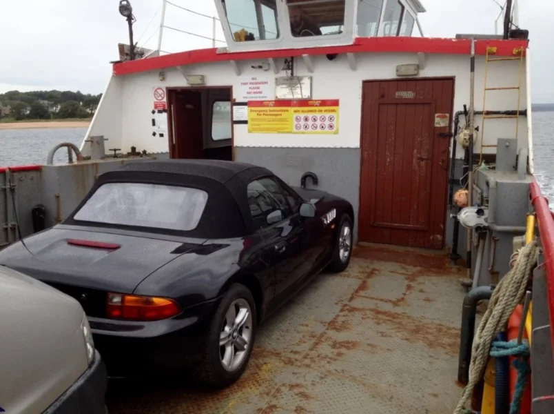

Wishing to check on my Z3's sea legs, we embarked on the Black Isle ferry from Cromarty to Nigg this afternoon.
I had been a bit concerned about scraping the exhaust, but I needn't have worried. At this state of low tide, the ramp was at a gentle angle.
The vessel, The Renfrew Rose, will just take two vehicles in a gentle sea state, with the rear wheels of the second vehicle to board being perched on the ramp.
On arrival at Nigg, to disembark required reversing off up the ferry ramp. Then we set off for fish and chips at The Crown in Portmahomac, with a glass of Happy Chappie from the Cromarty brewery.

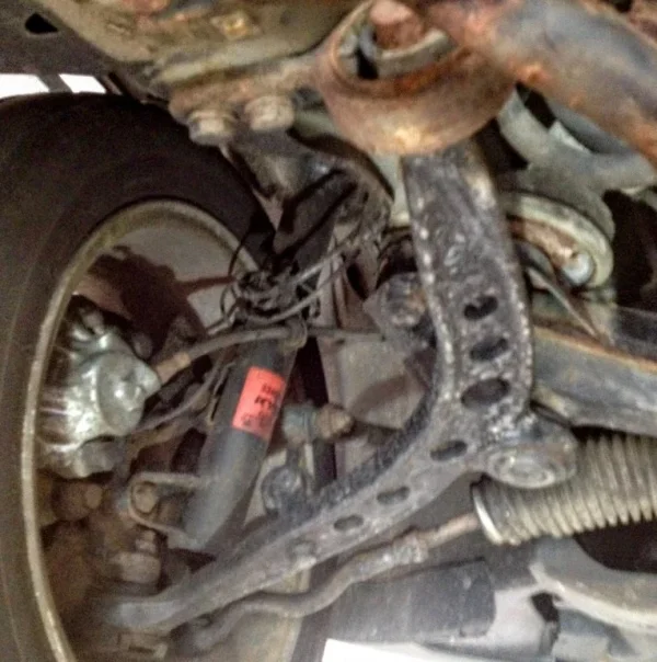

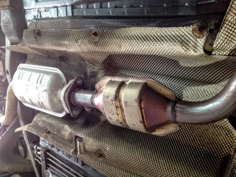

This week I got around to changing the gearbox oil. Having the car up Ray's lift to do so gave me another opportunity to spend some time under the car.
It needs a bit of a clean up, but changing the oil presented no problems, using a £6 Silverline half litre syphon/pump. The gear change was nice before, but I've convinced myself it's even nicer now!
The car has clearly had many parts replaced over the years.
A couple of rubber bungs missing off that caliper. Anybody chucking some old ones out?
I can see that many nuts and bolts will obviously need a lot of coaxing when the time comes to undo them. So I shall plan a session with a can of Plus Gas as a start.
I was going to change the diff oil, but haven't found a recomended product locally yet, so I may go to Opie Oils. Also, neither of us had a 14mm hex key to undo the plugs, so I wouldn't have got very far anyway! But I found a Draper one in Inverness today.

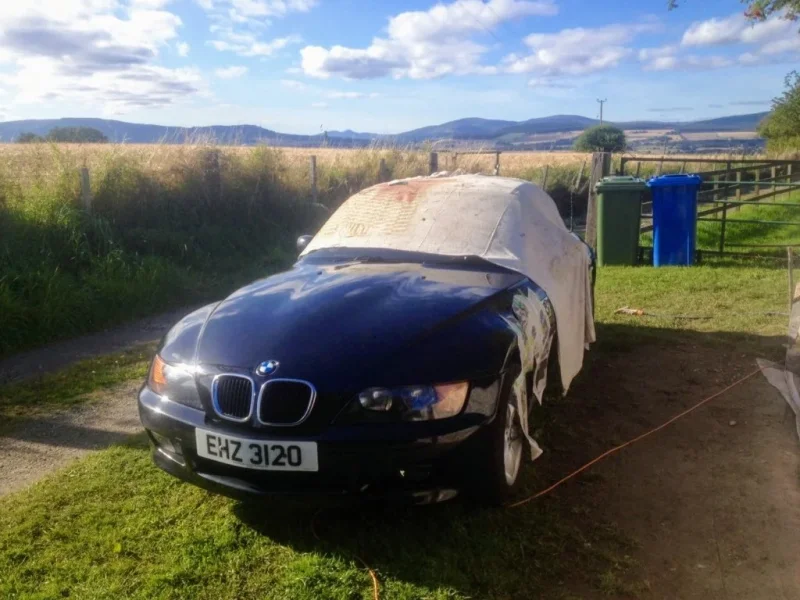

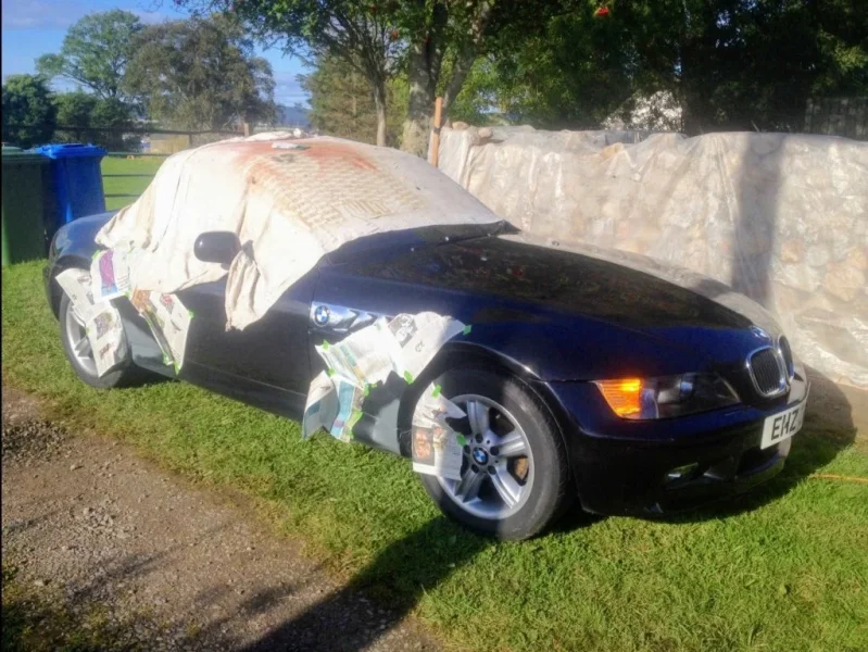

A still, sunny afternoon today, and the farmer will be combining the barley over the fence any day now (lots of dust), so I had a go at the ratty rusty corners of the wing panels which have been offending the eye (and Sara's eye) since we got the car. One day I may invest in some better panels, or get them resprayed properly, but in the meantime .... Plus the unfinished paint for the sills, which just had plain black after their repairs earlier in the year.
So I attacked the offending areas with a wire brush in the trusty Black & Decker, then feathered the edges, treated the rusty bits, and gave a couple of coats of zinc primer, then Cosmos, then lacquer from rattle cans, all with appropriate flatting, hot air gun and enlarging of masked areas as I went. I seem to remember first going through the process forty nine years ago on an A35. But with cellulose, obviously.
The structure on the right is the stane dyke I've been building as a garden wall, using whin stones, or field stones, which the farmers are happy to get rid of. However, due to the glacial origins of these stones, it's a bit like building a wall with marbles, and needs mortar.
Anyway, after a week or so, I shall gently cut the new paint and hopefully the areas will look better than they did, as least at a passing glance!

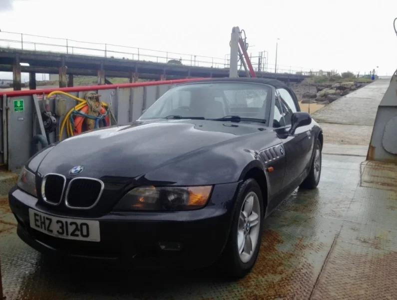

After a pleasant weekend, the weather deteriorated this afternoon as we returned from a trip to the shops in Tain. Rather than come home in the heavy traffic on the A9 in a downpour, we took the short cut on the ferry back to Cromarty. It is quicker and the fare is the same cost as the petrol for the extra 30 miles round the Firth.
There's quite a drop on either side of the slipway at Nigg! We were the only vehicle on this trip.

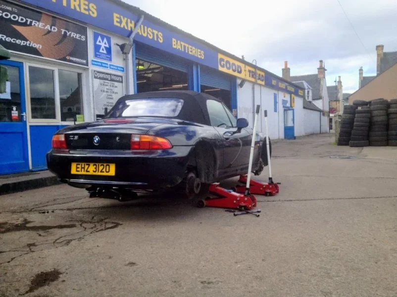

With a Highland winter coming up, the car has got a new set of boots. All the tyres were coming up to the limit - the two fronts were around RoSPA's 3mm, and the two rear ones had lost all their tread on the inside edge.
With a 1.9 daily driver, I don't need high performance sport tyres, and having read many reviews, as well as comments on here, I went for UniRoyal RainSport3 which rate well in the wet and also in snow, most important driving up here in the winter. And they were £55 fitted, which wasn't too bad. So I shall feel confident of the tyres, especially with a thousand mile trip down to Norfolk and back due in November.
I shall keep the old tyres, and may put the two 3mm ones on the rear of my old Volvo V70 estate workhorse, when the 'MOT advisory' ones on there finally need replacing. I may even get 5000 miles out of them, probably a years' worth on that car. (Strangely, the two cars have the same BHP of 140, same top speed of 127mph, as well as the tyres being almost the same. Even the cylinders are nearly the same volume, the 2.4 Volvo just has one more of them!)
While the wheels were off, I confirmed that all four springs and shock absorbers are replacement ones, which is good.
