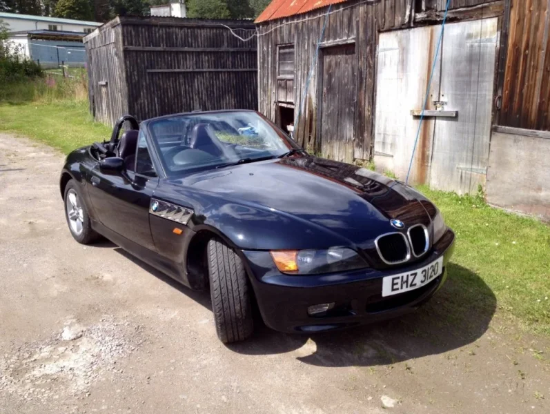

Here on the Black Isle, north of Inverness, my cousin Ray and I have two 1998 1.9 Z3 roadsters. Ray had bought the blue one, then found the black one which he bought as a source for spares. However it was clear that this was too good to break, and I bought it from him. He has a sizeable workshop with a new large covered area outside (roofing that that was our first job), and his scissor lift was moved out there. We spend quite a few afternoons there, a sort of two-person ZedShed (Black Isle)! Occasionally we also fix garden machinery belonging to people even older than us, if there's any time left from putting the world to rights.
Neither car had an MOT, but my black one passed eventually, emissions being the main difficulty. Brake pipes and a broken spring were replaced, and cosmetic work included cutting away the lower half of the outer sills and making up new ones bent up from sheet metal and welding them on, filling and spraying. The wheels were stripped, primed and sprayed. As previously reported, the spare wheel bracket was bent back into shape and refitted to hold the brand new spare wheel, although it lacks a plastic tray. The passenger seat was lowered, and seat risers installed for my drivers seat. A full service was done, with all the fluids and filters replaced, and new plugs.

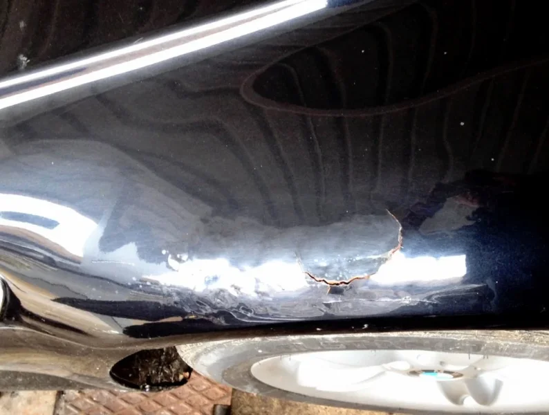

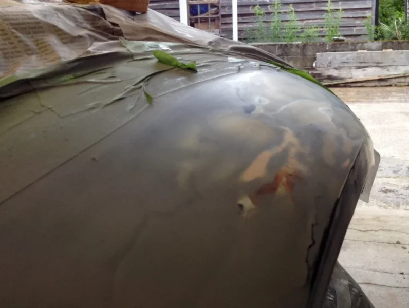

And having sourced and fitted the roll hoops and wind deflector, this last week we've been tackling the major cosmetic body issue: the bonnet above the drivers side wheel had some bad corrosion. This had resulted from the car losing its plastic inner wheelarch following damage in 2007, and it not being replaced.
One day I shall replace the bonnet, if the car proves to be a keeper. But in the meantime, I needed to do a repair just to improve the look of it. If you are of a sensitive disposition, best go over to the Media threads and admire the outstanding cars there instead!

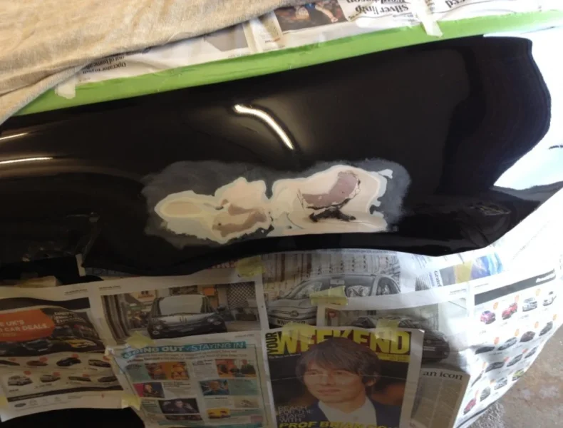

Bearing in mind that this is a temporary fix, a start was made by digging out, cleaning up to bare metal and rust proofing the underside of the area, then laying a fibreglass mat to provide a support for the subsequent filling. The next day an orbital sander on top soon revealed the extent of the rust and the filling that had been done in the past.
The bare metal edges of the holes were revealed and the next couple of days saw repeated filling and sanding until a coat of primer showed where the profile needed more work.

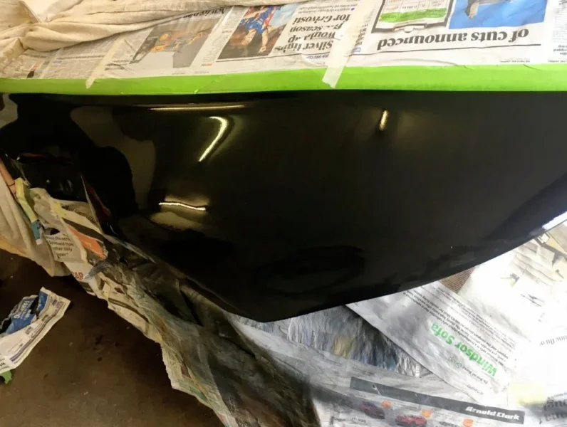

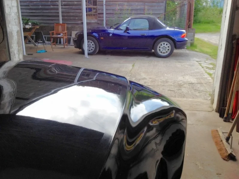

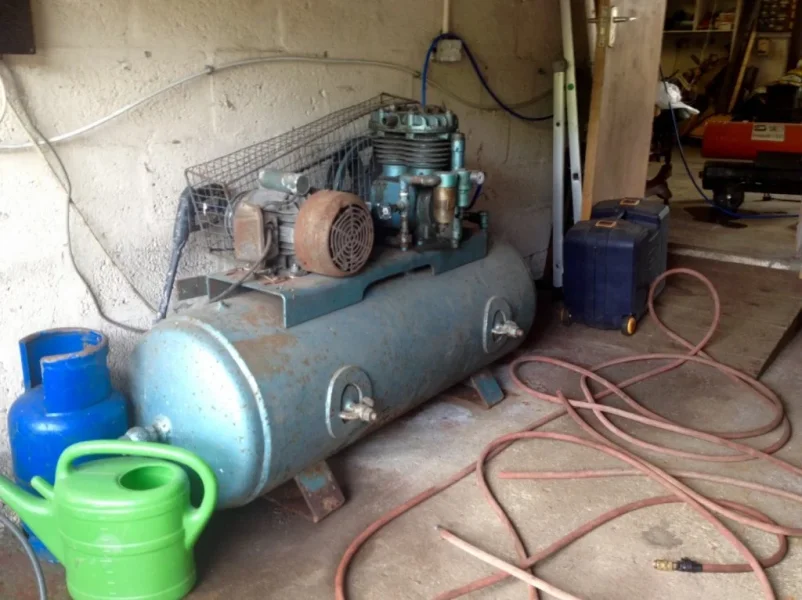

Eventually I was content, and with more primer and flatting it was ready for some Cosmos Black. We tried this with Rays big compressor and ancient spray gun, using some of the 250ml water based paint mixed for us in Inverness. However, this didn't prove successful (!) so that was taken off the next day. To cut a long story short, the job was completed using Halfords Cosmos and lacquer rattle cans in true Flipping Bangers style!
I masked the bonnet along the strake line, to reduce the visibility of the job. I shall leave it a few weeks before attacking the area with 2500 then 3000 grit abrasive before polishing it out with T Cut.
So, a first glance at the car no longer exposes a ghastly sore on the bonnet side! In fact when I've finished polishing it, it may withstand a second glance!

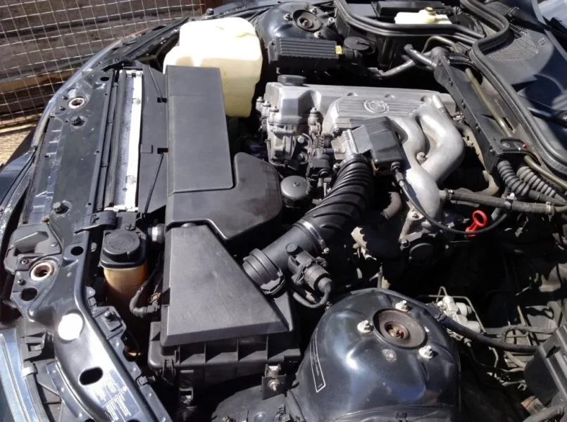

Nice to see an early one saved. I did notice that you seem to be missing the cooling fan shroud and associated panelwork/air ducting.
Yes, there are a few bits missing. Between our two cars there is one fan shroud, one suction tube and two top covers! Althouh my car runs at a good temperature, gauge needle vertical, I've noticed that on a long run, the idle becomes a bit uneven and down to about 700/800 revs when I stop. I've checked for air leaks around the MAF, splits in the rubber boot etc. So, just for a trial, I've borrowed the suction tube from Rays car, on the floor in that pic with a top cover, and fitted it temporarily, with cable ties, to see if it makes a difference. If it does, i may be asking if you've got a half-decent suction tube available, with its plastic ends.

The fan shroud helps pull the air through the rad instead of drawing it from wherever, probably more important when stationary. Sorry I cannot help with bits.
Well, it seems to be coping with our searing Highland summer temperatures at the moment. And the lack of a fan shroud might be a bonus in the winter!

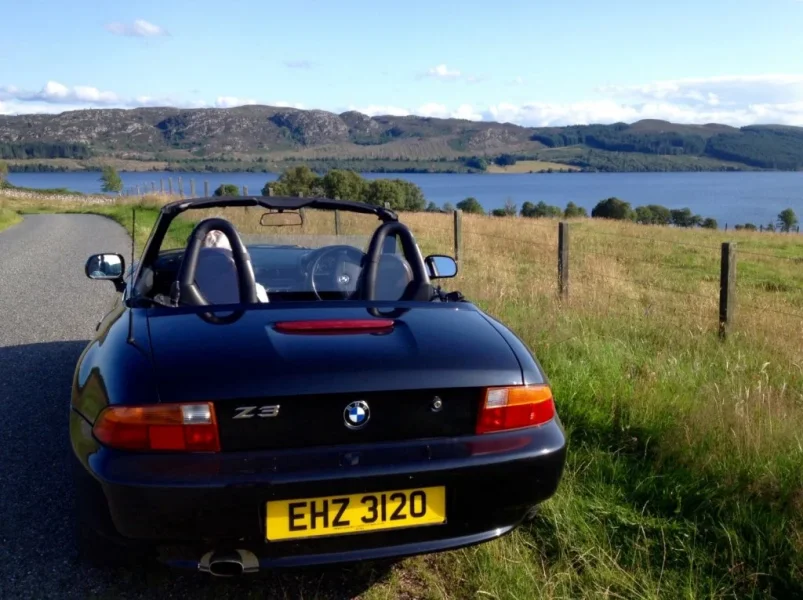

Progress for the last few weeks has consisted of extensive vehicle testing. In the seven weeks I've had the car, I've covered 1400 miles around the Highlands, mostly setting off at the end of day, roaming for a few hours in the gloaming, with sunset currently at 9.30pm, and not getting really dark for a while after that. A little has been on 70 mph runs on A roads, some has been trips to the village shop, but mostly exploring along single track roads up to the end of glens or secluded beaches. In that time I've used 35 gallons of petrol - 40mpg being somewhat more frugal than the workhorse Volvo estate (29mpg) or my daughter's 6.2 litre V8 Camaro coupé (19mpg).
But she lives in the USA, and fuel's a bit cheaper there at 66p a litre, but it still costs her 1p a mile more than my Z3 1.9!
Anyway, this is Glen Strathdearn:

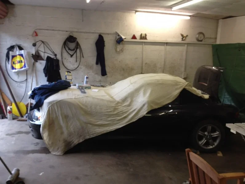

And here's the car about to be tucked up in the garage which hasn't been used as such for a couple of generations:

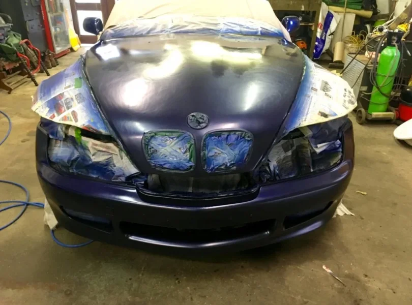

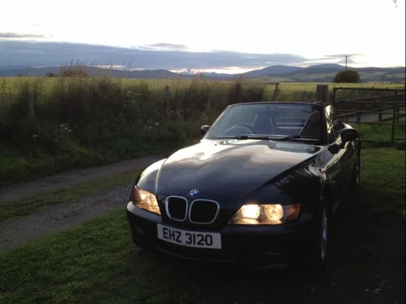

Following the excitement of joining @Faheem for a small part of his LEJOG, a little more progress has been made on our two Black Isle Z3s.
This photo, with low evening sun, had highlighted that the perforated metal 'grill' in my bumper looked decidedly skanky.
I doubt that it's original, but it needed sprucing up.
Of course, in normal light you can't usually see it, but after rubbing down, rust preventing and spraying it black, it doesn't stick out like a canine Richard any more.

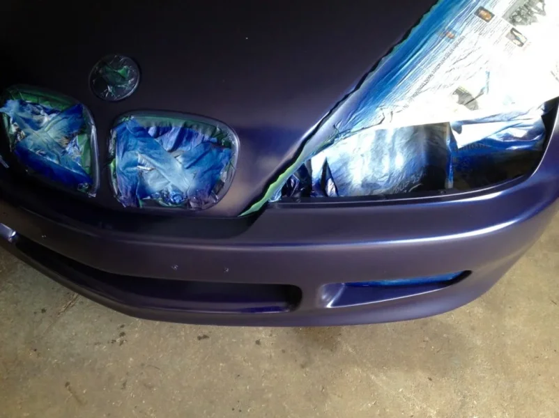

Meanwhile Ray had been busy sorting out his paintwork, starting with the central bit of the bonnet and the bumper.
Using the old compressor
and a new spraygun. Anyway, after rubbing down, and with Ray wearing a proper fresh air mask also supplied from the compressor, the first coat had gone on,
Just waiting for it to get good and dry before any further rubbing down with 1500 wet and dry, then the lacquer.
