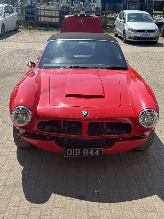

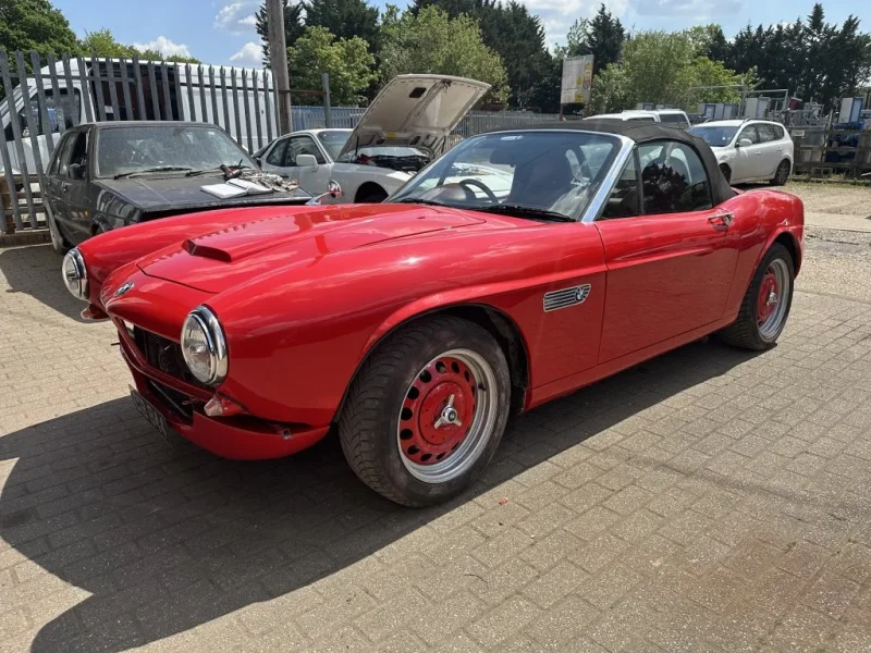

Moving forward, mostly just the chrome to refit

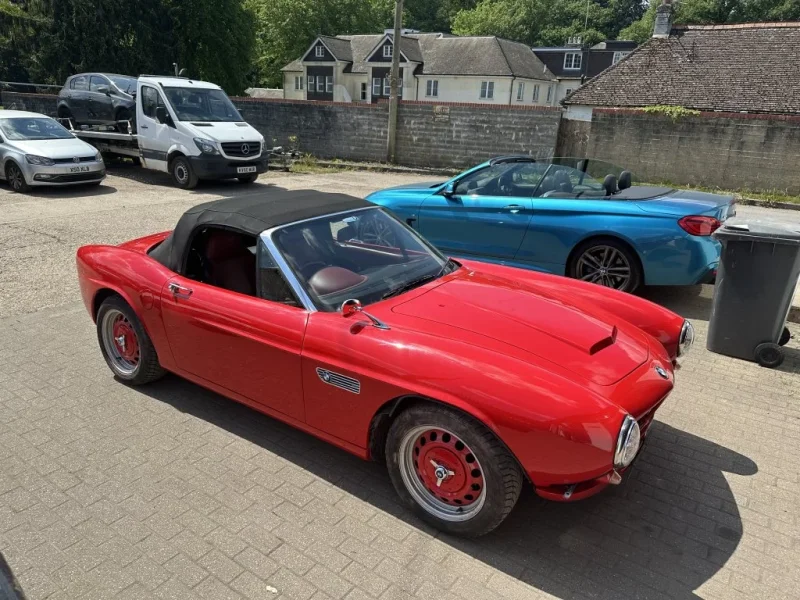

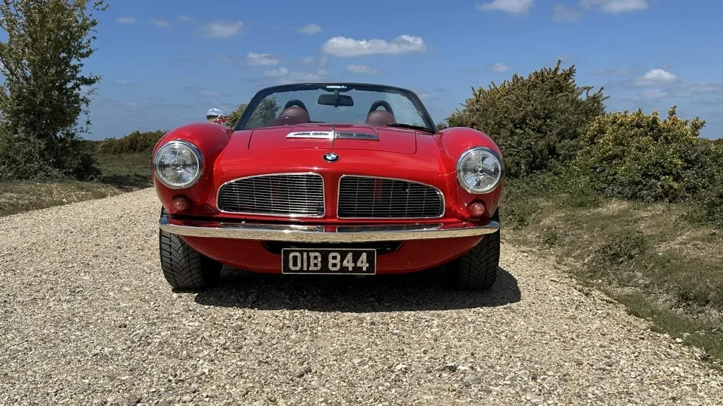

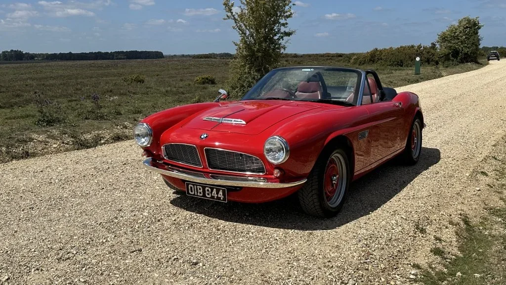

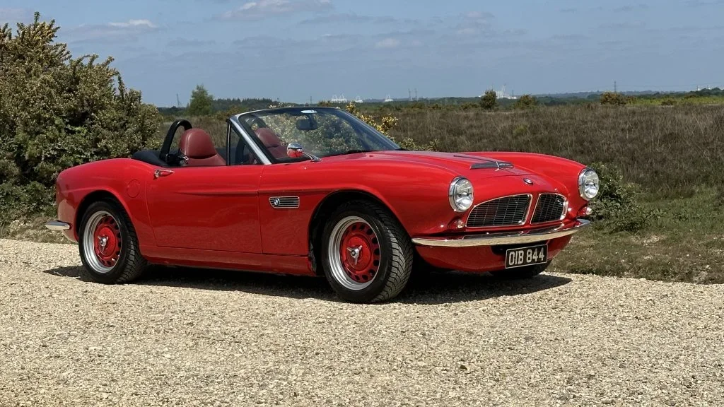

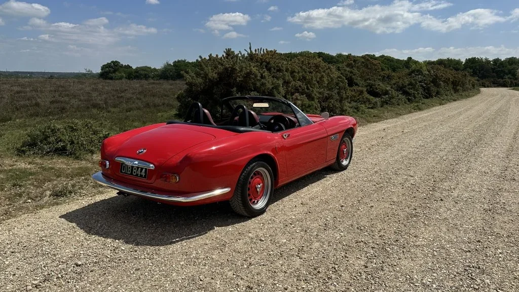

What's the colour?
Looks good in the photos; the panel gaps and shut lines look very even.
Dxbolton
Jun 19, 2020
119
New Forest
2.8 auto
What's the colour?
It’s BMW Hellrot Red.
There’s a distinct orange tint in some sunlight situations, almost pearlescent, but it is the BMW colour.
i be spent a long time getting the gaps right,and it’s paid off.
I’m very happy with the result

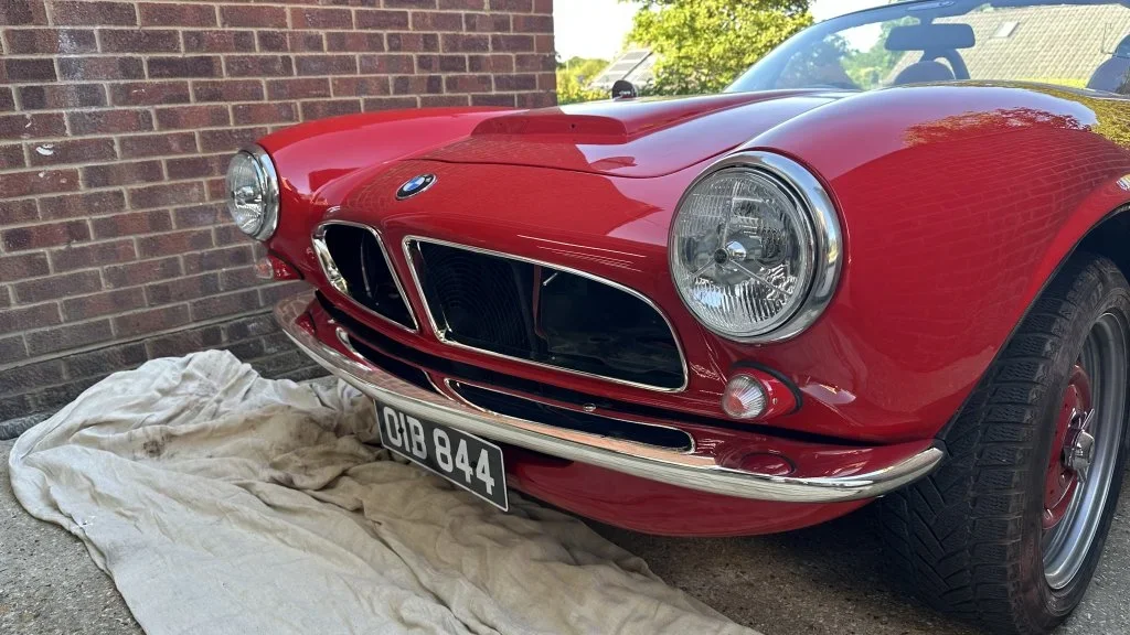

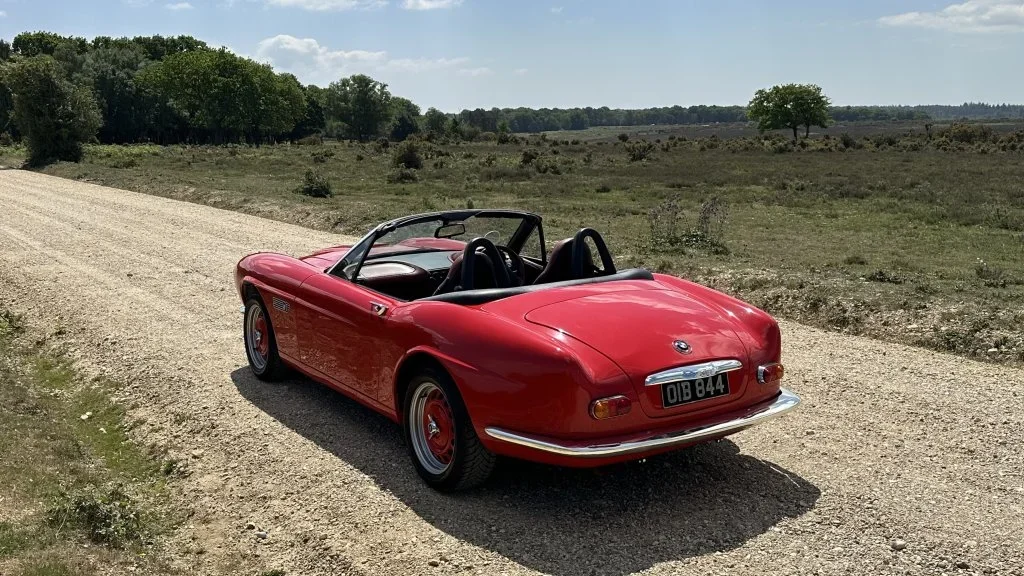

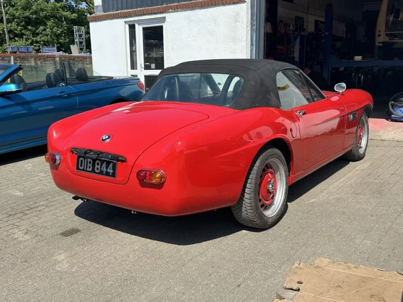

All the important bits now refitted
Pond
Dec 26, 2016
144
Spaldingski, Lincs
3 litre Z3 pretending to be Italian exotica. Two previous E89 Z4s.
Dxbolton
Jun 19, 2020
119
New Forest
2.8 auto
Looks very, very good. :thumbsup:

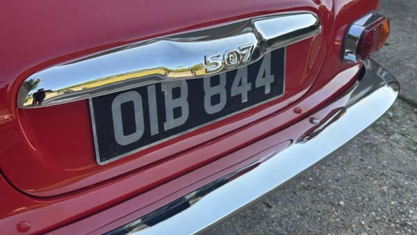

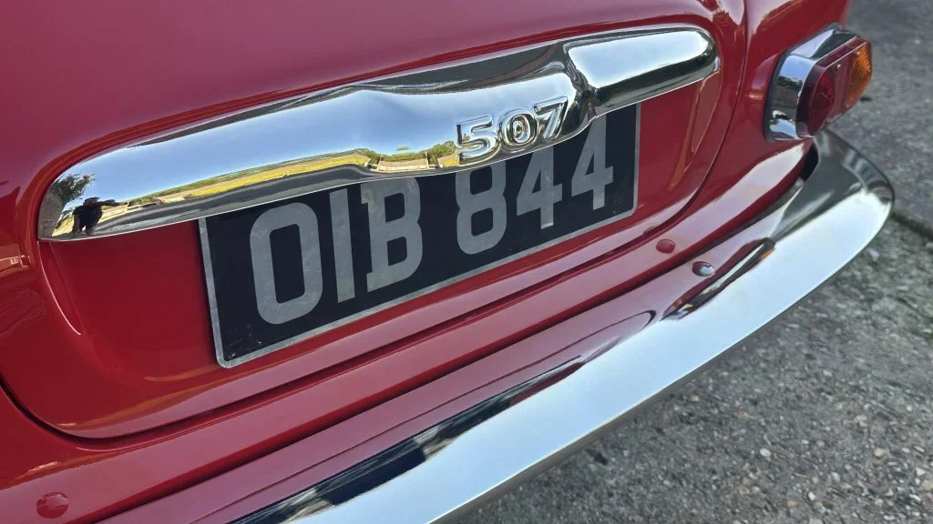

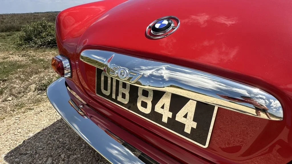

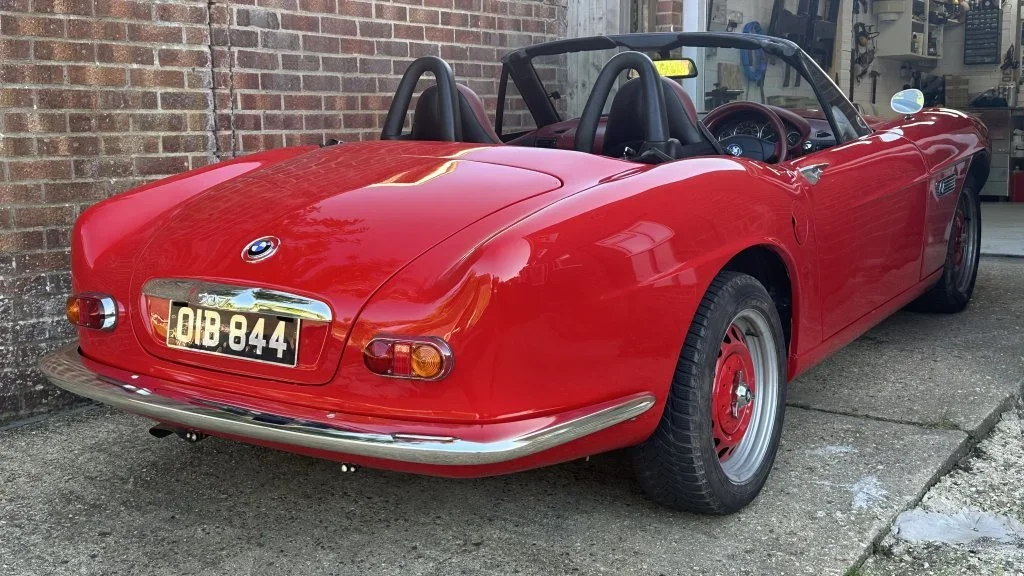

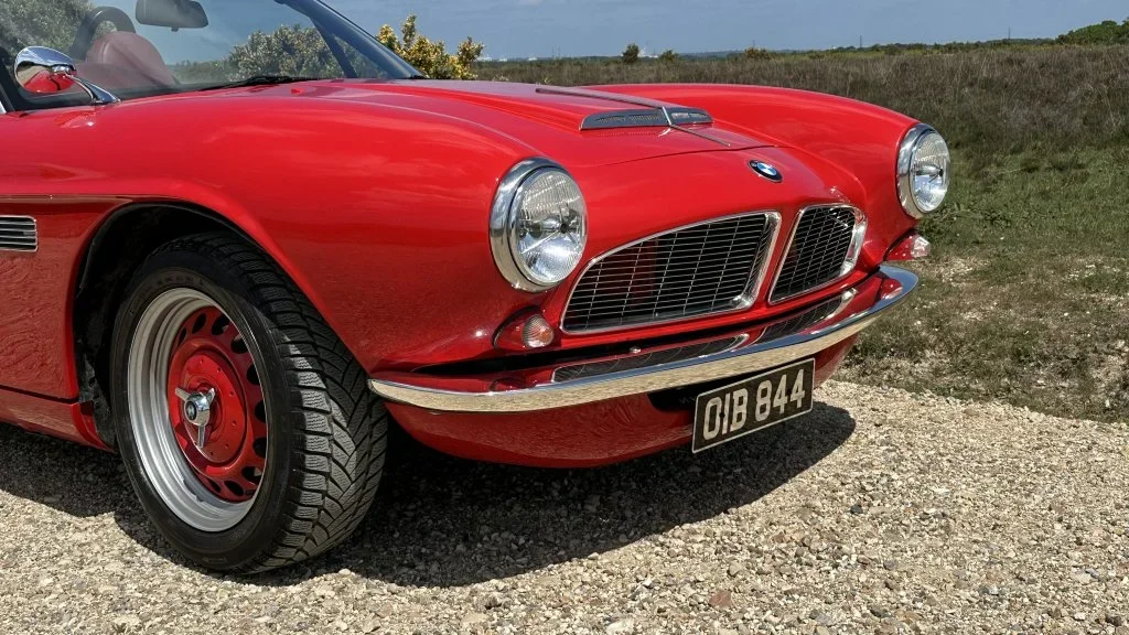

Are those the GRP bumpers, etc chromed?
Yes, boot handle, bumpers, and grill surrounds are all GRP supplied with the kit (boot handle was my design) from Tribute and all chrome painted by Wayne at Chrome Finish.
The size of the rear bumper is a challenge for this process but he’s done an excellent job,
I don’t think many people will realise they are not metal

That’s chrome finish looks good. I noted your number plates, can you actually use those on the road as the vehicle is not that old?
Yes you are allowed to use older plates on any car. What you cannot do is have plates that make the car appear newer than it actually is.
