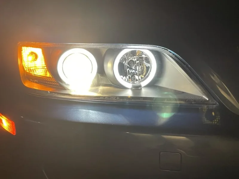

I got some complete headlight units from Amazon recently, complete housing with xenon bulbs, projector beams, and LED Halo ring lights. The inside of the units behind the clear lens is black, and it looks very good. Not really expensive either. About $200.
I wired the halo ring lights into the wiring that lights up the front side marker lights, so that the halos light up whenever the side markers come on, even if the headlights are not on.
The previous owner had put in some HID retrofit ballasts that I had to remove. They drilled holes and used zip ties to hold the ballasts in place, but it was all not working and was messy. This solution works well.

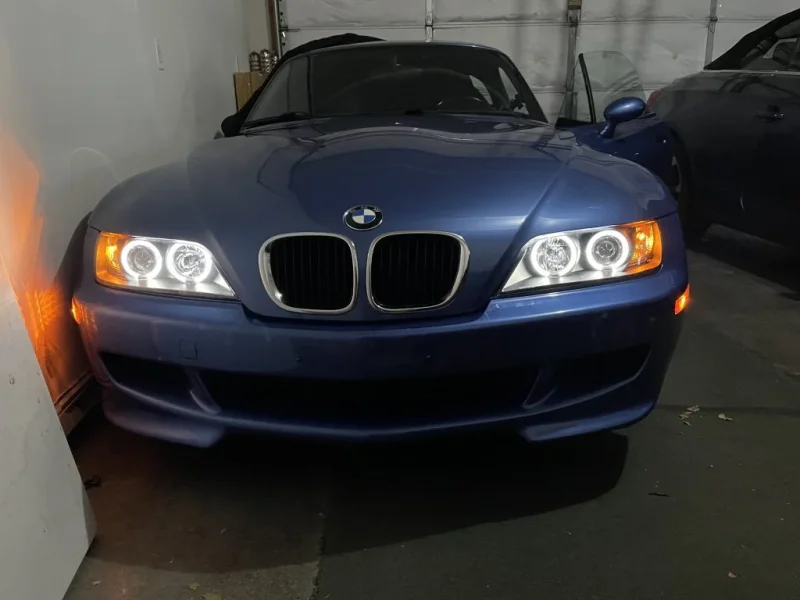

Where are people tapping power for DRL with halo lights.
ExMX5owner
Moderator
Staff member
Global Moderator
Australian Zeds
Aug 31, 2022
126
Queensland, Australia
99 2.0
Cant remember now, I think I dropped a fuse tap onto the stereo fuse, to come on at key 1 and better, those are LED DRL,s and draw very little current, wiring still hanging out of the front of the car in this pic.. Driving it around a bit like that cleaned up that mess.... =)).
Did it a couple of months ago and not had an accident since, so they must work...:whistle:But put the fuse tap in the right way round, if you dont, blowing the original value fuse will take the out piggyback too... If you do not have a multitester to check what side of the fuse socket is hot, no big drama, but if its arse about face pulling stereo fuse will knock out the DRL,s too.. series v,s parallel ...So just turn it around the other way... Job done... I can post up the implementation of a fuse tap on my Z if it helps you, but there is plenty of info on the interlink on this topic...
Edit: If you choose to go that way, get a low profile tap, so the cover can go back on..
