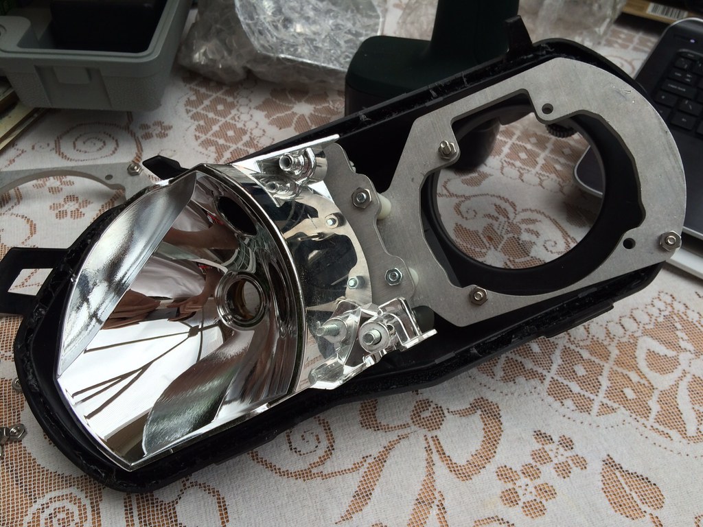

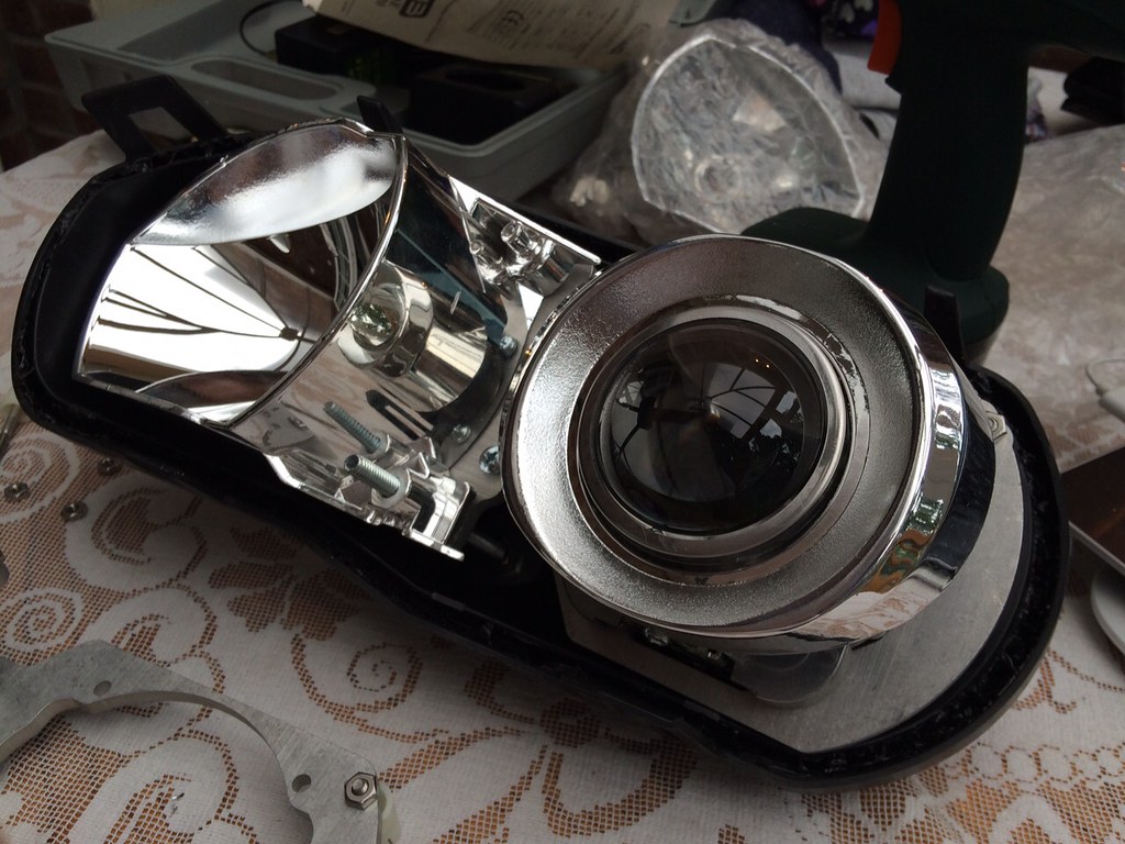

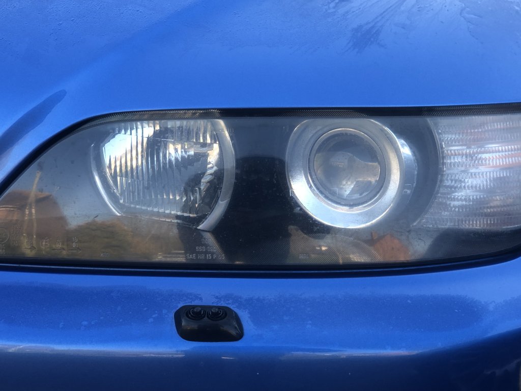

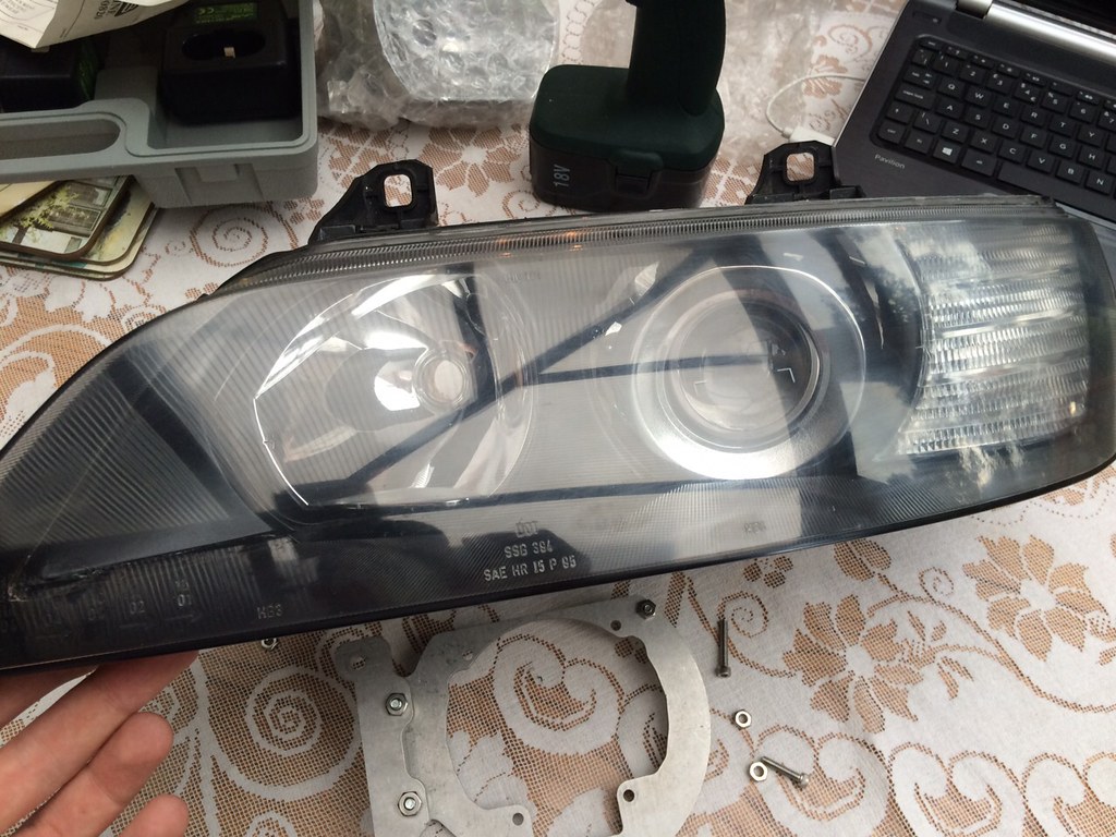

Mine were modified with xenon units. They are extremely powerful and also fully road legal.
They look like this:
Some pictures of the modification:
