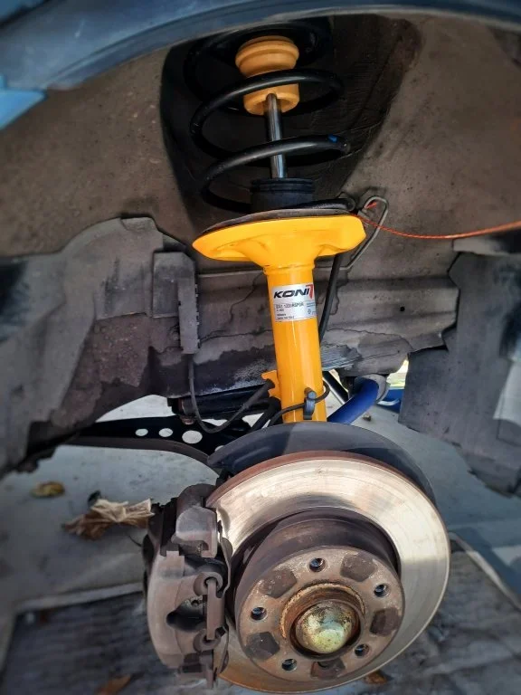

I'm going to hate myself almost as much as you will hate me for mentioning it but I think your front bump stops are on upside down. :(
But, FWIW, I don't think it makes any real difference.
Yeah it can go either way...word on the street is this is a bit more progressive...not sure I believe that but went with it anyway.

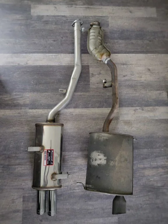

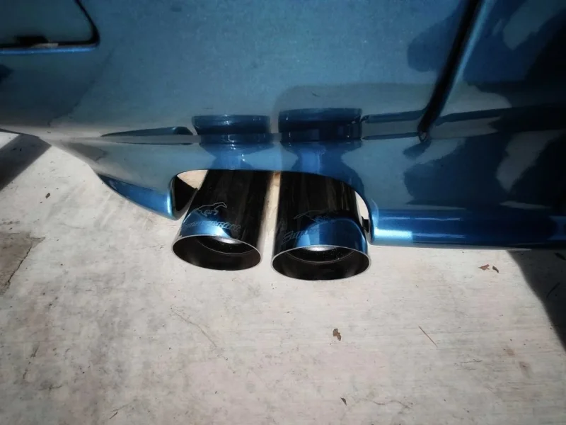

Supersprint Performance Race Muffler installed. It took about three hours start to finish. All the nuts came right off since the car has zero rust. It's super easy to change out...two bolts at the cat, three hangers. Just a lot of up and down and moving/sliding myself around to get everything in line, etc.
Love the sound. Burble---ee but not too loud, no back-firing noises....yay! Maybe a touch louder than I expected, but it's so hard to tell on Youtube. One caveat they don't tell you...ya need the connecting pipe and a Walker 31370 Exhaust Pipe Flange Gasket!
Your description sounds a lot like the Magnaflow cat-back I put on mine. A bit louder, but a wonderful burble with no pops or crackles.
