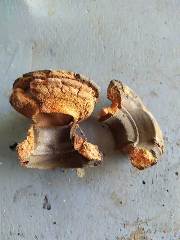

The bump stops on my Z3 1.9 Roadster were missing on one side and completely perished on the other. Missing or non-functional bump stops are not a reason for a MOT failure in the UK, but they can damage the shock absorbers and other components if the car bottoms-out. As far as I know, you cannot buy or replace the suspension bump stops without replacing the whole suspension strut.
I'm surprised the above was still present !
