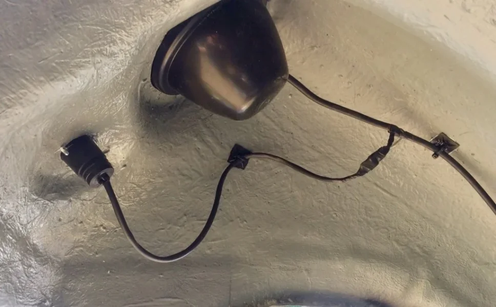

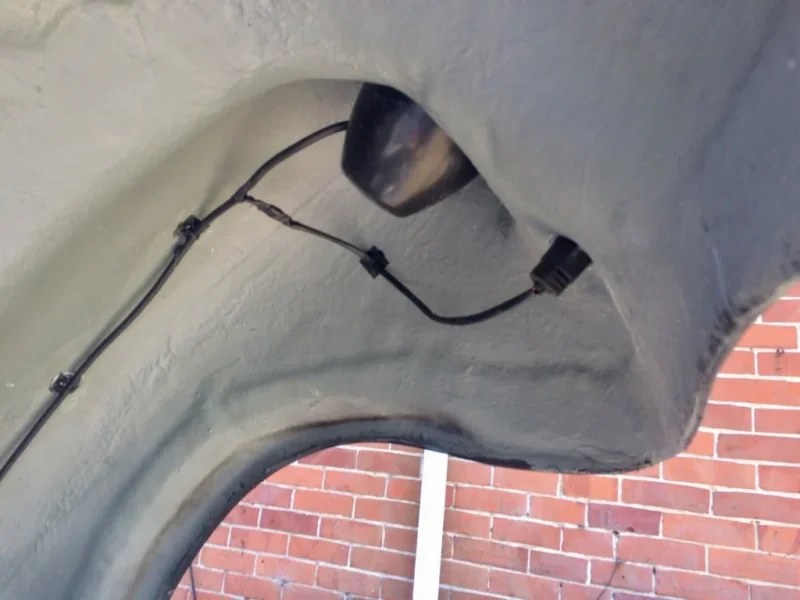

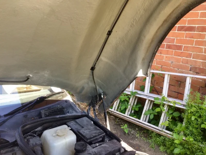

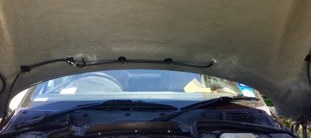

C94482A0-A632-40BC-921B-906F71B4A635.jpeg 71CBFE5B-1D58-4C75-B952-CE334E442A81.jpeg 4FC73661-74A2-4988-A8CF-9A3CD685E7AA.jpeg 1E9EDA04-671D-4E83-ABB8-8E39BE80E1B7.jpeg For those who wonder how do we get the lights working on the bonnet when the wiring to the headlamps and indicators are on the front slam panel. In my case I used the correct ampage 7 core trailer wire and ran that extension from the existing connections. Along the side of the wings/engine bay and then under the bonnet. It is fixed up with square cable-tie holders.
Washer jets done in much the same way with the exception of changing the jets to something more chrome than standard.

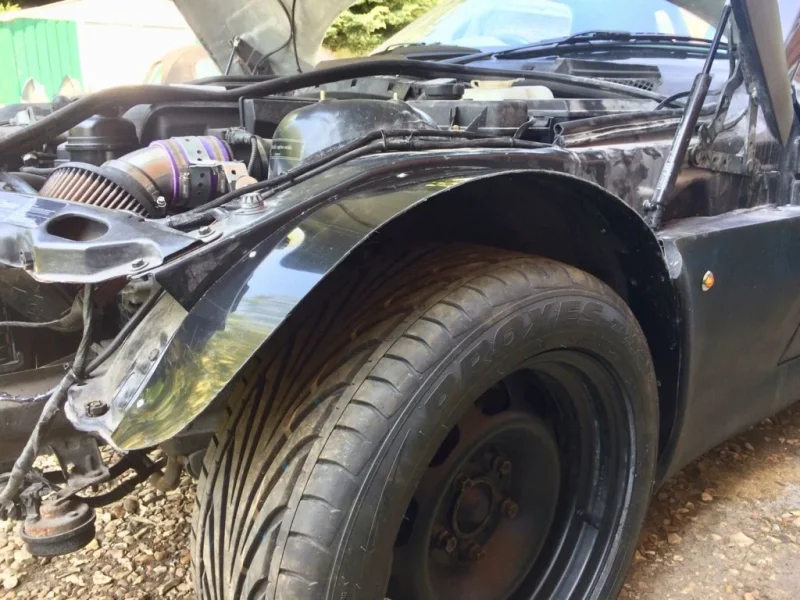

Inner arches next. The rears can either be done by making a template and making a piece of 2mm polypropylene to fit. Or adjust the old rear arches to fit. This is the option I chose.
Front inner arch is a templates sheet of black 2mm that runs over the top of the wheel and drilled riveted in place. Bit of a faff if you don’t have the template. 5BE8B9C3-00D6-4C89-AA93-2F8CA9251F57.jpeg

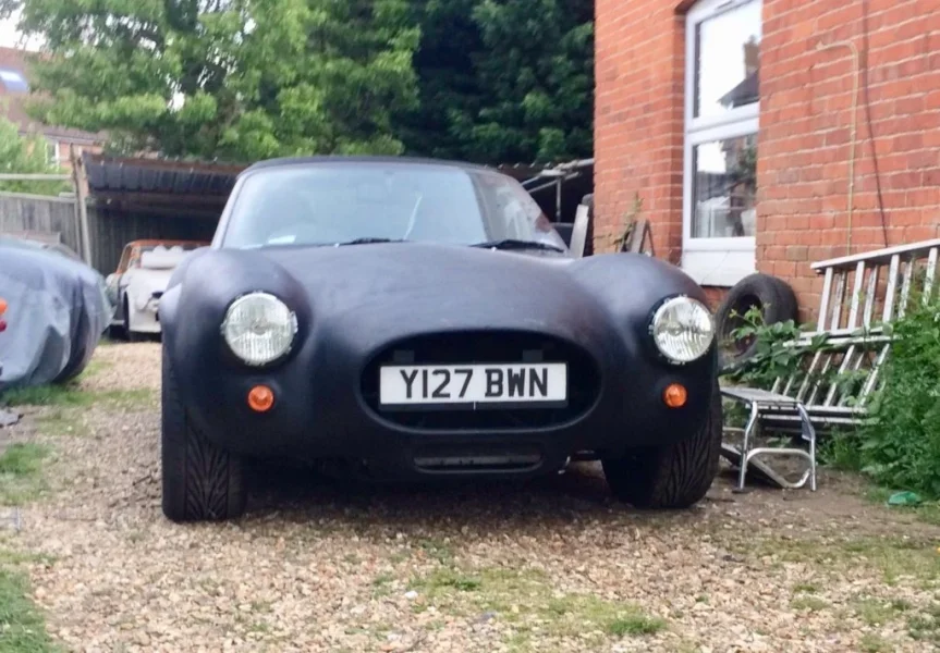

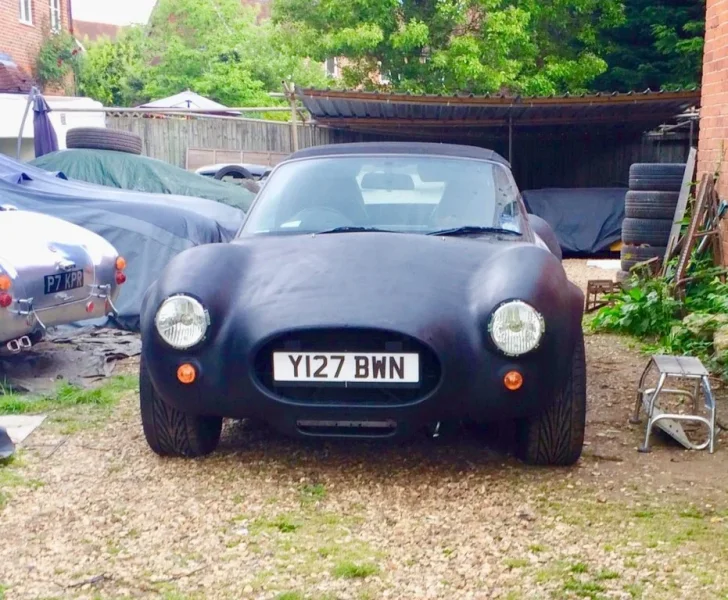

Last post today. Fitted the front number plate smack in the middle of the opening. It does four things:
Sits in a good place and is vertical. Stops me needing to figure out what grill suits it best while I enjoy the car in the summer :) lets me get the MOT to enable this. Allows me time to wait for my new registration bought at the weekend to be transferred and then decide where the shorter plate fits.
No show plates !

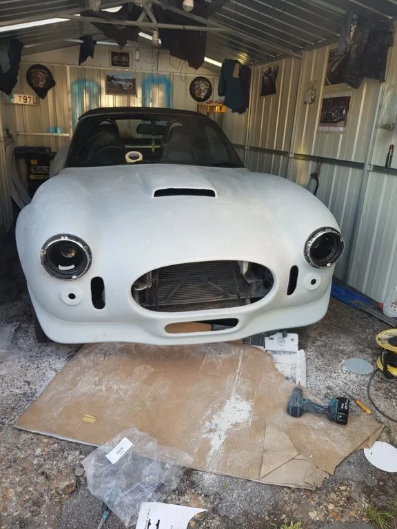

Heres mine
View attachment 80618 View attachment 80619 View attachment 80620

I agree Sean. No offence taken in any way. Mine is a Kobra not Cobra.
That said I’d rather have mine than a replica with a 2.1 Pinto running on Sierra running gear. I have a decent hood oh and it will (probably) pass emissions.
On the subject of stick plates. They are bordering on illegal I think so wouldn’t have them. White on black for a post ‘73 Car is definitely asking for a pull by the boys in blue too I expect.
Mine is down and dirty and basic. It will do ....

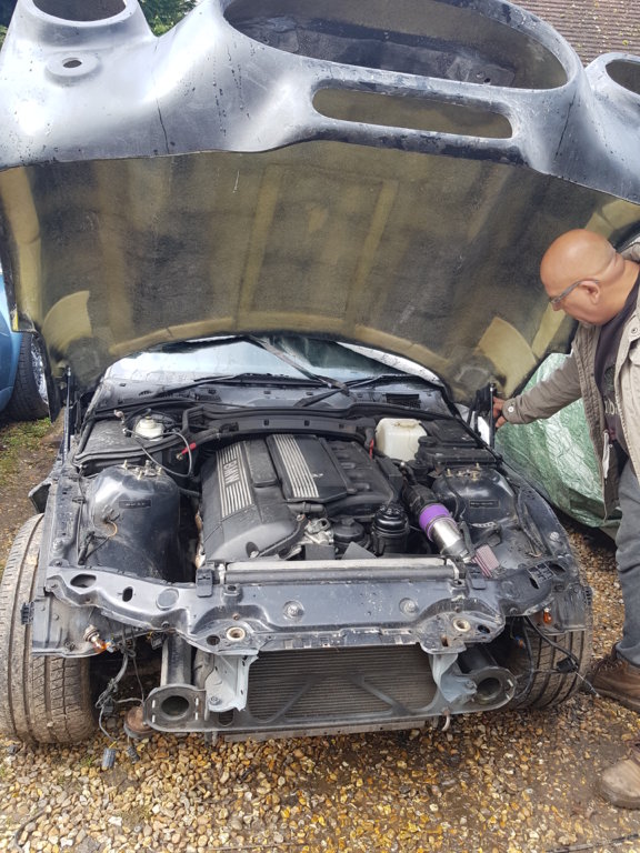

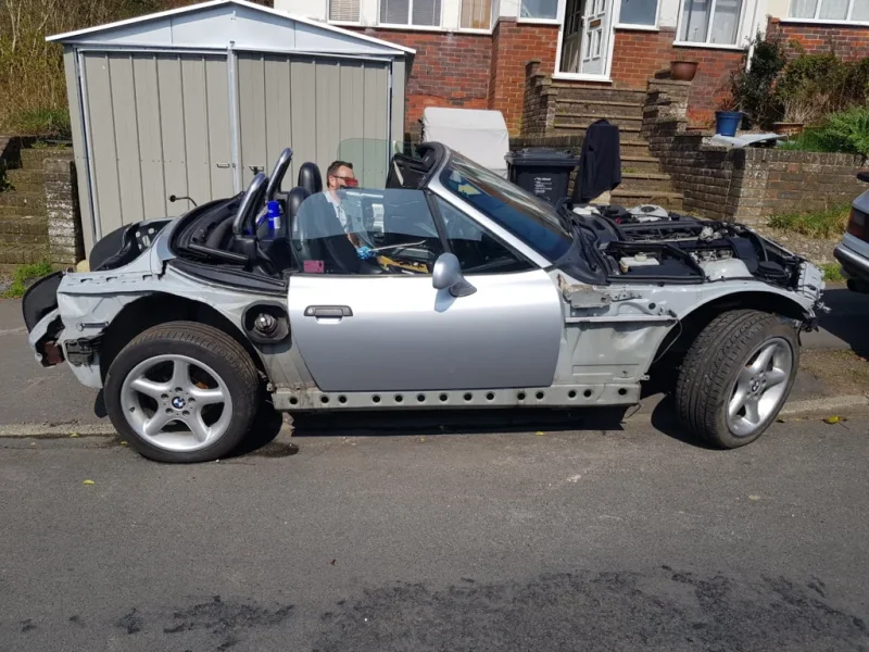

Cheers bud and to you. I picked the kit up on Saturday 31st March. I am down in Brighton20180331_132956.jpg
Being shown the bonnet attachment on your car and being told do NOTTTTTTT do the catch up tight before getting it in right position or it will never open :)
