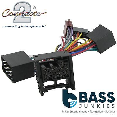

The amp comes with its own loom with ISO connectors. You then need a T connector loom between the headunit and car. I plan to use this one (it has round pins) between the cars loom connector and the adapter loom the Bluetooth kit uses. It should all work but I have not tried it yet. I have used the same amp and connection method in my Smart Roadster and it works well. The amp even takes its power, earth and trigger from this connection.
