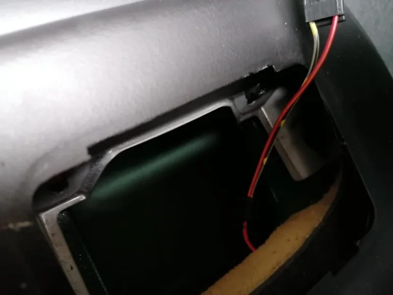

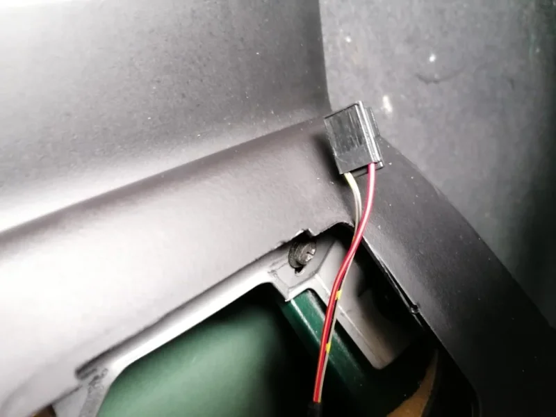

I think I may have found a wire for a central sub but not sure - hoping someone can identify it - I found it at the rear of the central console under the little switch panel between the seats. Unless its for the rear delisted, but looks a bit too fine for that.
The colours look like black/white with yellow triangles? and red. Going into a tiny connector
Any ideas?
Thanks

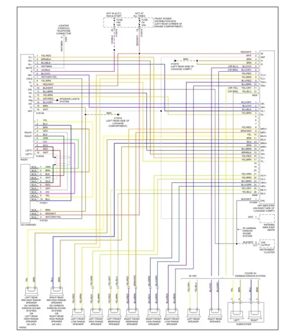

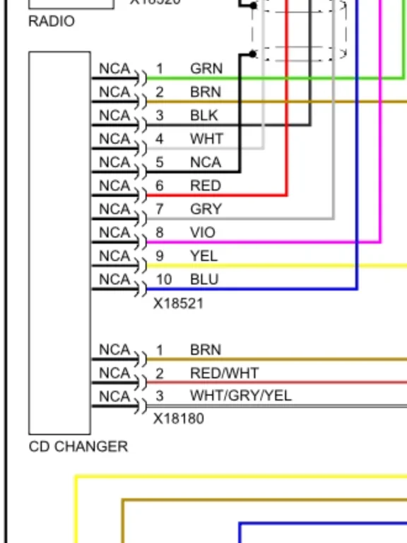

This diagram shows a red-white and a white-red-yellow cable coming from the source and indicates that these are for the cd-changer.
if the plug looks as it could fit to the cd changer, then this cables serves this purpose.
if not, we have to find a better and simpler diagram to look at.
i can look at some sites I found during my search, but only from cable colours would be a real pain. Can we see the plug pins or slots?

Better analysis Of the cd changer wires. I can see a black and white.
subs, and woofers are yellow, blue and brown. No black.

This one shows the plug better - it is not the usual white one I can see in your pic above - this is black and flat as seen below. 2 wires only. it "could" be white/grey/yellow and a red one.

Took me a while to find it but here is a diagram for bypassing the amp, remove it and then throw it in the bin, it's as much use as a chocolate fire guard.

Ive reached my limit of ideas, can not guess. Never seen it before. Someone with a cd changer may enlighten us.

Looking at your diagram, and the colours of the wires listed - I think it is missing the brown wire from the set perhaps, as I can't think of any other reason for a multicoloured wire of this type that is definitely not amperage rated - too thin.
