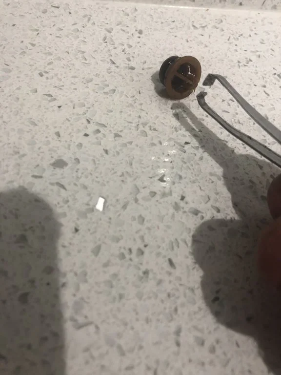

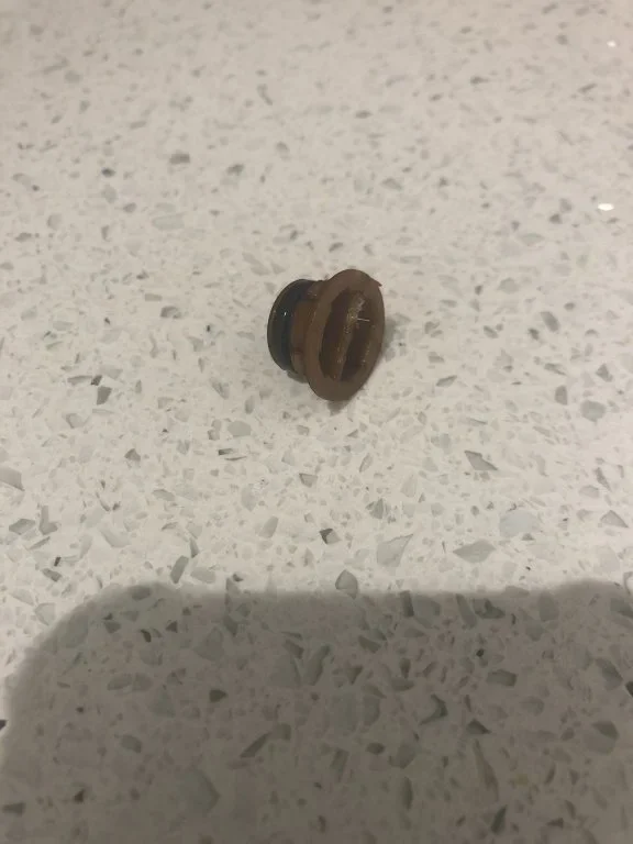

Hello Martin,
I have just purchased the exact same kit from X8R and changed all of the seals today, I have literally just finished the job.
It's a fairly simple task, the only problem I encountered was once you have removed the allen head nuts from the end of the cams inside there is a small plastic cup with an o ring seal on it, oh dear what a pain to get them out especially the lower one, I made a little tool to remove them, I got a pair of small normal tweesers and bent the ends in a vice to act as a claw, after several attempts I eventually got them out. If you use the same idea make sure the end is bent small enough to get inside the plastic cap, to grip onto the central bar, as in pic.
The caps are recessed inside the vanos unit, an inspection lamp with a mirror to see inside the ends is also useful.
There maybe other options but this is all I could think of at the time.
Hope this helps
See pics
