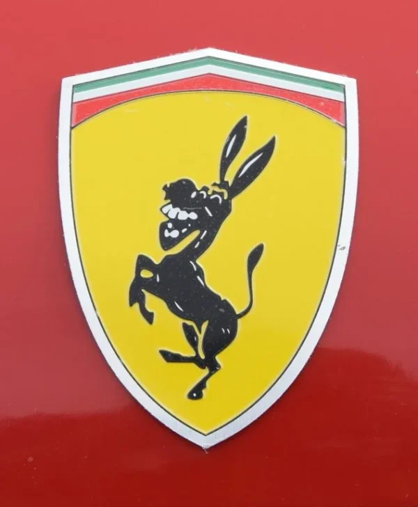

One of the guy's in a local car club has this on the front of his 1990's Suzuki car. It was found on E-Bay.
Maybe its one way to have an authentic looking replica and a bit of fun with the Fezza people.
They are a laugh, you can also get a Prancing Moose for your Saab or Volvo!!!
