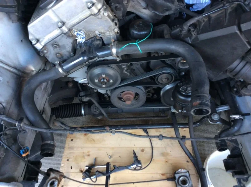

Meeting @ZedHead has obviously has had an effect on me, as every time I go out to the car, I keep taking more off. =))
Stripped the bonnet and front bumper, removed the radiator as it has to be replaced, and thought while its like this might as well swap the camshaft sensor. Got it stripped out, but found a few bits that need to be replaced, No point rebuilding it until I have all the new parts.
The bit of string is so I can pull the new camshaft sensor wire back.
Remembered to put some rag over the holes to stop any crap getting in!!
Bought some 1mm cutting discs and cut off the seized mounting studs from the Power Steering loop so now ready for a bit of a refurb.
So I think that’s as far as I need to go on the front end now.....so for the next day or so, cleaning, derusting where needed and painting bits and pieces.
Then start on the rear damage, which is nowhere near as bad.
For those that didnt know of the bumper height adjusters you can see part of the plastic insert sticking out. The other end has a hex (same size as diff) not that I can adjust them as the are locked solid in the shock body.
