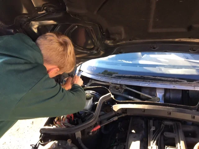

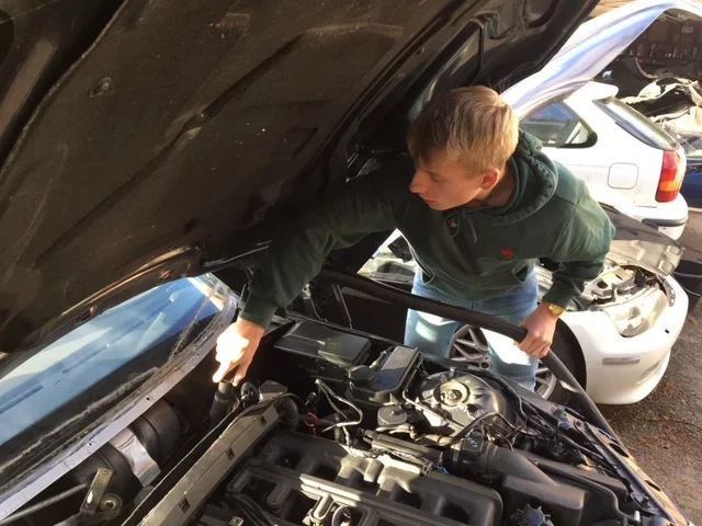

We managed to get a small window to work on the car yesterday.
The very last of the main loom connections were completed. With the main focus being the windscreen wiper motor onto the loom connector. We'd previously struggled but eventually won getting the loom side mounted onto the bulkhead. The motor to loom connector was easier but still a struggle.
The water valve was also fiddly but the answer is to drop the bulkhead cable management bar. We also connected the wheel sensors and side indicators. As well as the alarm siren.
The audio loom was dropped in. And we adjusted the positioning/seating of the main loom and ratcheted up most of the cable ties into their final positions. We're not quite finished there yet but only needs an hour or so more. And changed the bulbs in the heater control panel.
We're cleaning all the normally hidden places as we go. Here's James cleaning the area under the windscreen scuttle panel. Before bolting up the windscreen motor and linkage.
