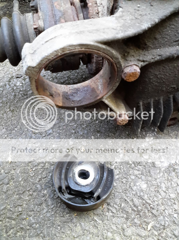

Back to work this afternoon. The sub-frame is now out.
I broke two drifts trying to remove the handbrake cable and then just chopped it as the Nefyn cat says above.
The diff bush inner parted from its casing with almost no effort which may explain things. The sub-frame bushes didn't look as bad as I was expecting to see but when wiggled with a rod you could see the inner metal core was separating from the rubber part of the bush.

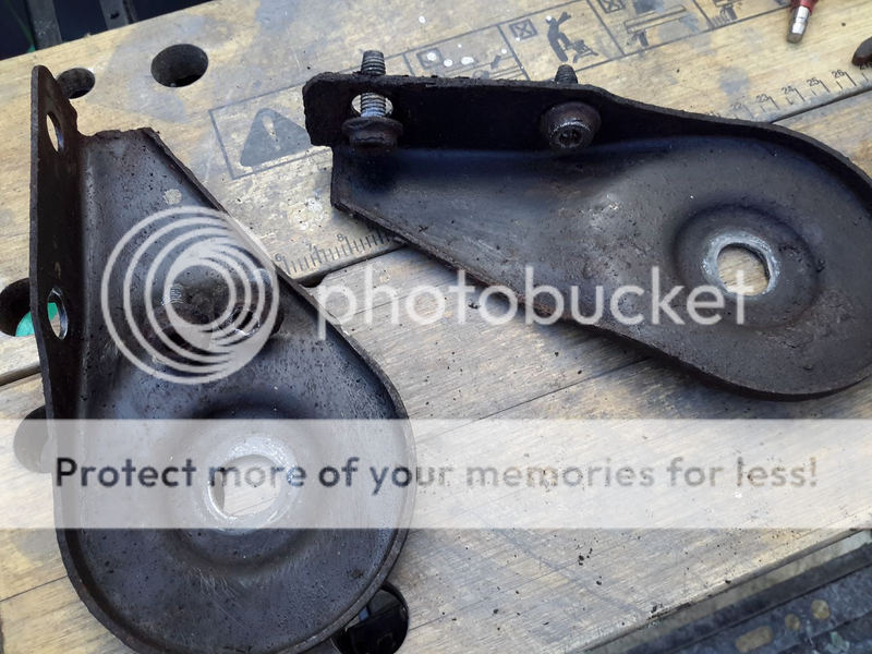

The bolts holding these sub-frame plates to the chassis were a pain to remove due to the rust in the hex. I would like to replace these but they are £8 each on Ebay!!! I'll see what they look like after a night in rust remover....
Why not replace those Allen bolts with some ordinary hex head ones Steve. I could never understand why manufacturers use those stupid fasteners where there's ample room for a "normal" bolt.

Wound up replacing the four small allen-headed bolts on mine, they weren't much from BMW, got the feeling they may be high-tensile types, don't know for sure but they could be under a fair bit of load at times (loony cornering mode). The big subframe bushes will come out with a bit of hacksawing either side of the dimples in the subframe, then collapse them a bit with a long thin chisel and they tapped out on mine. Used to do something similar on lorry spring-eye bushes back when I had a proper job.
Actually that's what I thought too and ordered some last night!

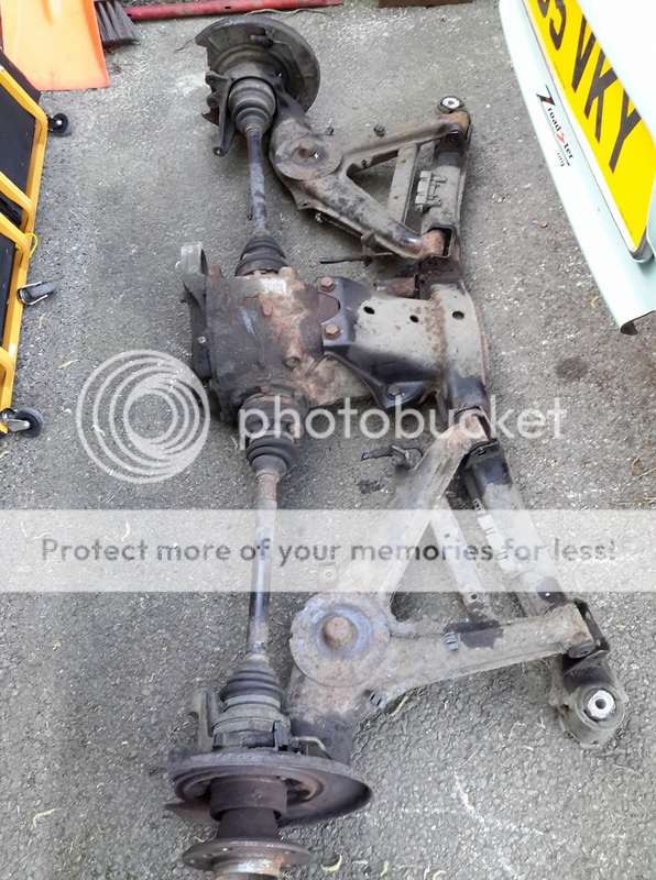

The rear axle assembly is now rebuilt with new bushes and is ready to re-fit:
The SuperPro trailing arm bushes were harder to fit than I expected. Because they have a flange at each end, you have to squash them to get the end in the eye and I could only do this with pressure from both thumbs. Maybe me getting weaker! I took the beam to the tyre place near my house and they pressed the sub-frame bushes in while I waited - about 10 mins in total! As I'm replacing the brake lines from the ABS unit to the calipers, I'll get the main lines in place before I re-fit the rear axle - much easier when you can get at everything.

Steve well done mate your doing a great job there, I done the exact same job last year ,and the back end off your z will feel kind off new when finished,iff uve not refitted the new diff bush which isn't truly round,can be tricky without a hydraulic bench press , but can be done done with a large vice and a few swear words along the way.but no pain no gain , Stella job ure doing there!

Some great work Steve, are you painting the Diff. itself? Also what are you doing with the brake back plates, cleaning and painting when the axle is back on the car? IF the back plates need changing due to corrosion (of the holes where the shoe hold down pins fit) now would be the time to do it.
