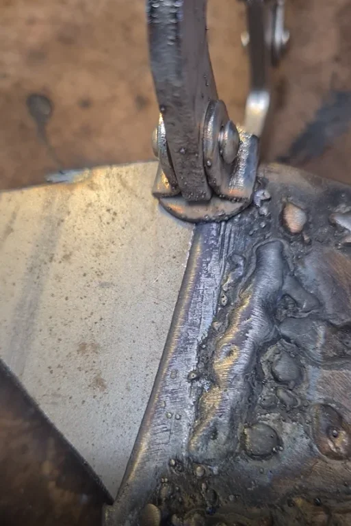

so all my welding stuff turned up.... got it out the box, set it all up... set my brand new helmet up.... and this ..... is my my first EVER weld !
don't think I'll be attacking the sills just yet !!!..... but... might be able to weld a nut onto the broken bolts on the trailing arm ! :D =))
Reminds me of a song from a few years back, "Things can only get better";)
Trying to weld something that thick you need the power almost fully up. And don't be surprised if the machine cuts out. If I were you I would start by practicing on car body thickness steel, as that's your ultimate aim? Clamp it tight together too.

second day...second attempt...... took my time this time... made sure the metal was clean and played around with the settings a bit more
and managed to win an Award !! *cough*... *ahem* =)) =))

Actually, that doesn't look bad. Well, the first one looked a bit rough but once you got the hang of it it's OK. Mig welding isn't rocket science. What does need a bit of skill is cutting out the rot and making up new panels to fit.
I like that your welder has separate power and wire speed knobs. Mine is an old Sip Migmate around 30 years old with just two power settings and the feed rate is fixed based on whatever power settings is chosen. It was OK when it was new but it struggles now. On the low power setting the feed rate is too low. On the high power setting the feed rate is almost OK but if you're not quick it burns through anything thinner than 1mm.
Be sure to post pictures of your sills when you're done to review that welder for me.

Thank you mate.. as you can imagine....and see !... I'd never even touched a welder before yesterday afternoon... it's also a flux core welder and apparently they're prone to "spit"... and I will use that as an excuse !... =)) ...for the 3mm stuff (the right angle weld) I had the voltage nearly all the way up...and "pushed" in circles....I have read that for flux core you should drag, so I might try that on my next outing....

A bit more practice and you’ll be there, not too shabby for day 2 attempt.
Thank you mate..... guess it helps there's only two control knobs (voltage and wire feed) and it's quite forgiving.... I'm not going anywhere near the car until I have a decent technique down
The main things to consider are clean metal to be welded a keeping the joints as tight as you can. Plenty of tack welds and tap the joints with a small hammer. A big hammer will only make the joint close up then bounce open again. My favourite welding hammer is a flat pain carpenters hammer of about 12oz weight.
ps. 2 controls are all you need, and practice. Looking good 2nd time around Matt.

Welding car body panels isn't the same as thick 3mm steel. Most car panels are 0.8 or 0.9 mm BMW inner sills are a bit thicker I think but do some practise with thin mild steel

cheers Tony.... yeah I'm learning all the tips and tricks and found out what happens when the joint isn't tight.... it just balls up and falls off ! =))

yeah I think the Sills are 2mm... luckily I don't have any bodywork holes, just two 50p size ones in the offside sill .. which I'm HOPING, I can fix !

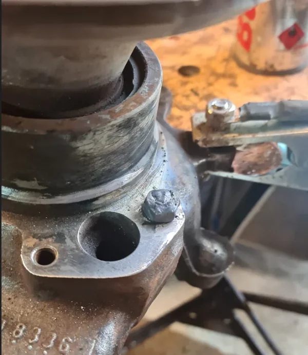

decided I was then brave enough to try welding a nut onto the trailing arm broken bolt.... quick practice first.... then it was time to brave a welded nut
did it work ????..... no...... =)) =)):whistle:
ended up trying 4 times.... each one snapped off :whistle:....top photo is my practice one...
tried adding weld.. then adding a nut..... but still no Bueno
all I ended up doing was hiding the bolt ! =))=))
so it looks like I'm resigning myself to taking the hub off... drilling and tapping the hole.....:oops::oops:
