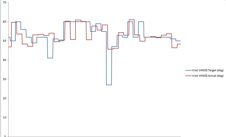

I'm not a C++ programmer, but I have dabbled in Visual Basic and I was able to produce some graphs that make it very easy to see what is going on with your car. Both the TestO settings and the graphs need some tweeking, but I hope that you can see the possibilities, because I can.

Exhaust VANOS
This graph (and the Inlet VANOS graph) can be used to see if your VANOS is working - and if so, how well it is working. If the Target VANOS graph is moving, this means that the ECU is sending a signal. If the Actual VANOS is moving, this means that the VANOS is working. How closely the Actual follows the Target tells you how well the VANOS is working. You want the lag to be as small as possible, but a small lag is acheived by having loose diaphragm springs. If the lag is excessive (as seen on my Inlet VANOS graph below, the diaphragm springs are possibly too tight - but I do have a much quieter engine. It's a compromise!!

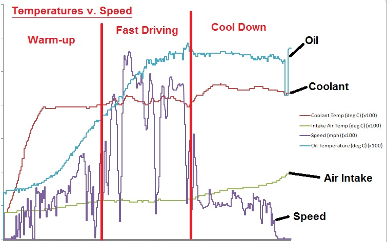

Temperatures
This is very useful if you want to see the effect of modifying, such as fan delete or ceramic coating the exhaust manifold.
I've always cooled the car down after a hard drive by taking it easy for the last few miles. The evidence on the graph shows that I am actually heating the car up!! It would seem that in the cool-down phase, the oil temperature drops a little, whereas the coolant temperature and the air intake temperature increase significantly. I want to do some more experimenting to see what effect different actions have on the temperatures.

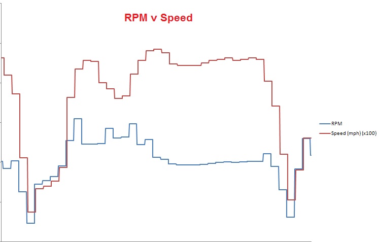

RPM v Speed
This graph would show how good you are at changing gear. The sample rate in the example shown is too low, but if I could download at 100Hz, I would be able to tell how much my acceleration slowed down when I changed gear (for the anoraks amongst us, not only should acceleration (a) be high, but ideally da/dt should also be as smooth as possible). Varying da/dt is usually shown by your passenger being flung forward in their seat when you change up. Ideally, they should be pinned to the seat during the gear change as well - this is impossible in a single clutch car.

Interesting that oil temp takes a lot longer than coolant to reach its max and notable that coolant blips upwards after you ease off.
