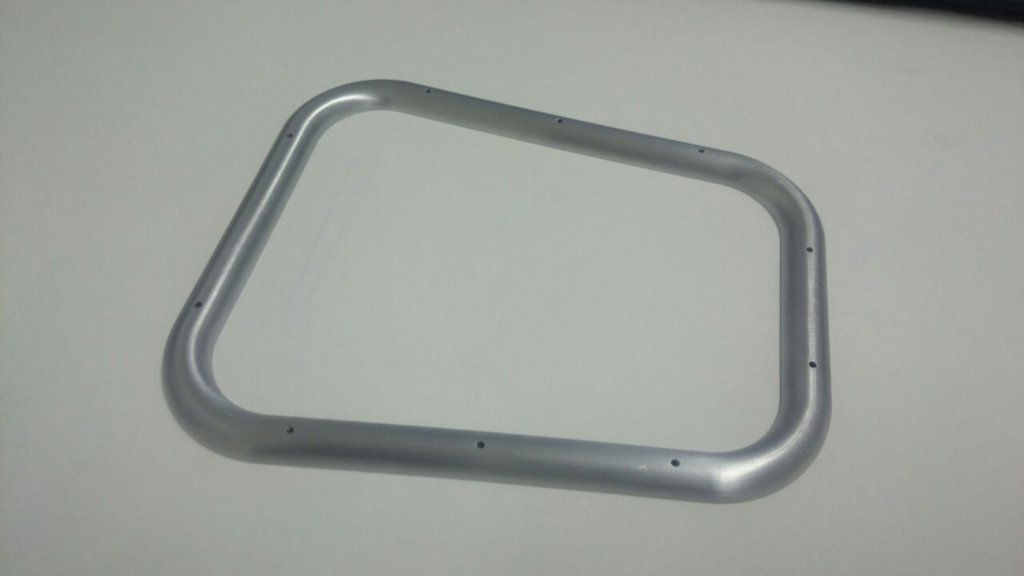

I am so excited about collecting the tops for the gearshift surround.... See pic below - He sent me that this morning before he had done the little recesses for the screw heads... He drilled and threaded the 10 holes to anchor the part to a base plate which then was held in the CNC machine whilst it cut the radius across the top...

More good news, I collected the screws today. They finally cleared customs....also, got around to applying a sealant to the new B&D Workmate jaws I made, completed now including the V routed down the length of the inner edges for clamping round objects...
Thats looks excellent Barry, can't wait to get it on the new console,
