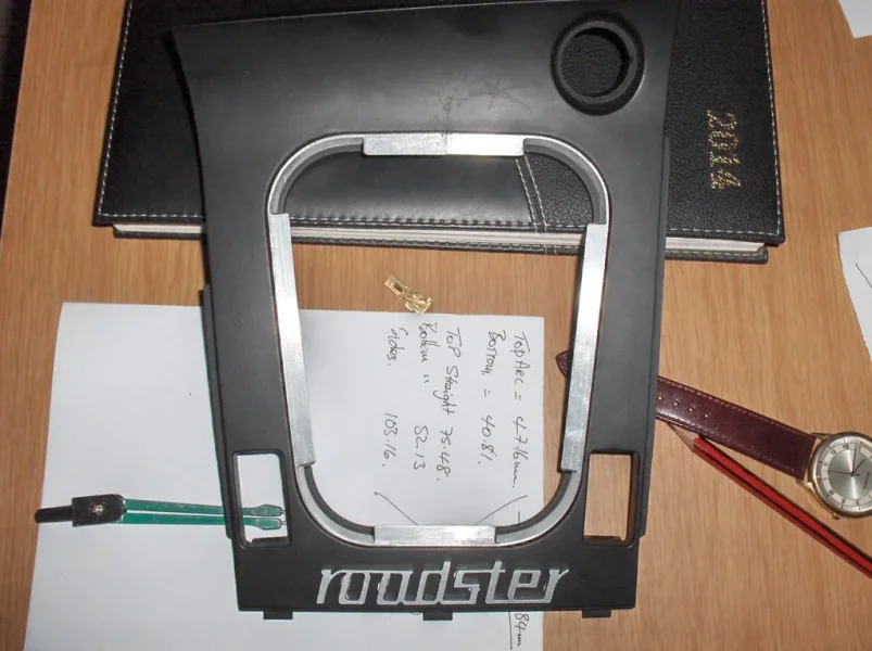

Also made a small adjustment to the gearshift skirt fitting - I needed to widen the top flange to provide enough room for the two screws that fit there.... So now all 100% good. On monday, I'll pop up the road to a sheet metal working outfit that does guillotine work and have the ally skirts trimmed to the right size. We can only get 12mm x 25mm unequal length extrusion as a standard here.... I need it to be 9mm x 14mm, so I'm hoping these guys can save me some boring trimming with a hacksaw. If they can, that will cut the production time of each skirt to around 10 minutes, and it'll be a lot neater than my hand tool efforts.
Also on monday, I'm hoping to collect the laser cut surrounds - the guy who does them cocked up the first lot. I shan't go into detail, but it was a pretty elementary oversight on his part... If I can get them on Monday and drop them off at the CNS fella, I may be lucky enough to have them all radiused by the end of the week. That'll mean I can spend the weekend finishing / buffing etc etc... and drop them on Monday with the chrome plating guys... So really another 2 weeks to go before they'll be ready to post.... That's conditional on our 'kin cutoms people getting my screws cleared and delivered to me.......... But all fun in the end..
.View attachment 44907
Is that how you formed mine BarryAs soon as I have one completed I'll post all the pics.... It'll be a week or two still though. Unfortunately I have to wait for other people to do their part. I'm really happy that it requires less manual labour on my part though. If I can get someone to guillotine the ally extrusion to the size I want, it'll mean I can knock out the base frame in around 15 minutes including cutting, shaping and a little bit of filing to smooth the cut edges....

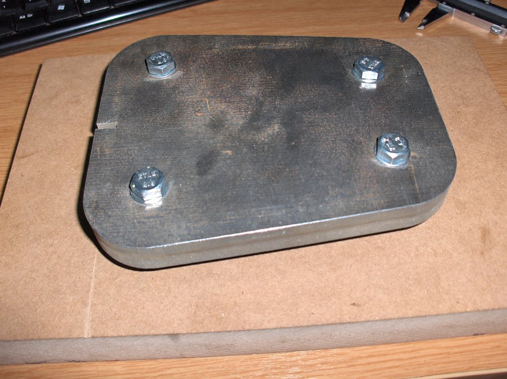

Here's the bending jig I made to shape the frame that fits into the console hole...The slot in the end is where I lock a little "ear" which holds the one end in position while I bend the rest around the jig...the ear gets cut off afterwards
