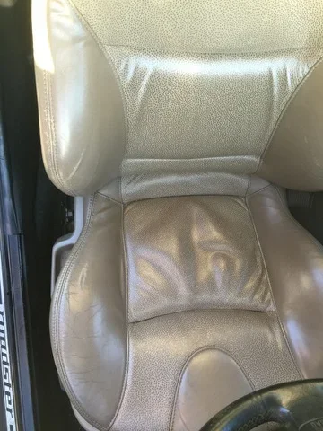

Will give it a go and let you know have already had a go with some of the stuff i had and the difference is great. Heres a pic of it when i got it both drivers bolsters showing heavy wear the pic i previouz posted isn't great but you can see the damage has gone and coloured.IMG_6284.jpg 20151120_155340.jpg
Will get better ones but its very simple to do.
The colouring has made a vast difference shiney to matt but a more solid colour.

I'd say the bolster wear is almost the same as mine. Wouldn't mind getting rid of the dott effect myself.

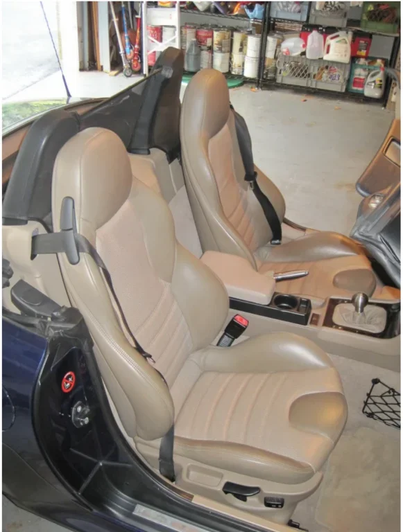

Hi Ant here's a couple of pics so you can see what BMW did as regards black/beige.
A little more black along the sides of the console and over the dial binnacle (plus a Raide steering wheel) I feel is needed and will get around to it sometime, let me know how you get on with the dye. Good luck mate. Roy.

To make sure my post doesn't get deleted for being off topic, I think the two tone beige will look great. Will be very much like the older standard beige combo of the beige with a slightly lighter beige ostrich textured Insert. Also @Rha if it wasn't the Z "it" could have ended up looking like the black and blue Sport Seat! JIM

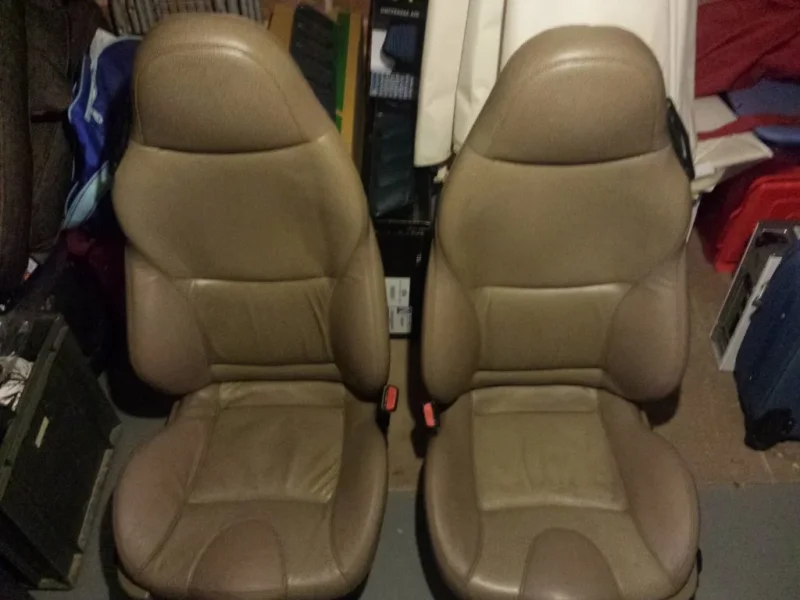

Have decided on this colour combo
Its standard Oregon i think but never seen it that clean but looks smart

Looks good Ant - bit of a b****r to keep clean though.......speaking from experience...:whistle:
Yeah i imagine it will be but it looks right to me , like it should be there.
Im not looking for something high impact almost when glanced at stock looking but clean.

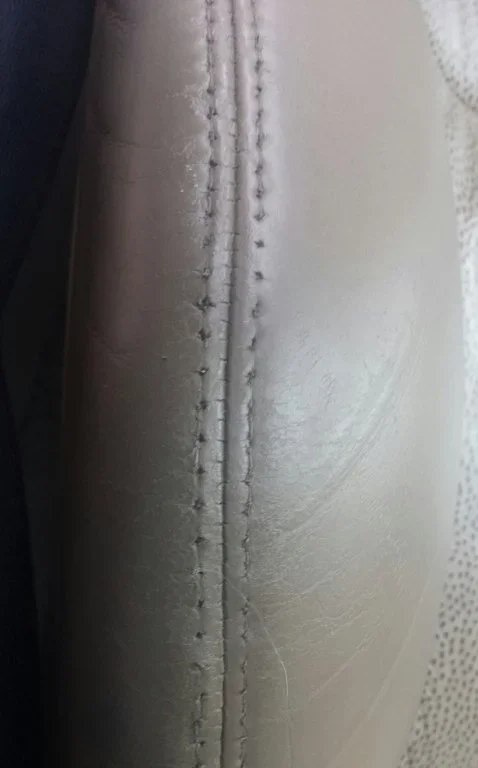

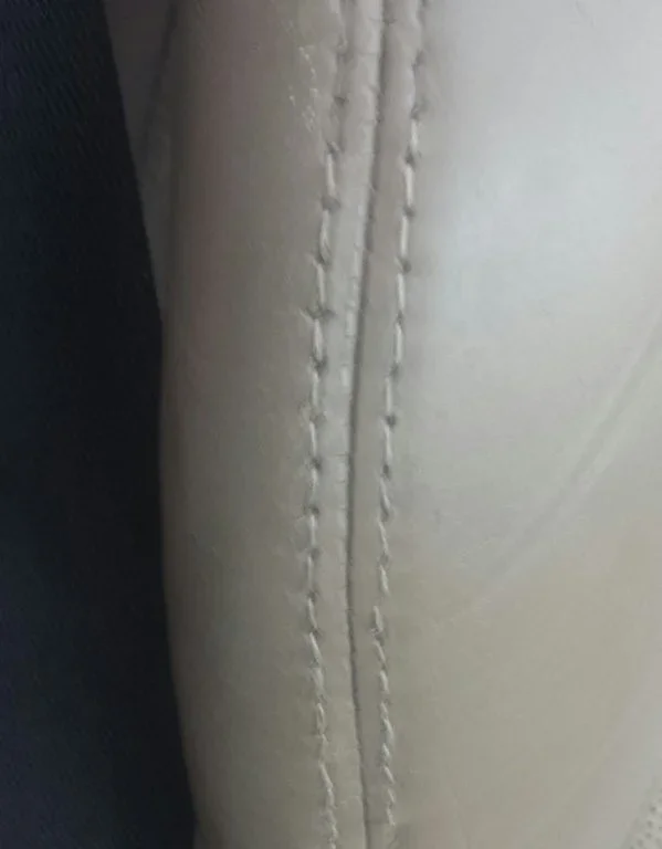

There a few small repairs to do alittle filler but not much as the leather is in good condition. I had some stiching that was gone and decided to see if i could put it back the leather is held together fine its just the stitching thats worn and snapped.
As mentioned youtube showed how so had a crack at it,its not perfect but its better than just holes and when its all dyed down it will blend in.
Seat before...
And after
As said not perfect but better than not there.

That stitching looks very good to me Ant. Nice job mate.
