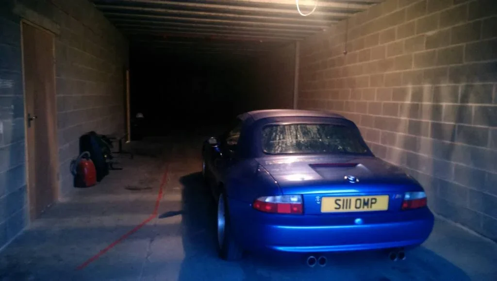

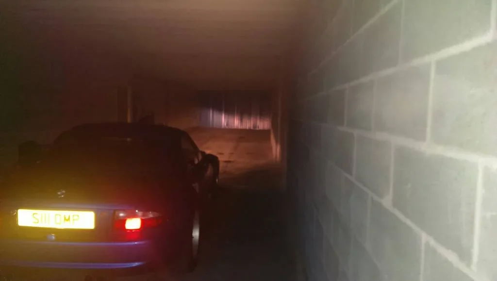

Due the the recent weather and the flooding we had to relocate the M before it hit fully (the guys in the garage next door warned me) .. So after a quick chat with the owner of the unit he agreed to move me..... The new unit is.... 1500 sqf . Lol the pic doesn't do it justice..

It is...
Sent from my HTC One using Tapatalk
It's massive Moz...!
It's that little bloke syndrome mate...
