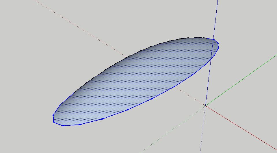

hi freddy, i drew the mirror in google sketchup 3d, i then divided it into about 11 planes which were printed onto card, i cut out the ovals (in the photo above which you are referring too)and glued and stacked them back up, this gave me the shape. i used filler and smoothed it down, the mirror is mirrored perspex (easy to cut and shape.
like this-

next step for me is to make an off centre one like this, this will allow me to shift the mirror upwards, i have ordered another couple of acrilic mirrors slightly smaller than the one in the photo and will make the body from perspex sheet.
