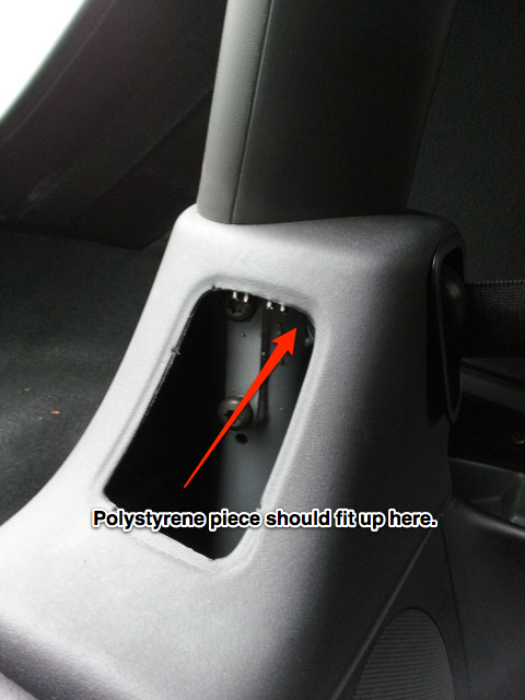

Ok today i looked in the small inspection hatch at the top of the trim at the roll bar
looking in the first thing i see is this just lying there
what is it and more importantly where does it go ?
everything else looks ok
how do you get the trim off to get better access to the belt reel?

You'll need to take the roll hoops out you can see the two fixing screws in your pic and there's another in the cubby hole between the seats. I wouldn't bother taking them off though unless the seatbelt reels are loose. Not sure where that bit goes so can't help on that one.

I have been on the net all last night and this morning and can find nothing about this polystyrene piece
also i cant get my shovel hands in the space to try and find out where it goes
has anybody ever seen this ???

it might not even be off the car, they were built in america in the 90's so it might have just been pushed in there to get rid of it.
failing that, can you see the other half of the sticky pad anywhere or a patch where it might have been

It belongs in the top of the roll hoop trim piece, it wraps around the tube you can see through the inspection hole, nothing to worry about. I guess it is some form of sound deadening as it has no other function.

Cool thanks
will put another sticky pad on it a stick it back up there.... :-bd

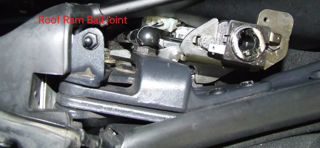

Do you have an electric roof? If so have you checked the balljoint that connects the roof to the ram? This can sometimes be slack and rattle.
