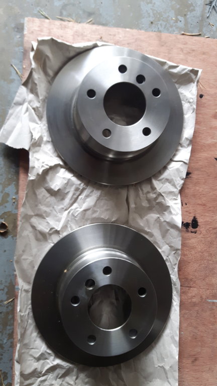

Brake discs are from NK- Automotive, with origins in Sweden, however, I suspect they are actually manufactured in the Far East.

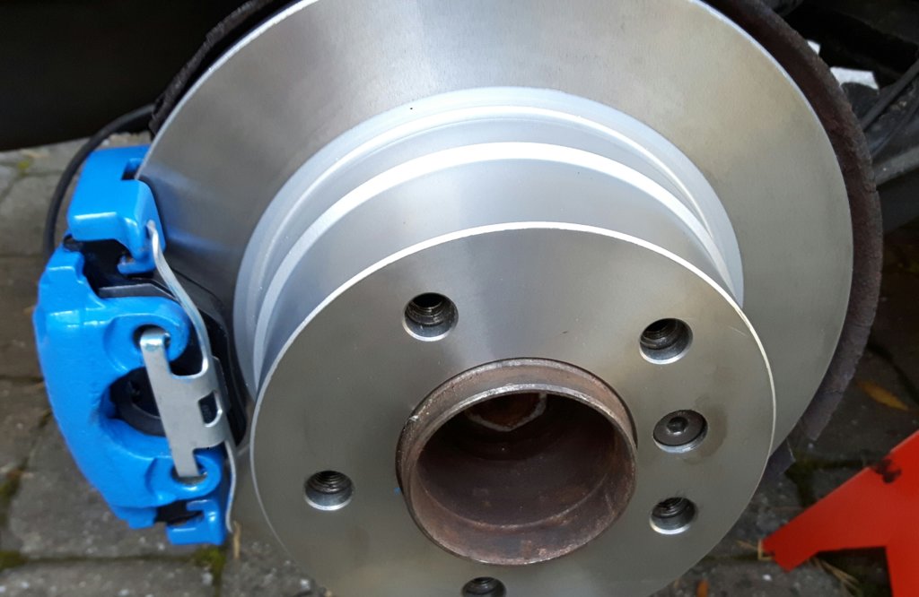

First job was to apply masking and paint the hub area.

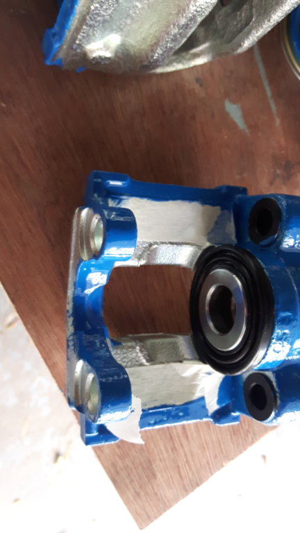

Then got a bit carried away with painting the calipers and only remembered when partially painted.
Was very impressed with the finish out of the box and it does seem that Budweg do a thorough job of refurbishing.

So the finished job:
I followed the guide on Pelican Parts for setting up the handbrake shoe expander and found it was a right fiddle on, however, it did seem to work and setting the balance was easy. There is I bit too much travel on the handbrake lever for my liking and I need to take a bit of the slack out to get it just right.
