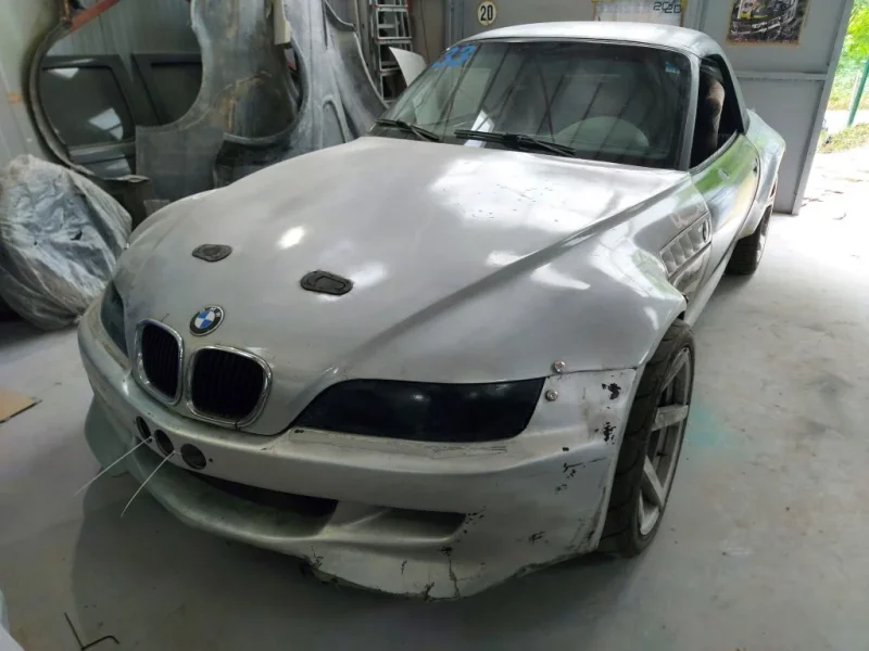

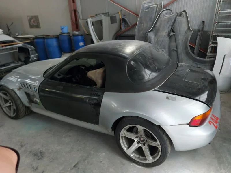

Hi all,
A small update - some fiberglass parts are now ready - doors, rear, "hard"top and headlight deletes ... so slowly this become full race-ready thingy :)

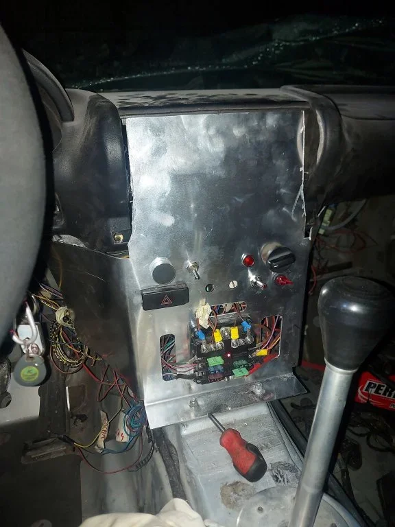

and as I said - I removed completely the wires ... and here is my new fusebox with some switches.... It needs some more attention but will be done soon.
Still have not driven the car on the track :( but should be next week... Also waiting for some full slicks to be shipped.
